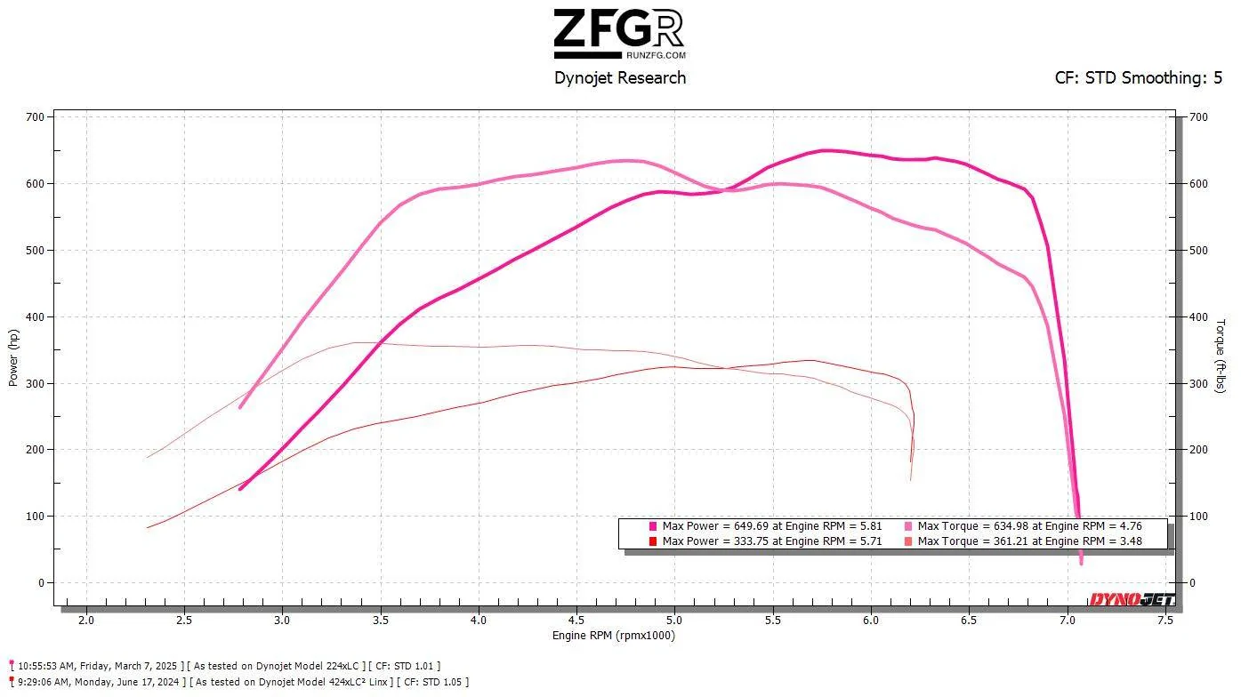

All about the gains! Check these dyno numbers from one of our latest dyno sessions with @crpengineering's Bronco/Ranger Raptor stage 3 Turbo upgrades! Just a touch under 650 RWHP! Not bad at all for as stock frame compressor upgrade only turbo! Really looking forward to the upgraded turbines!
supporting mods:
e85 tune with Nostrum High Performance stage 3 fuel system and other bolt ons including intake, intercooler, down pipes and full exhaust!
Ford Bronco 316 RWHP GAIN! CR Performance Stage 3 Turbos! 649 RWHP Bronco Raptor! crp turbos

Impressive. What is with the big power dip around 5200 rpm? It's significant, ~50 hp.

that was boost control i was able to smooth that out after we got some street data!
