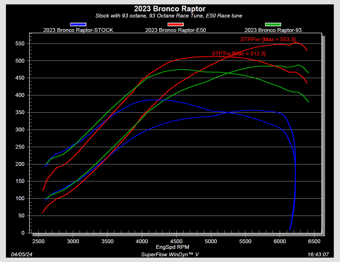

Well dang! In knew the gains where going to be good based on the data I was getting back piror to getting on the dyno but these gains are amazing! +131 whp gained on 93 and mind blowing 197 whp gain on e50 (on @Spooled's Bronco Raptor)!
Ford really did their homework on the bronco raptor turbos and they are a much higher flowing turbo than other 3.0ls out there! Special thanks Eric HP Tuners for working on getting us the right definitions!
Ford Bronco +193 RWHP dyno by 2023 Bronco Raptor w/ ZFG Racing 93 Octane and E50 Custom Tune Screenshot 2024-04-05 201611

Yeah that's insane, good stuff!

If anyone has any questions, this is my Bronco. Ask away. The tune is amazing. Drivability is amazing and the power is smooth and addicting.

Is everyone else missing the fact that this guy has a dyno in his backyard next to his Jetski??!! Siiiick. I want
