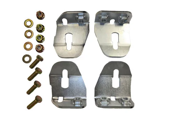

Addictive Desert Designs$159N/S21YesReusedPowdercoat (Hammer Black)
Ford Bronco Frame Horn Reinforcement Aftermarket Options – Master List & Guide co-_-Bronco-Raptor-Frame-Horn-Gusset-Kit_1800x1800

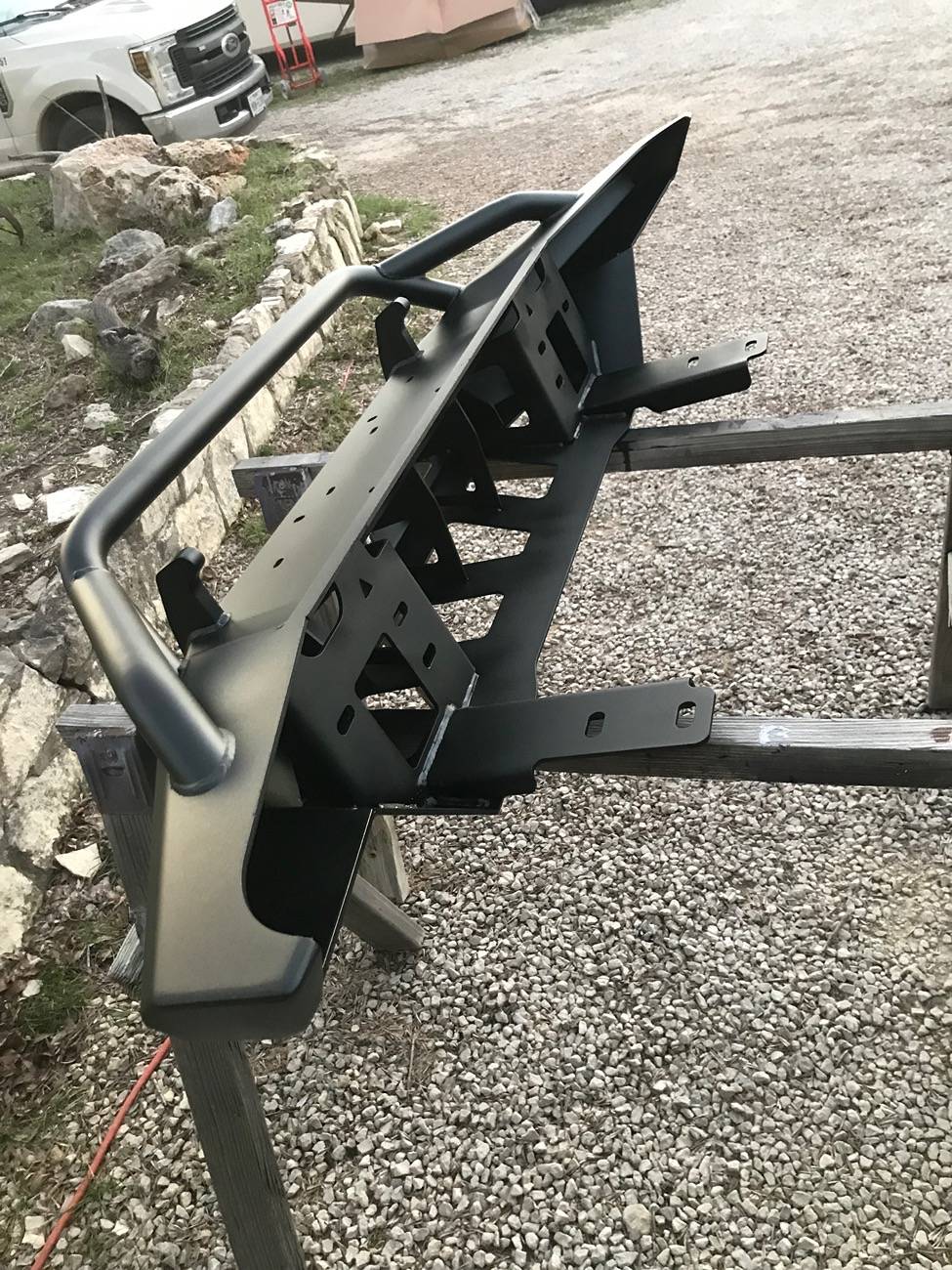

Lobo Offroad$5003/16"22-3Requires Cutting Crash BarReplacedPowdercoat (Fine Textured Black)Eliminates front crash bar/body mount and also reinforces frame horns. Essentially two products in one.
Ford Bronco Frame Horn Reinforcement Aftermarket Options – Master List & Guide F6-17-4510_A-1200w-1

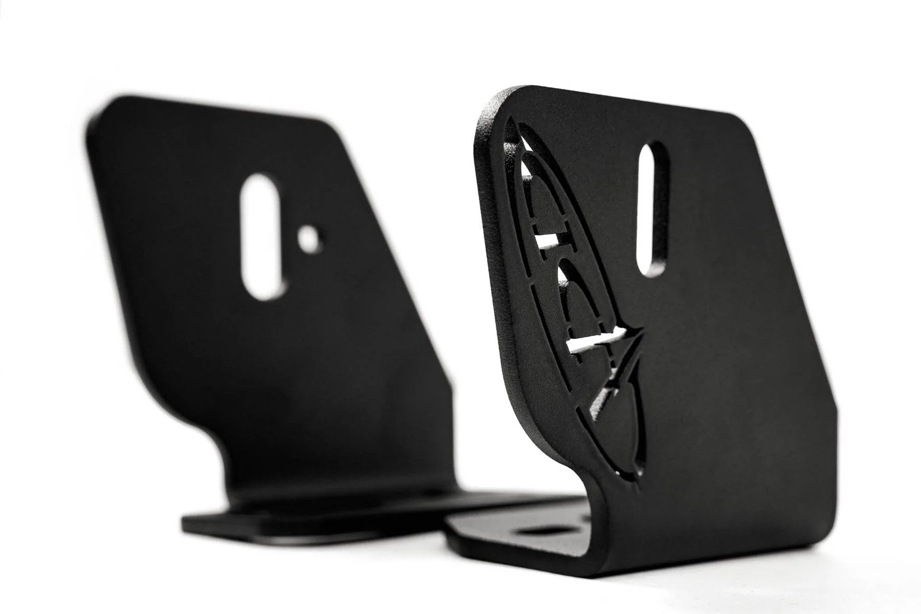

LoD Offroad$89N/S22Requires DrillingReplaced with flange nuts2-stage Powdercoat (Black)
Ford Bronco Frame Horn Reinforcement Aftermarket Options – Master List & Guide 00e380-6da9-11ec-bdab-5dc62f8fd180?optimizer=imag

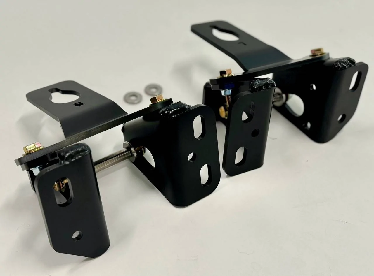

Metal Tech 4x4$2501/4"31YesReused (modified)Raw, ready for paint
3 piece design bolts together, wraps around top of frame. Also uses factory bolt on top of frame
Ford Bronco Frame Horn Reinforcement Aftermarket Options – Master List & Guide IMG_5669__47397.1719532647

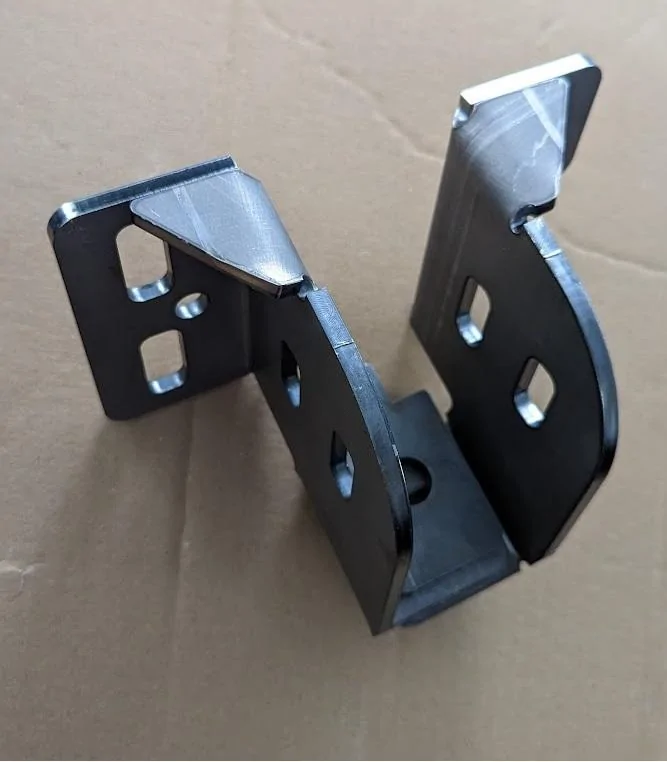

TD Distributing$10,0001/4"22Requires DrillingReplacedRaw, ready for paintNo longer produced, despite being one of the beefiest and well thought out options. Wraps around and overlaps on bottom of frame
Ford Bronco Frame Horn Reinforcement Aftermarket Options – Master List & Guide pxl_20230508_005315173-2-jpg

Great info. I flat tow mine and have a winch so I installed the LOD brackets (because @Tricky Mike ‘s aren’t available) and had to modify something, don’t remember what.
ALSO, I have a Fab Fours bumper that has extra plates underneath that allows 4 extra bolts. So I’m confident the bumper will stay put.
