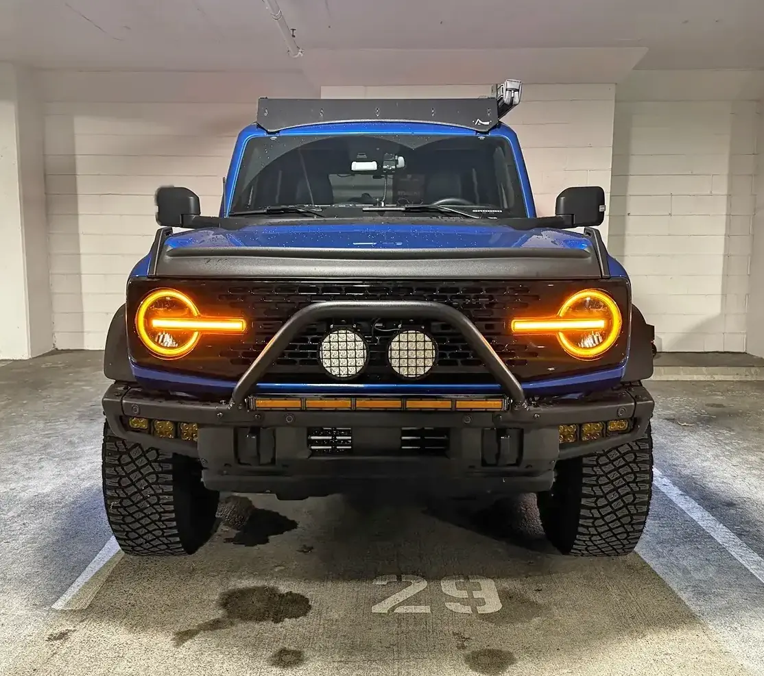

11/21/25 UPDATE/WARNING and Shout to Bigmoose for the notification:
My lights are officially unusable for now after my recent visit to Ford Bronco dealership (Rear Camera Recall fix). Blinkers, DRL and high beam do not work.
Bigmoose Warning:
"I was going to post to warn you not to have the dealer run any headlight config in FDRS or they will break them. The LIN configuration for the BCM is unique for raptor headlights. The only way that i have confirmed to fix them is to run the procedure when plugged into a raptor.
I even tried to trick FDRS by switching my VIN to a raptor and running the procedure with no luck."
11/19/25:
Recently purchased Braptor headlight takeoffs. They installed and fit perfectly (plug and play) on my Wildtrak.
Ford Bronco [WARNING/FINDING] Bronco Raptor Headlight Takeoffs Installed on Wildtrak (Plug-and-Play) 762699-0a8ffb328d7f0d8b55d1513002379d90

Looks great! Where did you find the takeoffs?
Wallyworld Ranger 269
Mar 22, 2023
279
542
NJ
2014 Charger R/T
What year was the donating Braptor?
What year is your Wildtrak?
If I’m not mistaken, there are issues with this swap on certain years.

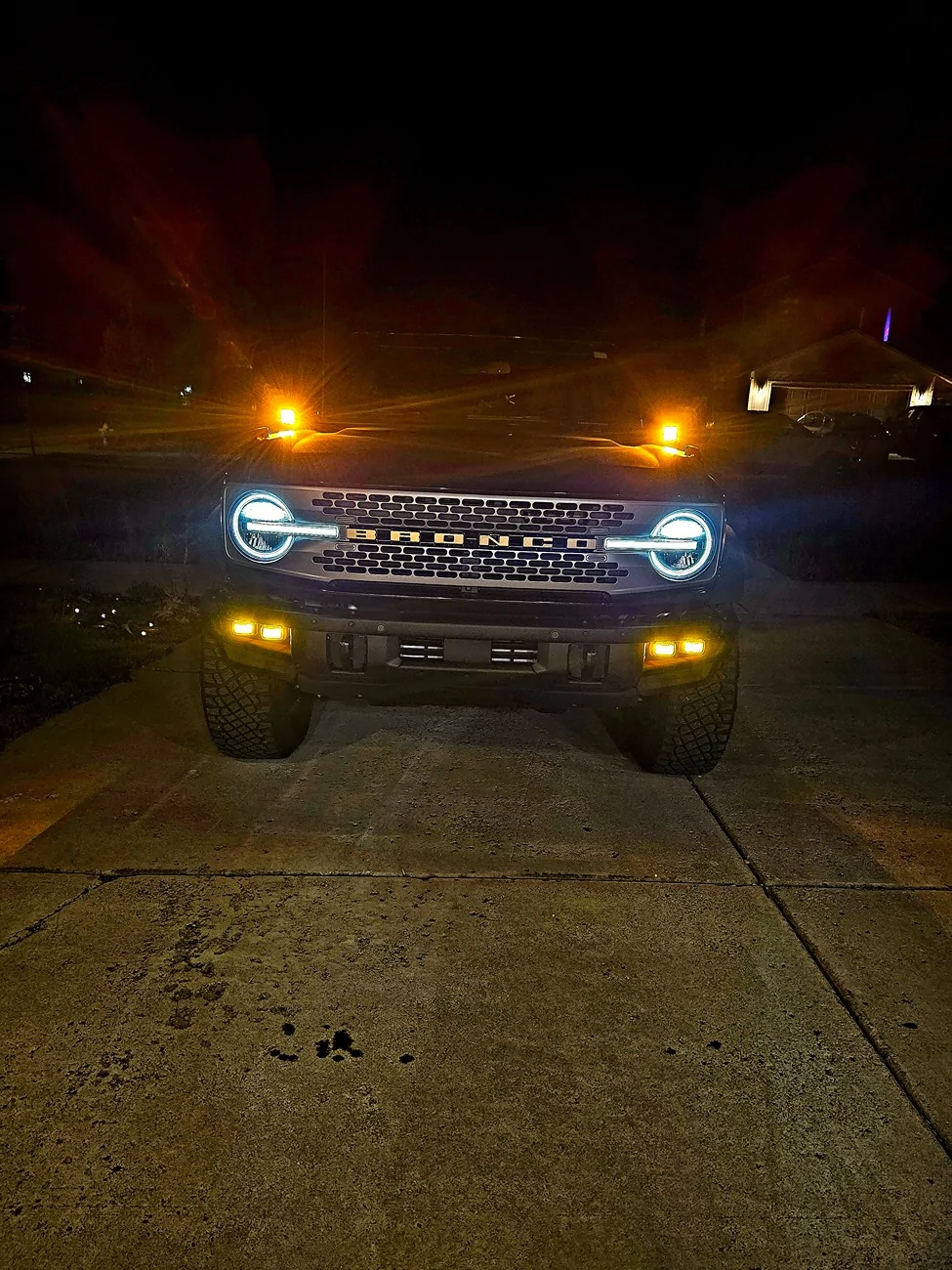

That looks really good!
Ford Bronco [WARNING/FINDING] Bronco Raptor Headlight Takeoffs Installed on Wildtrak (Plug-and-Play) 20251118_181309
I was just thinking last night that the last thing I'm missing is the Raptors headlights. Would really tie the amber lighting together!
I keep checking Marketplace in my area with no luck, so I'm definitely jealous of the deal you got!

I am not sure of the donor (I suspect 2023 or 2024). My wildtrak is MY23
That tracks, though I had read that the 21, 22 and early 23’s had issues with turn signals and high beam function post install.

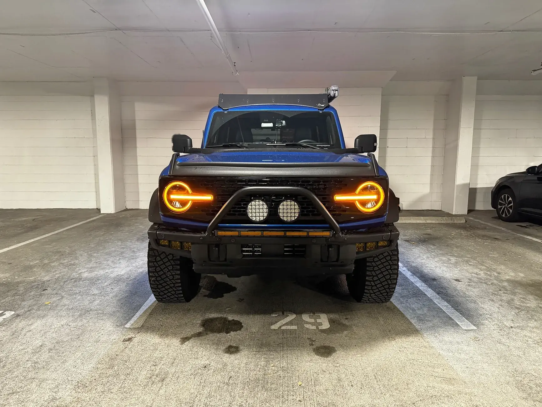

What are the two huge light in front of the grill? Work well?
I bought my vehicle used and tried looking for the brand on those buc-cee-teeth-looking lights (added by previous owner). I rarely use them as they are very bright and throw very far (spotlight).
