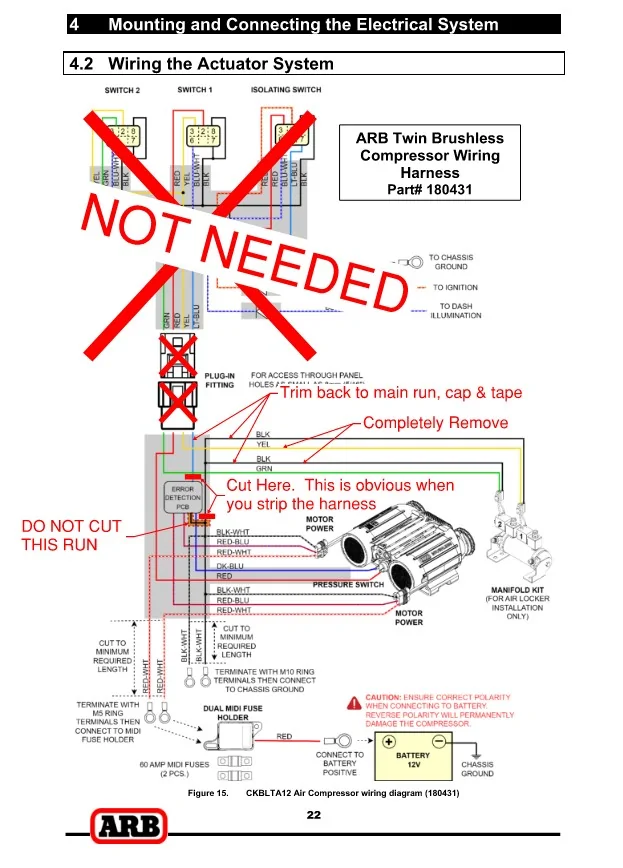

To start with the biggest challenge I had figuring out, wiring.
The kit includes a whole mess of wiring, which is great if you don't have upfitter switches in your rig. I had trouble figuring out exactly how to modify the harness to work with the upfitter setup because there are significant differences between the harness for the brushless vs. the older brushed compressors (there is a TON of info on the brushed compressor install, not so much on the new brushless), but was able to figure it out and it works perfect.
You can ditch the included plug-in fitting and pins, and the secondary harness. You can modify your harness for a clean look the way I did if you want it as OEM looking as possible (which I did).
Wiring diagram (this is snipped from the ARB manual, with my notes)
Ford Bronco How To - ARB Brushless Twin Compressor Install Wiring Harness Main

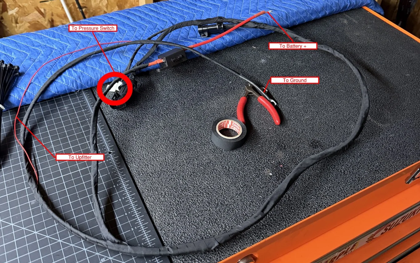

I fully stripped my harness and rewrapped with Tesa tape, after stripping out all the unnecessary stuff. You'll also want to lay this out and trim the ground and positive wires to length before you crimp on your terminals. Do all that and you're left with this:
Ford Bronco How To - ARB Brushless Twin Compressor Install Harness

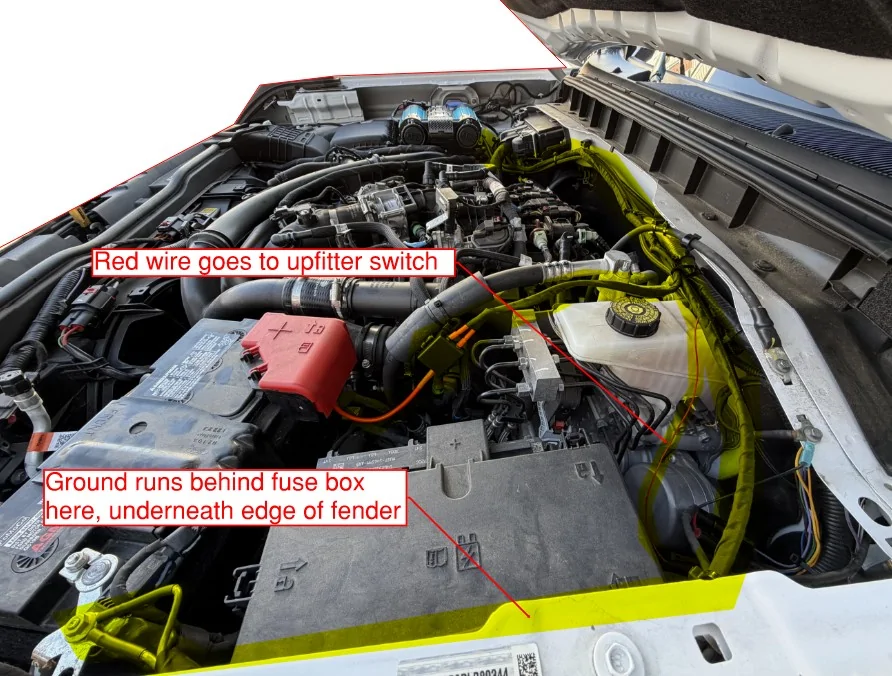

Once your bracket is installed, you can lay the harness in and make all the connections. One note - I installed my compressor 'backwards' from what is shown in the instructions, because it was easier to tuck the harness to the firewall and it keeps the hose connection a little further away from heat. Mount it my way if you want, or the standard way if you like that better; the compressor mounts to the ARB clamp either way.
Big connectors go to the compressor connectors obviously. The two small white connectors go to the pressure switch on the compressor housing. This is a simple closed contact switch, so polarity does not matter. Make sure you install the pressure switch- the compressor will not work without it.

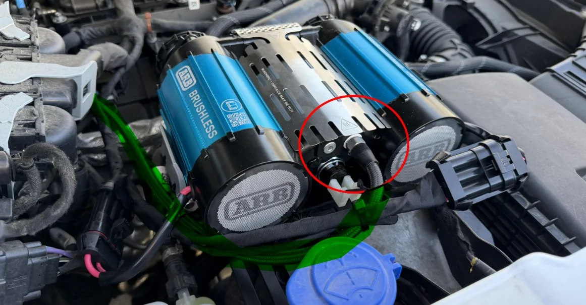

I chose to run the harness from the compressor along the firewall over to the connection points on the driver's side. The loose red wire can be connected to whatever upfitter switch you want to use; this is a trigger wire only, so any of the switches can provide enough current no problem. I chose upfitter 6.
Ford Bronco How To - ARB Brushless Twin Compressor Install wiring 1
Clean your grounds up better than I did.

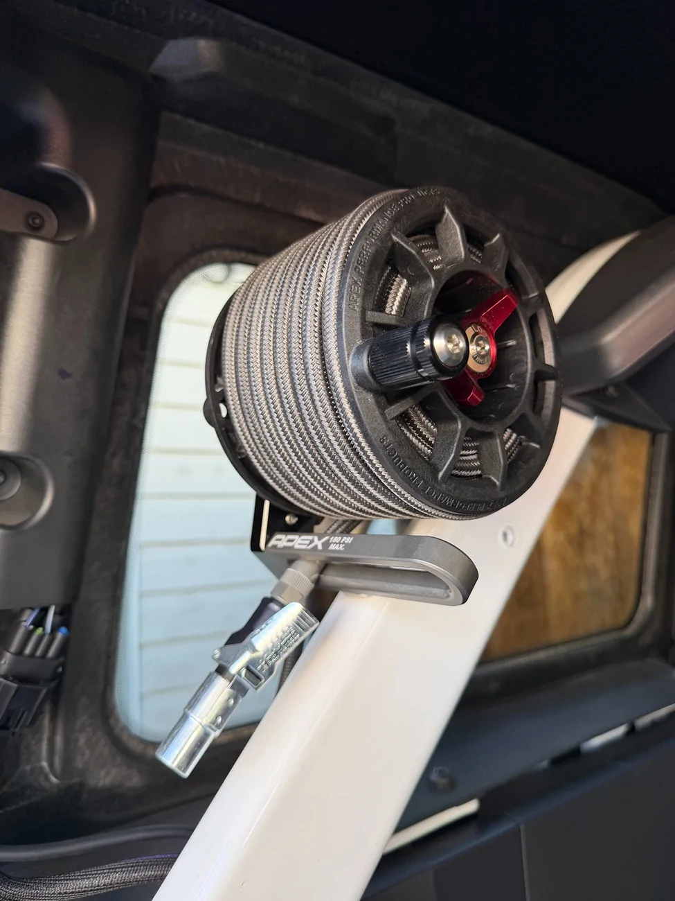

Install the Fast Intentions bracket on the driver's side roll bar. There are rivnuts in this location, it is extremely easy. Install the Apex Designs CRS onto the bracket. Again, extremely easy. Install your fitting of choice onto the 1/4" NPT fitting on the end of the CRS hose. I'm using a lock-n-flate chuck for now, as Apex's very slick push-on chuck was out of stock when I ordered my setup. I'll upgrade eventually.
Ford Bronco How To - ARB Brushless Twin Compressor Install IMG_8145
You'll want to use the banjo fitting to connect the hose to the CRS, but don't do this yet- it is much easier to pull the hose without it connected to anything, and it's also much easier to pull from the rear toward the front than going the other way.

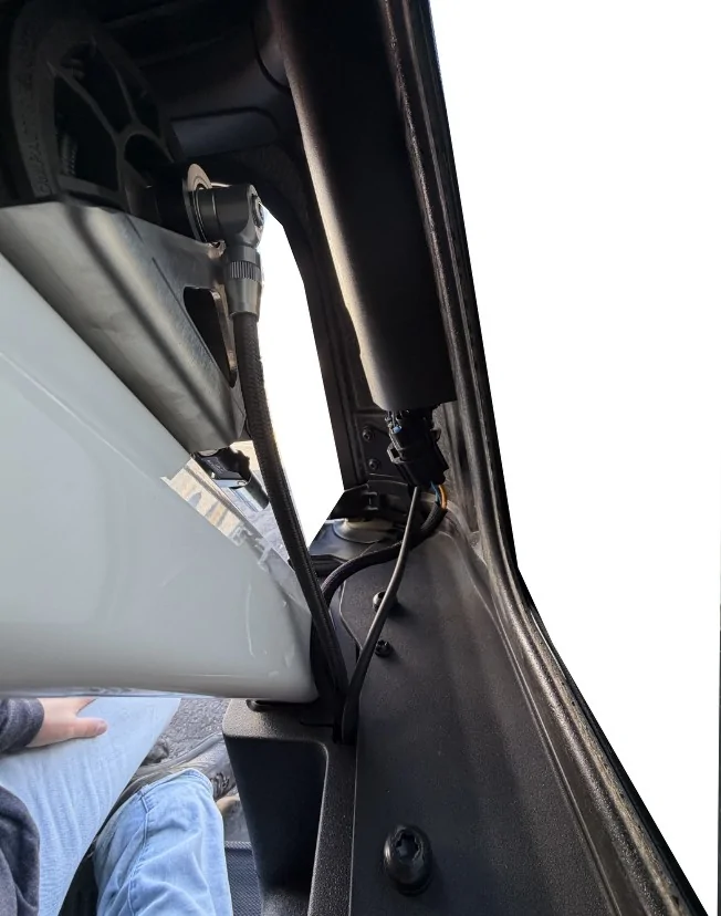

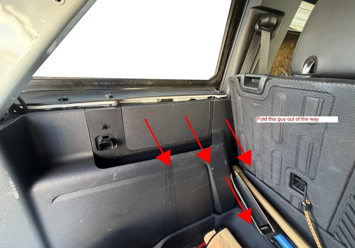

Starting from the rear, pop out the small rectangular filler panel from the cargo area trim. Tilt the driver's side back seat all the way forward, and pop off the front half of the cargo area side panel. You do not need to completely remove the panel to run the hose.
Ford Bronco How To - ARB Brushless Twin Compressor Install hose rear

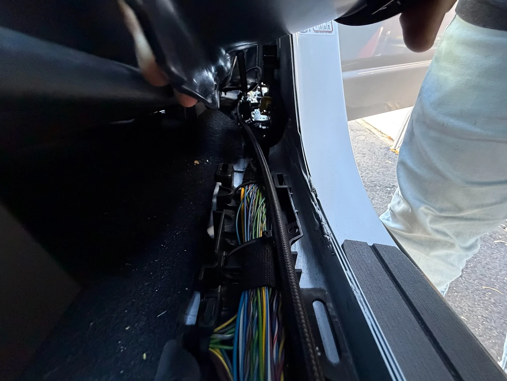

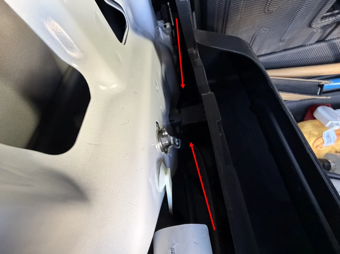

Pop off the driver's side rear door sill trim by pulling the center section straight up. The rear jamb trim comes off by pulling it toward the front of the Bronco. I didn't take pictures of this part. I may add later (sorry).
Run the hose behind the cargo area trim and toward the driver's side rear door jamb.
Ford Bronco How To - ARB Brushless Twin Compressor Install hose 2

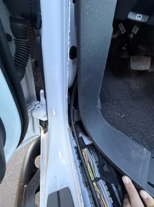

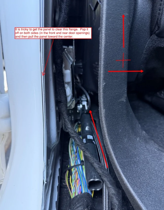

With the rear door sill trim out, you will see the wiring harness running through the sill. There is enough space in this channel to tuck the hose in neatly without preventing the trim from going back on.
Next pull the B-pillar trim by pulling it toward the middle of the Bronco and slightly up, so you can see the channel running along the sill at the base of the B-pillar. This piece is a little finicky to get loose. If you have trouble, push the edges of the trim off of the B pillar flange before you pull the panel loose. Take your time and it will come off. Pop the driver door sill trim out by pulling straight up to expose the channel. With the B pillar loose (you do not need to fully remove it) run the hose through the channel.

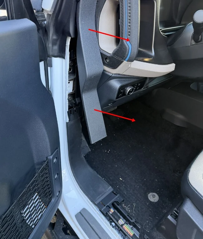

Pop the middle a pillar trim out so you can pull the lower trim. This also does not need to come all the way out, but it needs to be loose so the lower trim can move.
Ford Bronco How To - ARB Brushless Twin Compressor Install hose 5
Pop the lower trim loose and pull it towards the trans tunnel. Just having it loose is enough. Run the hose underneath, and then up over the top of the speaker. It's hard to get pictures of this area, but it will make sense when you have it apart.

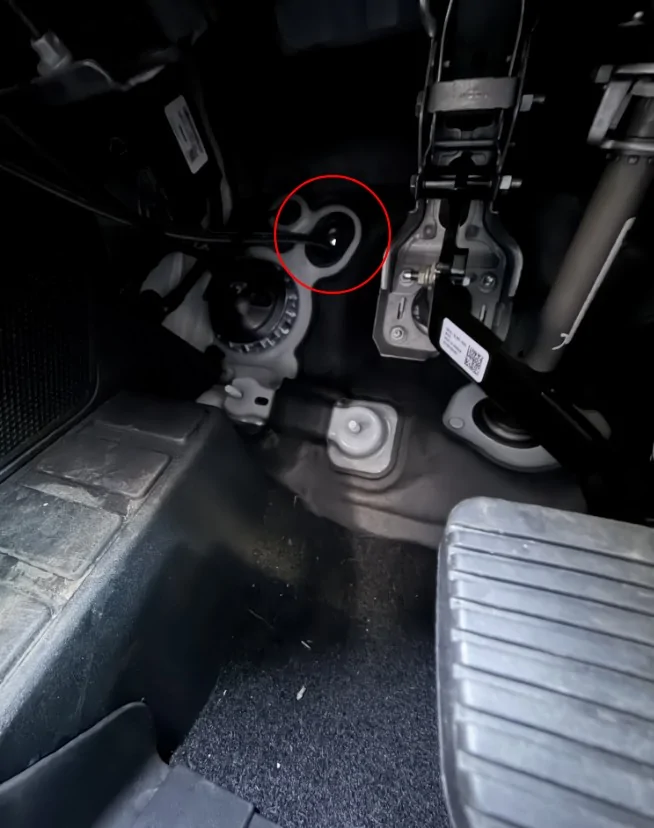

Once you have the hose in this area, you will want to pull the existing grommet from the firewall and cut a hole through it for the hose. It's tucked up behind the dash, and can be accessed through the footwell or from under the hood. it's just under the upfitter wire bundle on the other side. pull the hose through.
Ford Bronco How To - ARB Brushless Twin Compressor Install hose 7

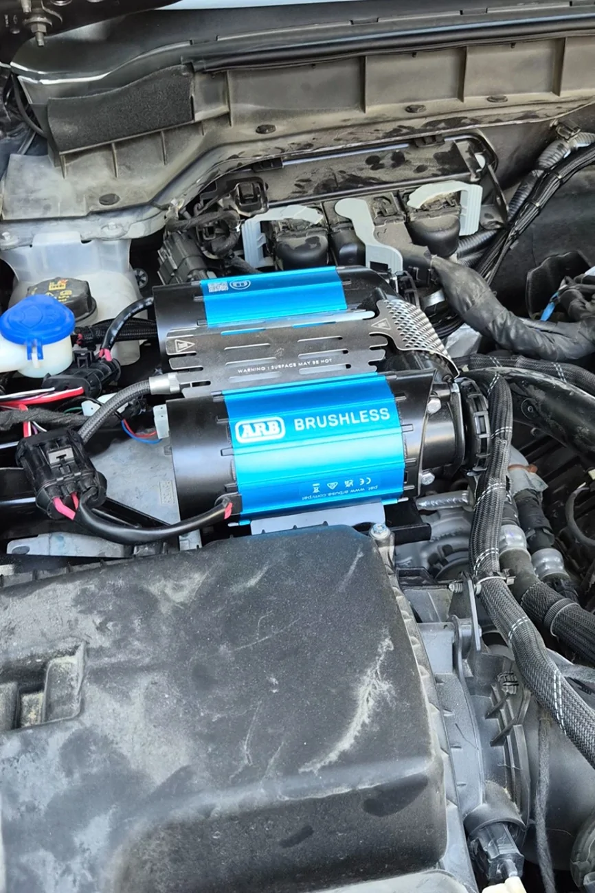

Once you have the hose in the engine bay, you can make the connection to the CRS using the Apex banjo fitting. Dress the hose into the existing opening (for the rear window washer fluid hose & harness) in the rear cargo trim panel, and you can snap the panel back into place.
Ford Bronco How To - ARB Brushless Twin Compressor Install hose 8
Once this connection is made up, you can pull all the excess length out of the hose, deal with any twisting along the run, and pull all the excess through the firewall grommet into the engine bay. At this point you can re-install all the trim and you're done inside.

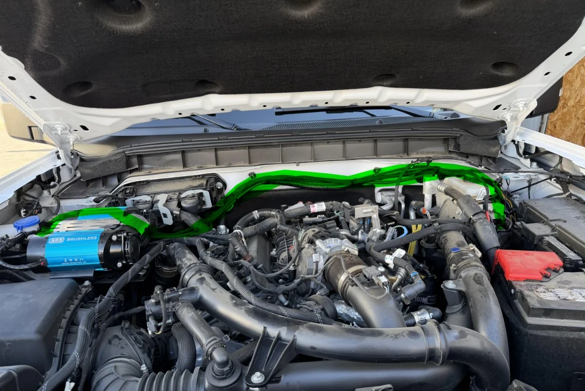

In the engine bay, dress the hose along the same path you took with the harness, and over to the compressor. Trim to length and install the Apex fitting (or whatever fitting you are using) into the compressor housing.
Ford Bronco How To - ARB Brushless Twin Compressor Install hose 9
Ford Bronco How To - ARB Brushless Twin Compressor Install comp 1

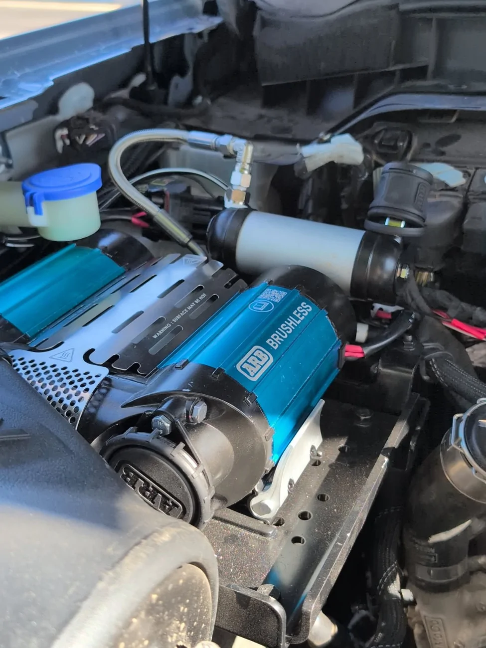

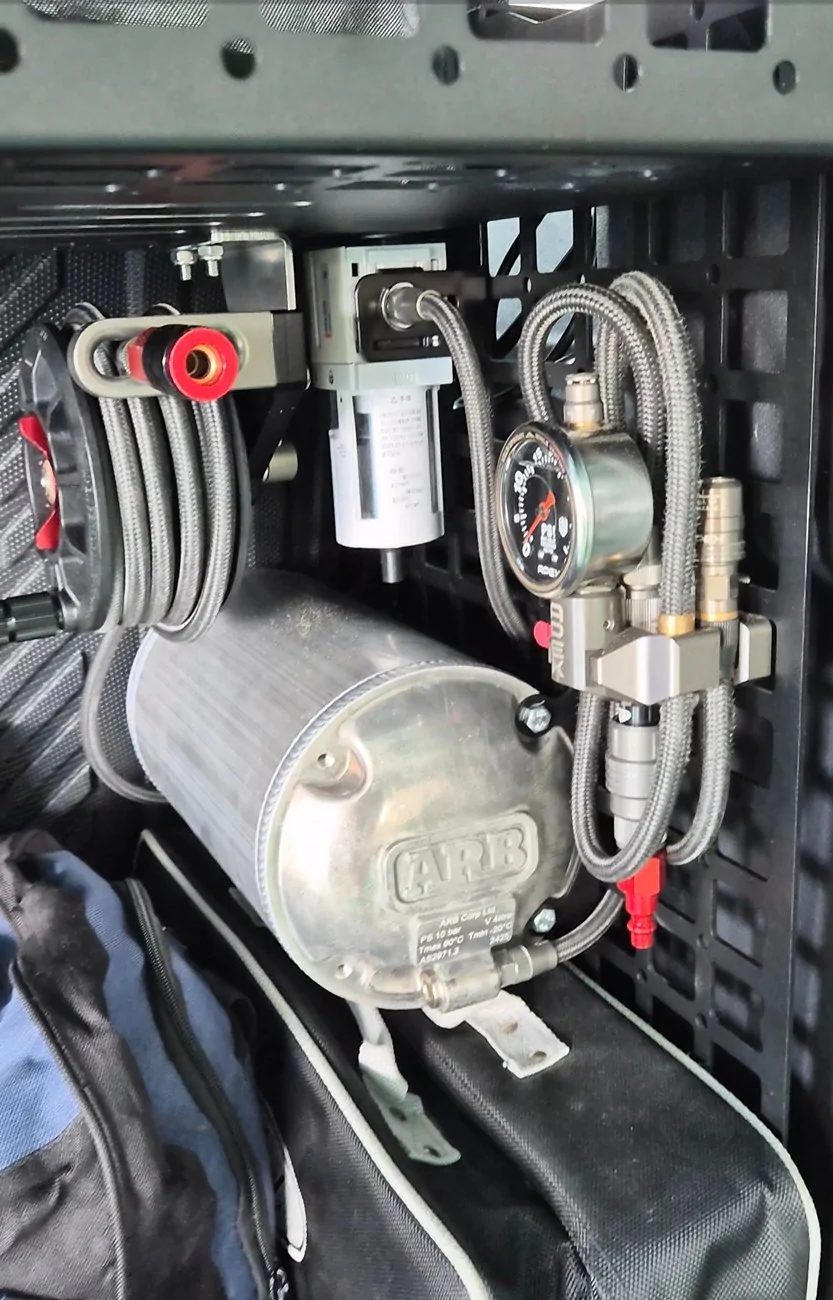

I have a very similar setup to you :thumbsup:
I used an apex hose from the engine bay to the trunk but unfortunately it's not as straightforward to mount the apex crs on the rollbar as I have the 2door.
I ended up mounting it under my cargo shelf and molle with an air tank :)
Cool setup. Since you went with the tank, and you've got QD on your hose.. have you tried running air tools with it yet?
It moves so much air I'm curious if it will run an air impact without the tank.

Thats the plan but Haven't tested it yet. I believe it depends on the tool but my friend has the normal arb twin with a tank and runs a stubby impact, he just waits a couple of seconds for the tank to charge between uses. I think it would be similar but a significantly shorter wait between uses which makes it more practical
