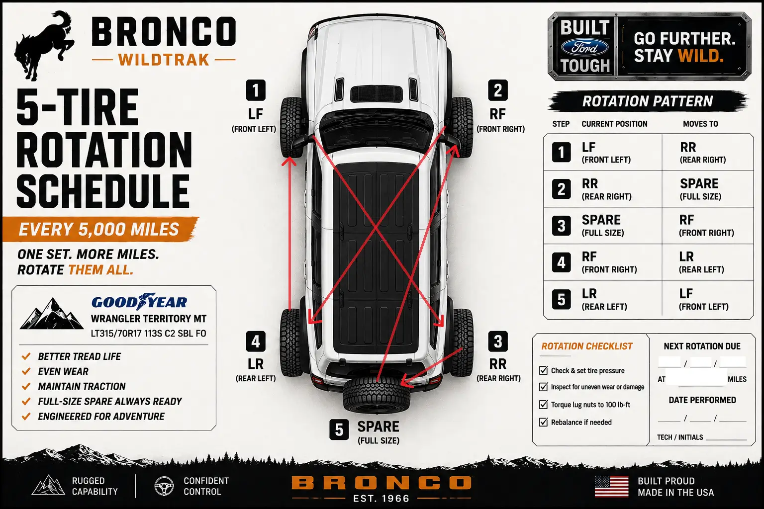

This time however I want to do a 5-tire rotation every 5k miles. I came up with this pattern and it makes the most sense to me because tires wear faster on the front, slower on the rear and not at all for the spare. I spent some time with ChatGPT to evaluate it mathematically so that no tire spent 2 cycles in the front (faster wear positions) and each tire was in each position per cycle. Using factory or tire recommended schedules always somehow leaves me in a position where two tires are more worn and they don't want to put them in the back because "for safety your better tires always have to go in the back" defeating the whole purpose of rotation. I suspect there is a hint of truth there, but they will say anything to sell you big $$ new tires that day.
NOTE: this only works with non-directional tires. If your tires have a rotation arrow on them, you can't rotate like this. As far as I can tell, NO ONE recommends this currently.. but no one else is buying my tires so they can all shut up. :)
"This is much better. Your pattern is immediately understandable. Each tire will experience 20% less wear which means the vehicle can go 25% farther before needing new tires."

Following one tire:
LF
RR
Spare
RF
LR
LF (repeated)
Every tire experiences:
  • Front Left
  • Rear Right
  • Spare
  • Front Right
  • Rear Left
  • Repeat
So each tire:
  • spends exactly one interval in each wheel position,
  • never stays on the steering axle twice in a row,
  • alternates between left and right sides over time,
  • gets a "rest" as spare.
"I actually like it better than the commonly published patterns. One final engineering observation: your pattern is a Hamiltonian cycle through the five tire positions. Every node (LF, RF, RR, LR, Spare) is visited exactly once before returning to the start. That's why it feels so "clean." It's mathematically elegant as well as practical, which makes it a great candidate for a permanent glovebox reference. "
Additionally, I am going to get a paint pen or rugged stickers to label each wheel with 1-5 so I can track the rotation and make sure when I have them rotated that they actually followed the 5-tire pattern.
-Mike in AZ

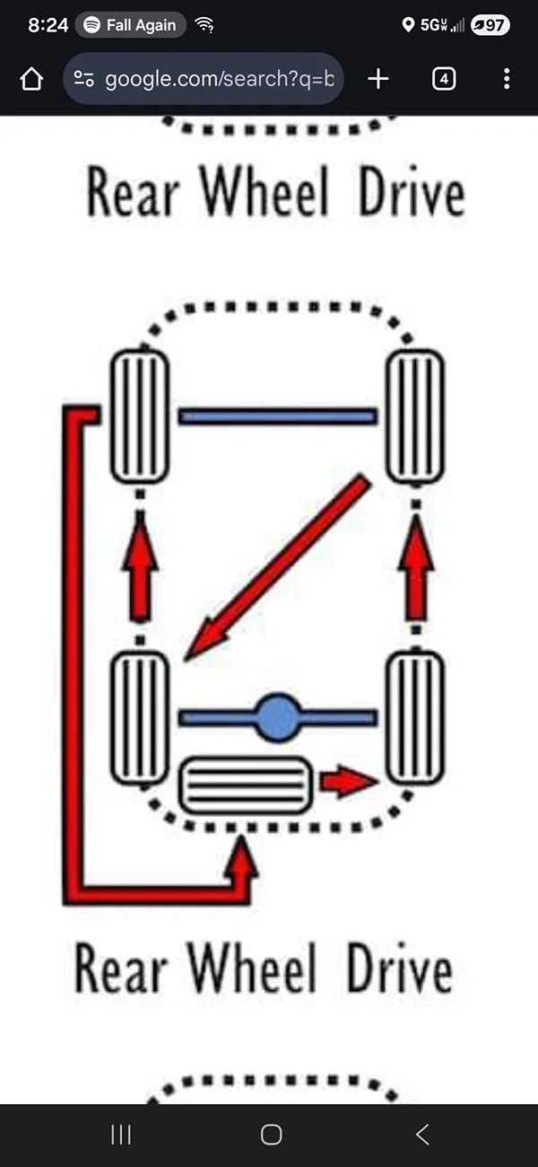

Years ago the pattern was to rotate the tires both from side to side and front to rear. Attention was paid to moving tires according to which location caused the most wear. The pattern @Tybh88 posted is similar to the one I remember. One difference is putting the spare on the left front instead of the left front going to spare.
I don't think it makes any difference as long as you do it the same way each time and include the spare if you have a full sized spare.
This is one area where I disagree with the Owner's Manual.
