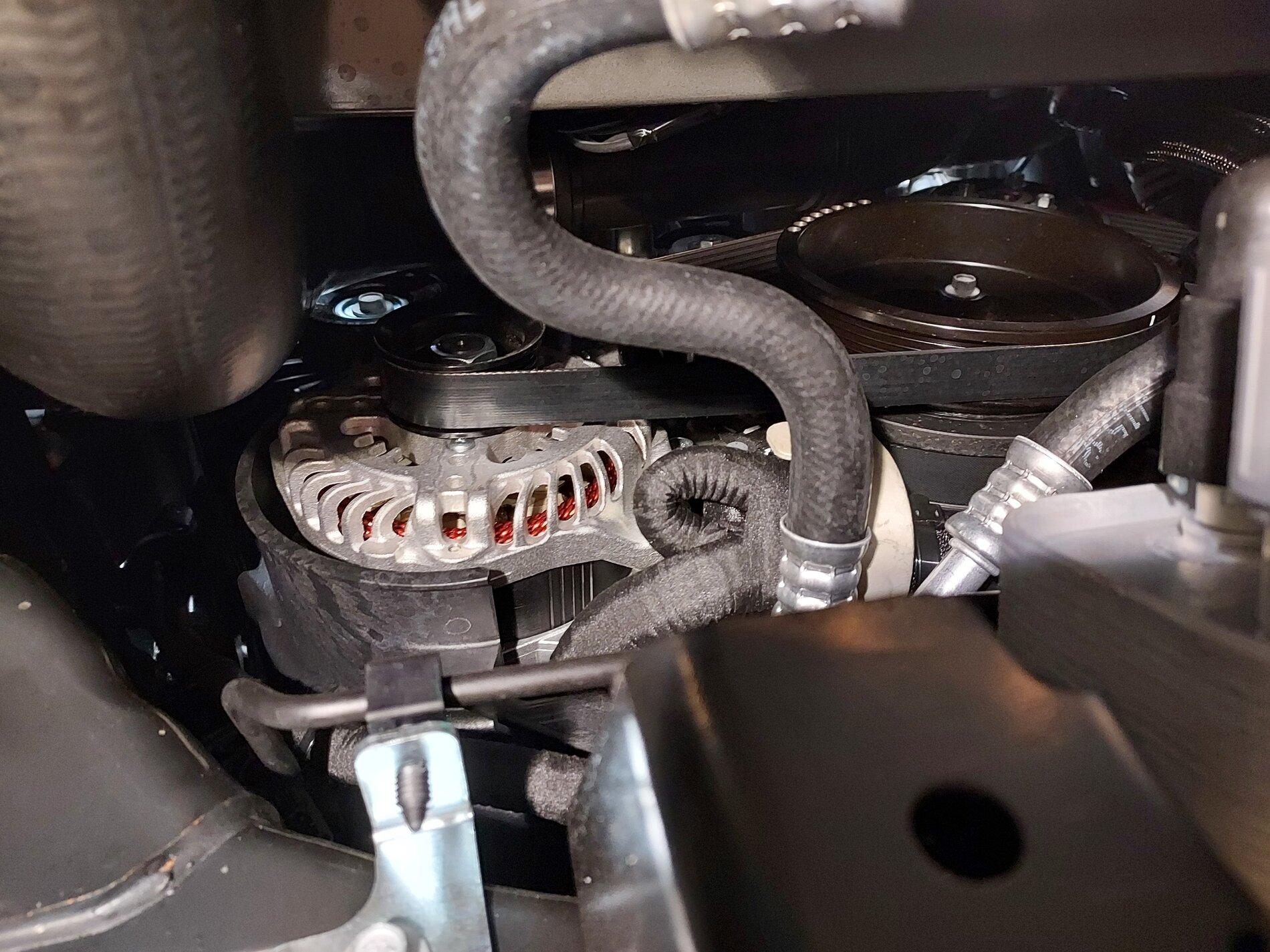

Just an FYI for those planning to carry extra drive belts for off-roading trips. The 2.7 engine has two drive belts, 1 for all of the engine driven accessories except for the alternator, the alternator is driven by it's own belt.
Ford Bronco 2.7 Engine Alternator Drive belt 1637630986509

I'm glad the grab handles are on the front of the hood.
That way the mechanic we carry with us can hang on.
Are you laying undernerath to take the picture?

Yes, took the front bash plate off, starting to look at what's required to custom build a winch mount as I haven't seen an aftermarket winch mount or bumper yet that I will spend the money on.

looks like a stretch belt. Bring an installation tool and a crank pulley socket and a long 1/2 ratchet. And a bigger toolbox for the truck.
