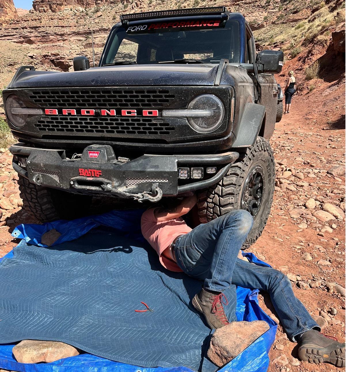

Damage report broken tie rod trail repair finished the trail, scratched the same area of damage from a year ago drivers side fender and door.

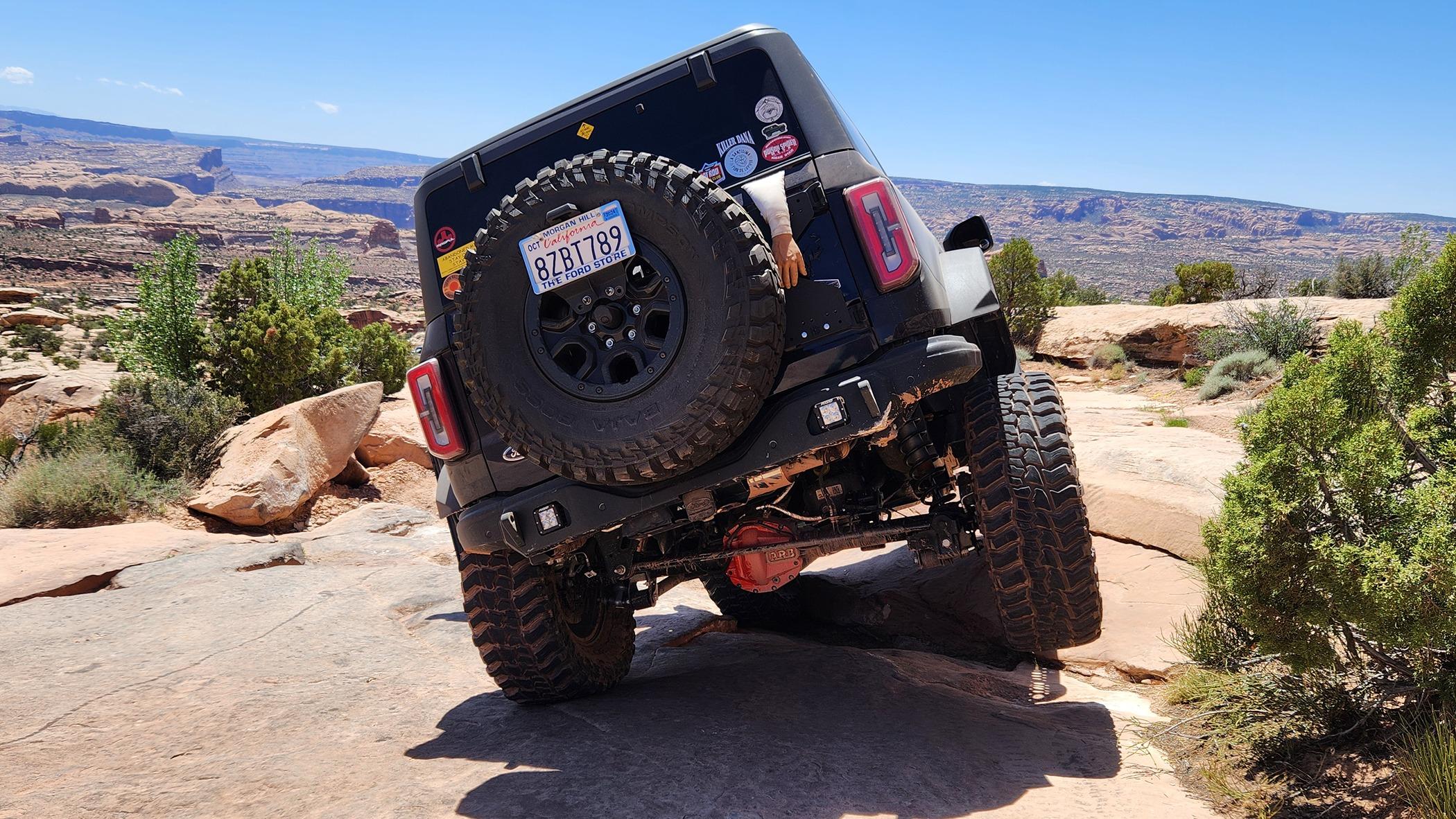

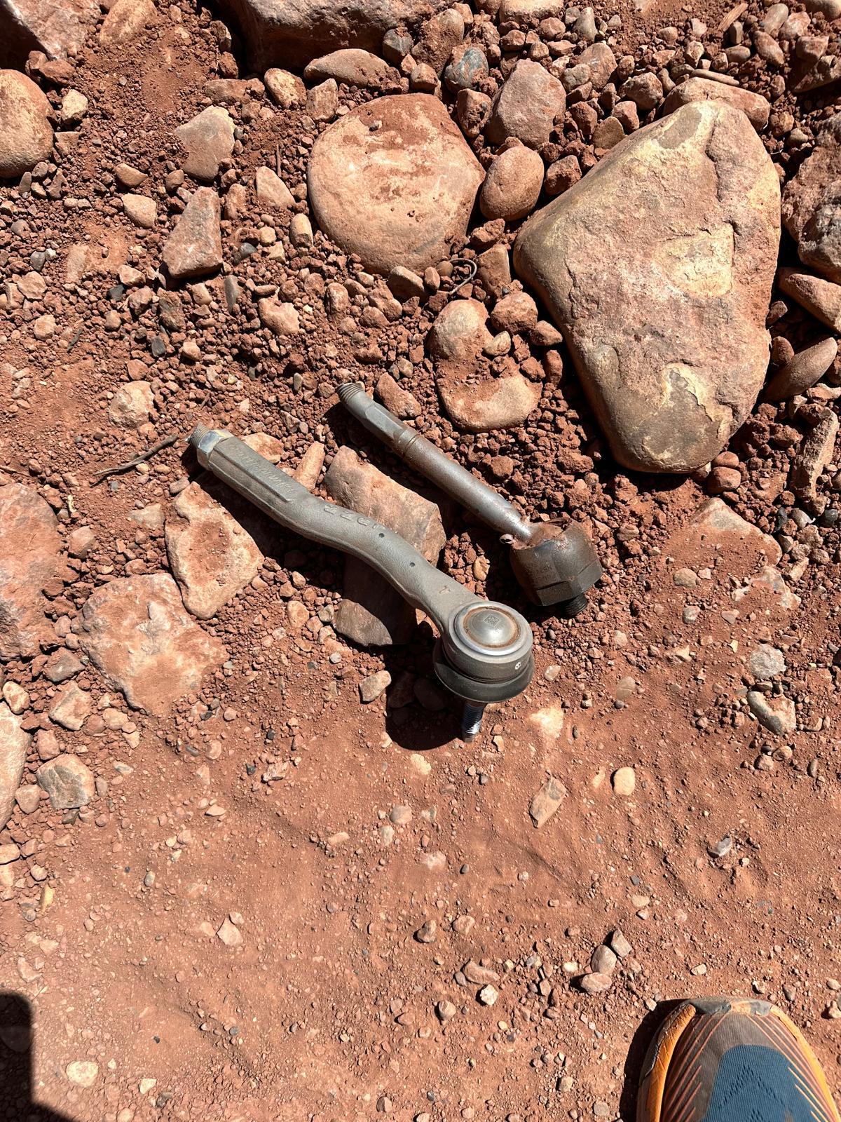

On the broken tie rod, it doesn't look like you bounced, overextended or bound up right at the part. On the video where you hit the side, it does look like your wheels got squeezed in around when you hit. (We can see the passenger side wheel, I wonder if the tie rod shows stress?)
I'm wondering if you might've damaged the tie rods at that point, then later a little (smaller) amount of pressure completed the break? I don't see why it would snap right there, except the wheel is turned out a little.

In two and a half years I have run the stock 2.0 steering rack, went Moab four times on the Rubicon three time and lots of other trails in the Sierras. I have always tried not to let the front bounce and drive it easy. This was the first week in Moab with the 3.0 rack, but after four days off hard wheeling broke a tie rod till on Cliff Hanger. I made multiple attempts at the obstacle where the rod broke it was a bitch of big rocks. It could have been a combination of all the wheeling adding up. Have not really inspected the tie rod yet to check for stress.

Oh, so you broke the thicker FP tie rod? I missed that detail. Very interesting. I'd heard they have broken but I think this is the first video I've seen. I do wonder what the other looks like.

It looks like you came down on the tie rod the attempt before it broke - or at least stressed it.
Yes that is very true I had made obstacle attempts slamming down on the rocks before the front wheels made it to the top then the tie rod snapped.
