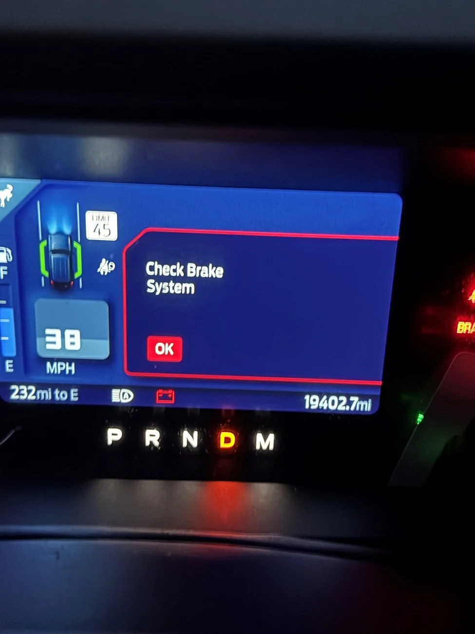

I have a 2024 Bronco Badlands 2.7L with under 20k miles.
These two errors popped up on my dash yesterday.
Every dealership I speak to around me is 2 weeks - 2 months out unfortunately.
Anyone else ever run into these issues? What was the fix?
Ford Bronco 2024 Bronco Badlands - "Check Brake System" & "Charging System Service Now" errors error

Many have had their OEM battery replaced under warranty. Check your battery voltage with the truck off...should be a minimum 12.5. A weak battery can throw all sorts of codes.

The Check Brake System or Park Brake Fault messages can be red herrings for a battery or alternator issue.

First move IMO, get the battery tested. If you don't have a tester most auto parts stores can test it for you.

I had this. Put a charger on the battery for an afternoon. Codes went away and never came back.
