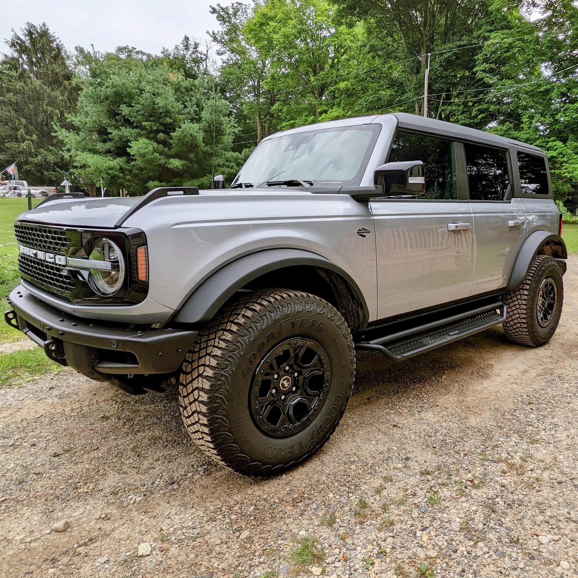

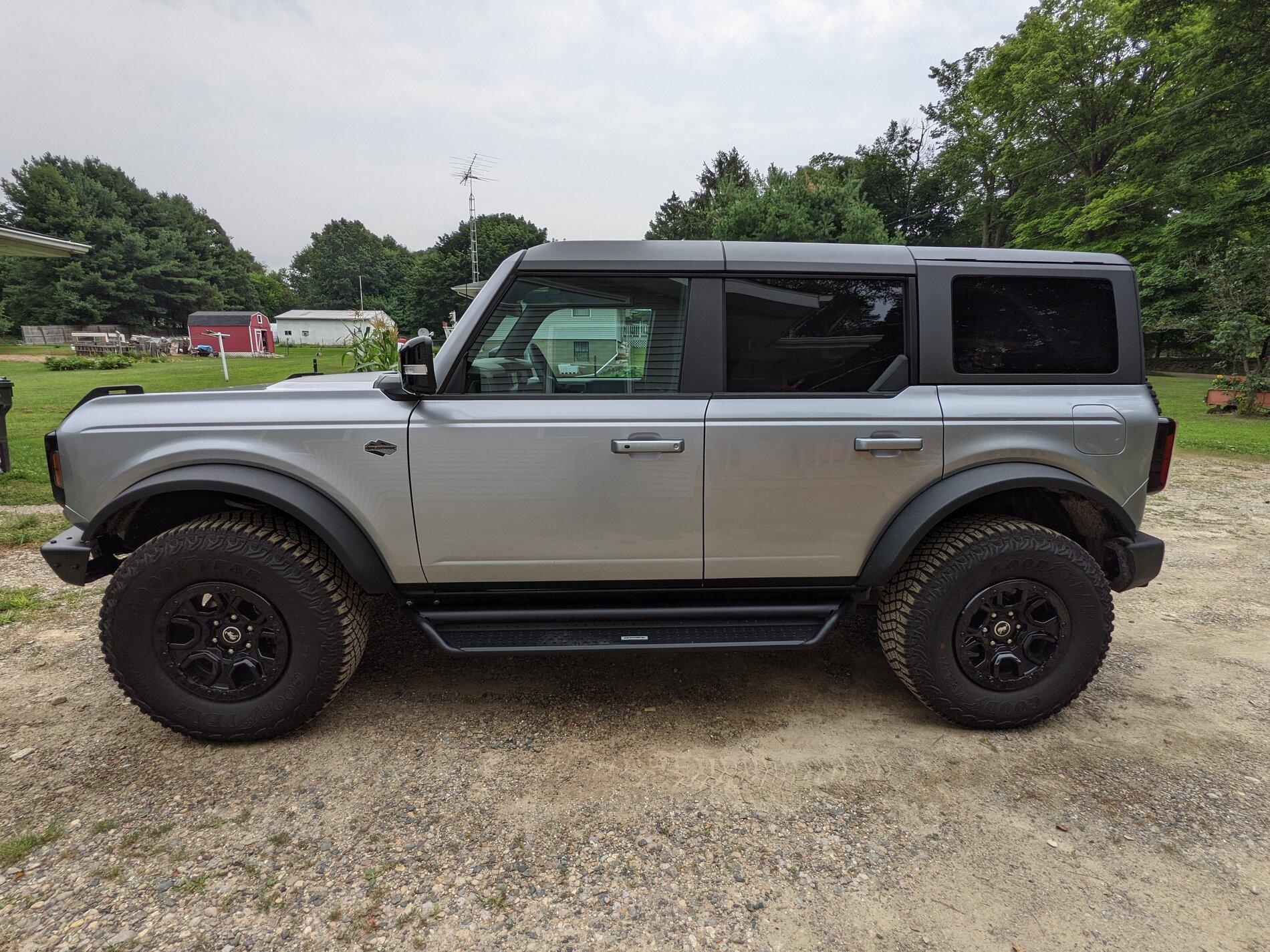

I was encouraged to share some photos of the Go Rhino Dominator Extreme D1 steps I recently installed on my 4dr Wildtrak.
Ford Bronco Go Rhino Dominator Extreme D1 Sidesteps Installed on 4-Door Wildtrak IMG_20210809_231046_924~2
Initial thoughts are mostly good. I do have some critical feedback though.

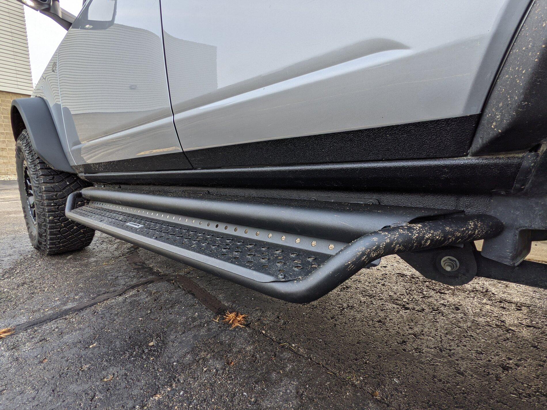

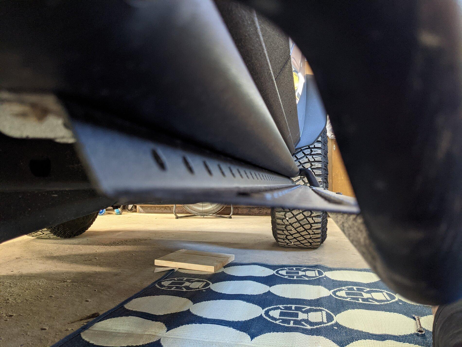

I also think the design of the mounting brackets need to be tweaked just a hair. The steps are sloped down and away from the body. They function fine enough but they look saggy and in winter weather I'm afraid they might be a liability.
Ford Bronco Go Rhino Dominator Extreme D1 Sidesteps Installed on 4-Door Wildtrak PXL_20210815_191657315
It should be an easy fix for the manufacturer, just add 4-5 degrees to the top mounting surface to correct for the "sag". The DIY fix will involve some sort of shims between the body and brackets. Probably an 1/8" will do, maybe 3/16".

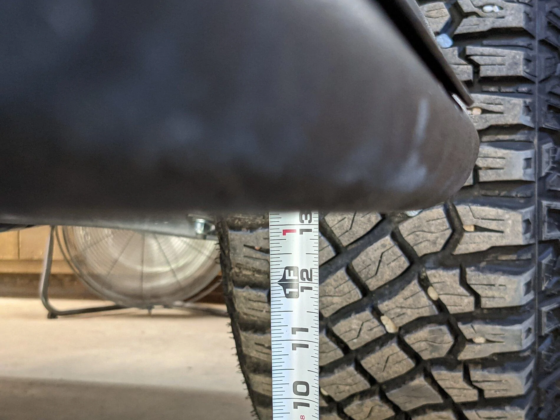

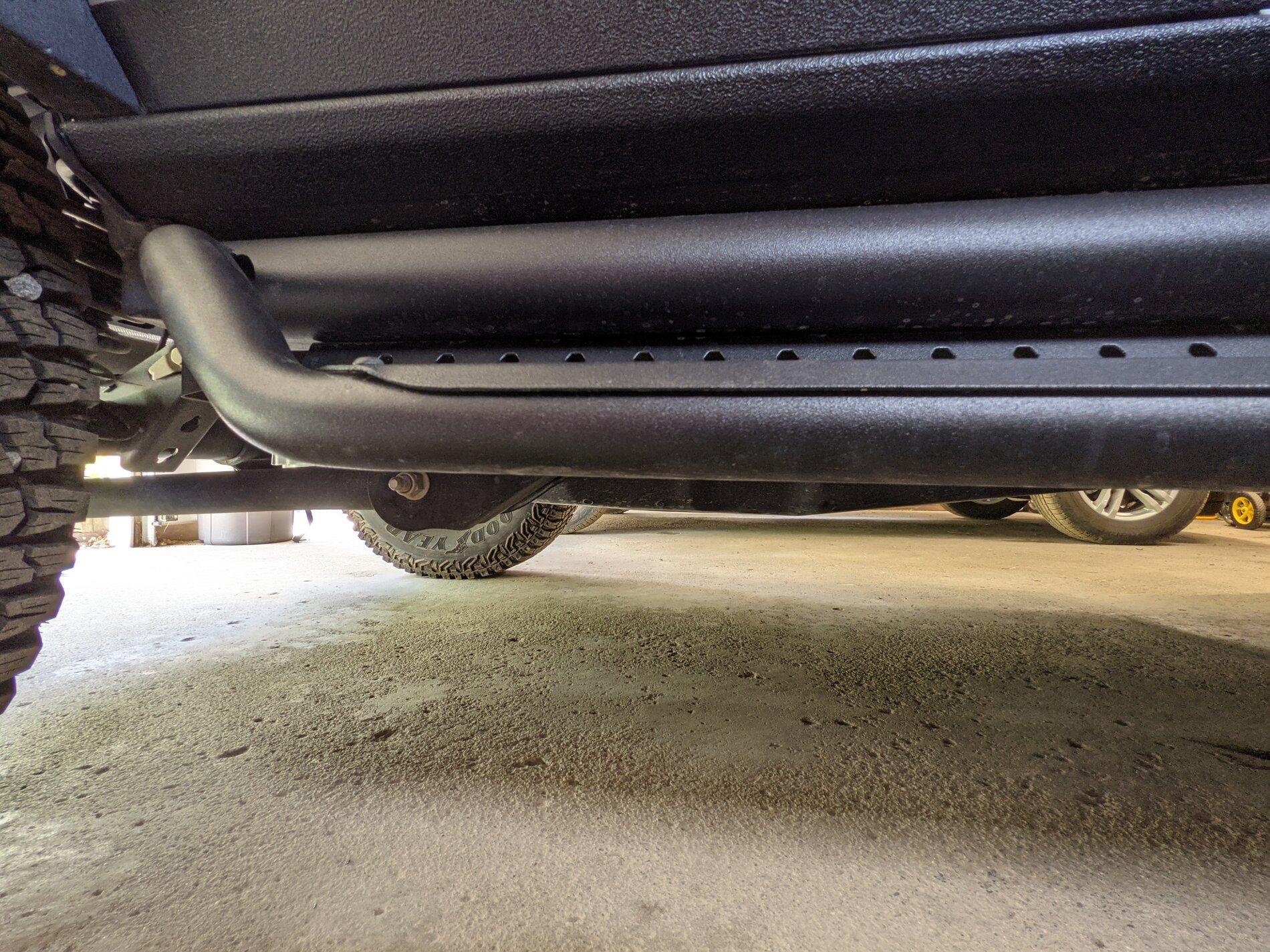

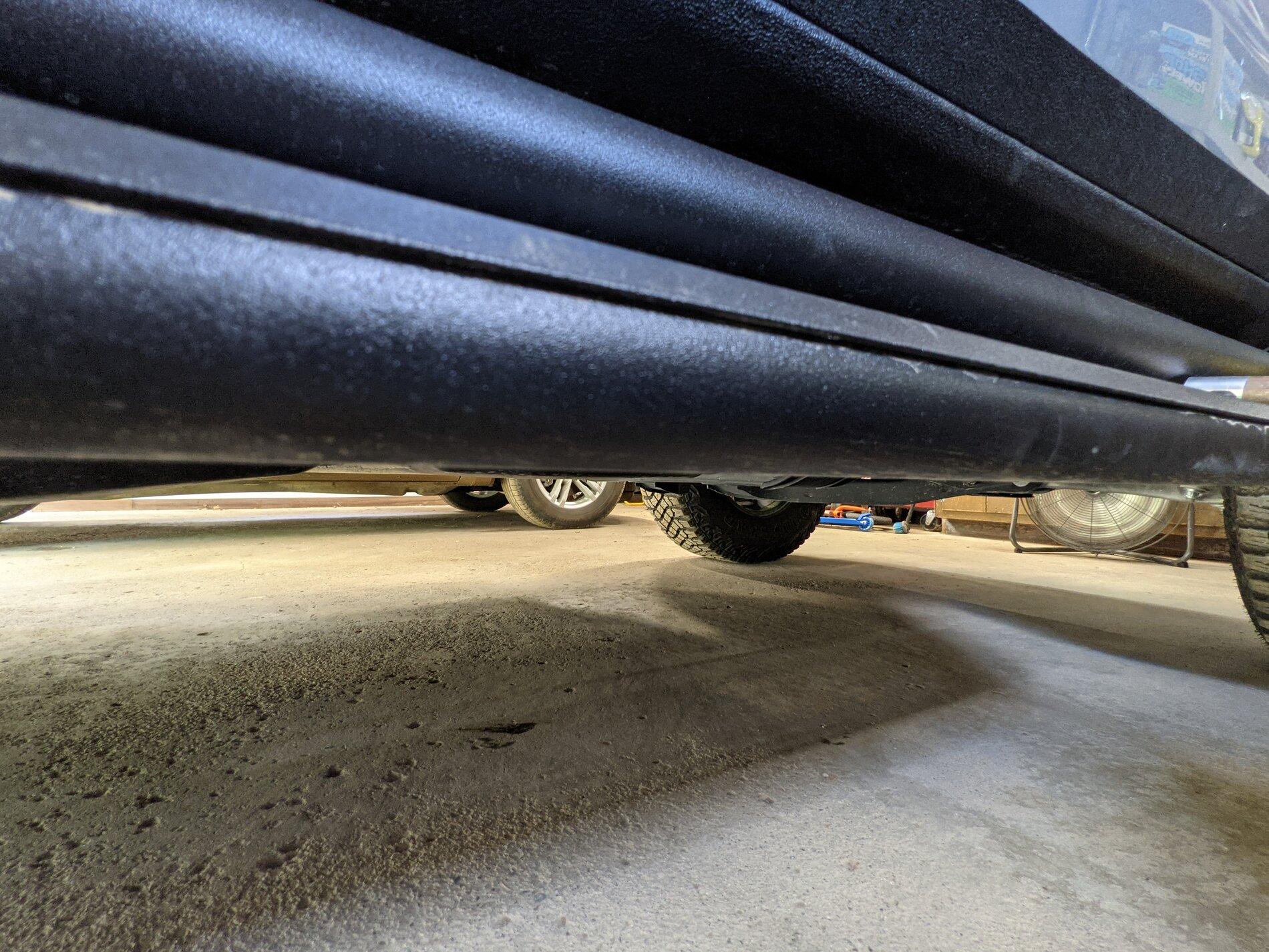

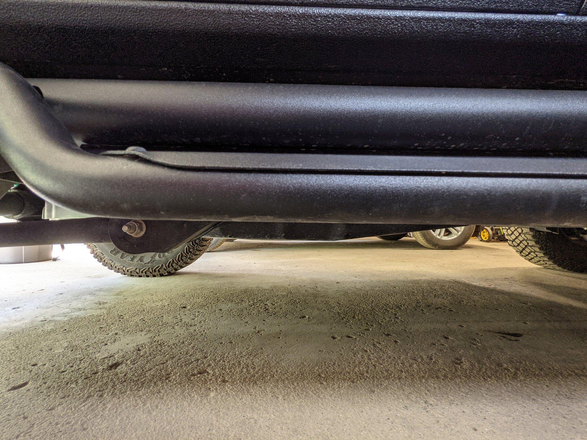

And some pictures for those of you who are going to ask about Clarence... I used the leveling feature in my phone app to take these to get the best angles I could manage. It appears that they take about 5" away from the bottom of the pinch welds.

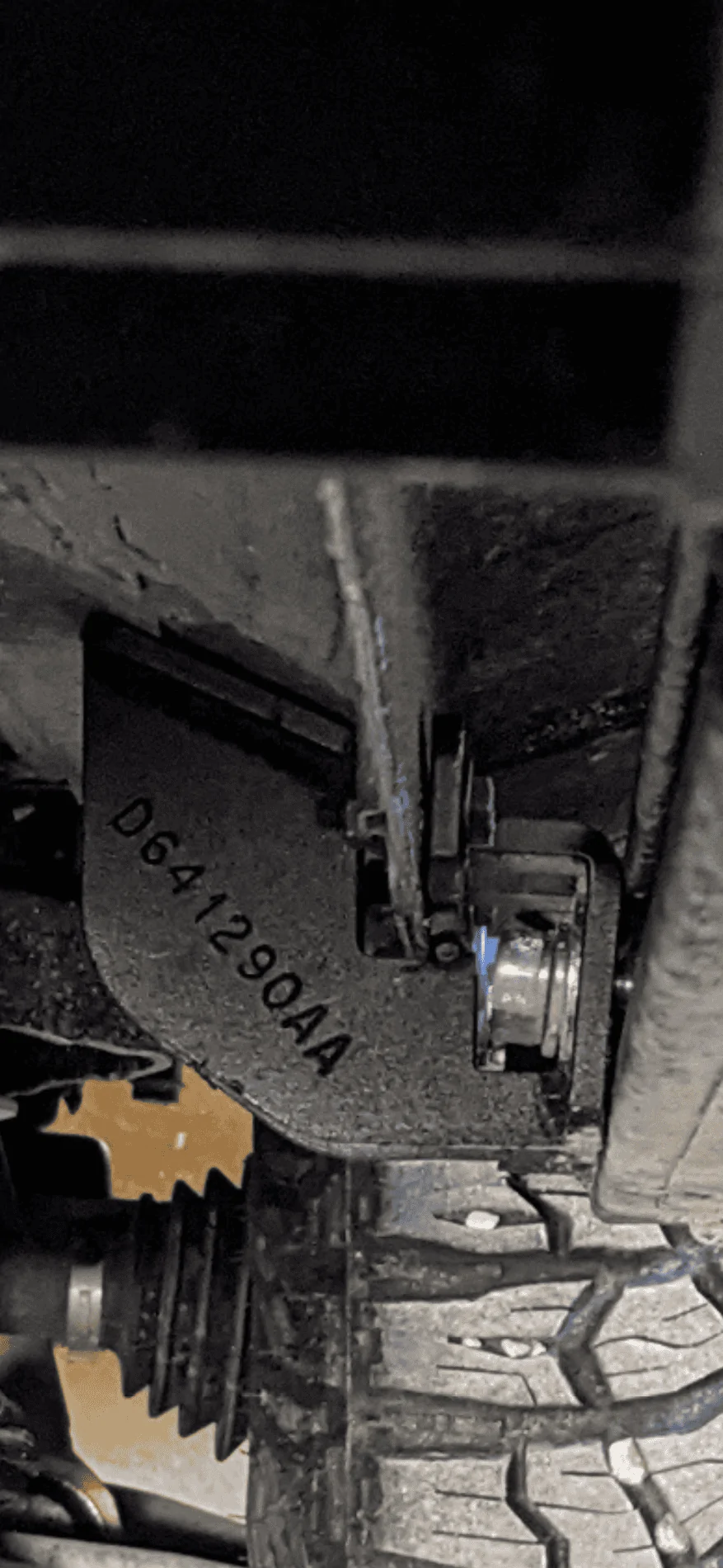

Kind of hard to tell but in that pic of the bracket with the pinch seam, it really looks like that is where your angle is coming from because it doesnt fit flush.
So either lower that bolt/bracket dow to not ride the edge of the seem, or put a spacer as thick as the seem so that your bolt bracket can be tightened down flush?

I see what you're talking about. The picture is actually deceiving. I was in the middle of trying to adjust the step when I took the picture so everything was loose. Nothing I tried corrected for the angle seen on the steps.

It looks good and seems to flow with the lines of the wheel wells…I was curious how good a step it is to get in the back seat. It looks like the step ends in the middle of the back door.
It's not ideal. The first time my boy got out he about fell when he hit the bar. But now that he knows where to step it hasn't been a problem.
