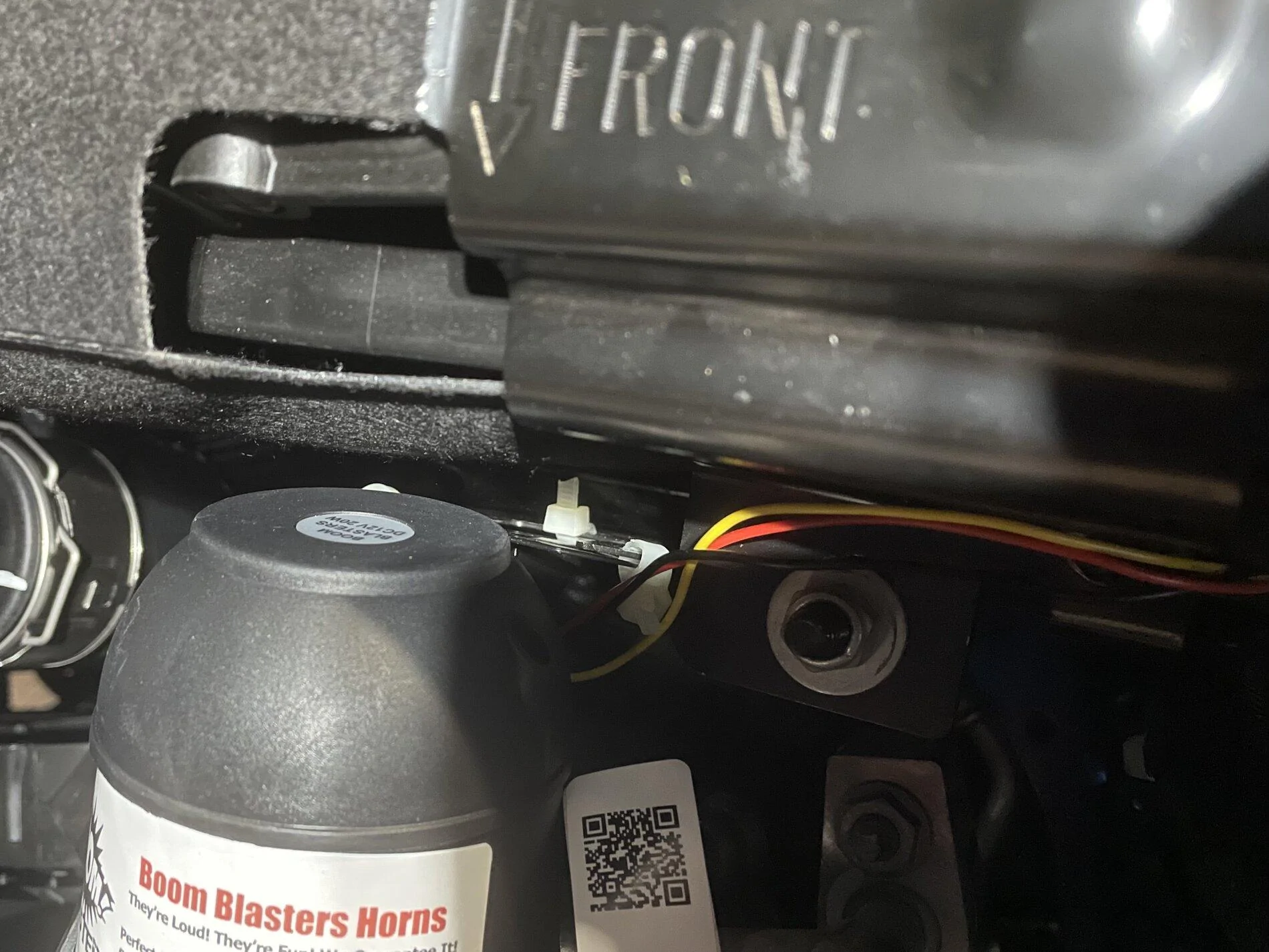

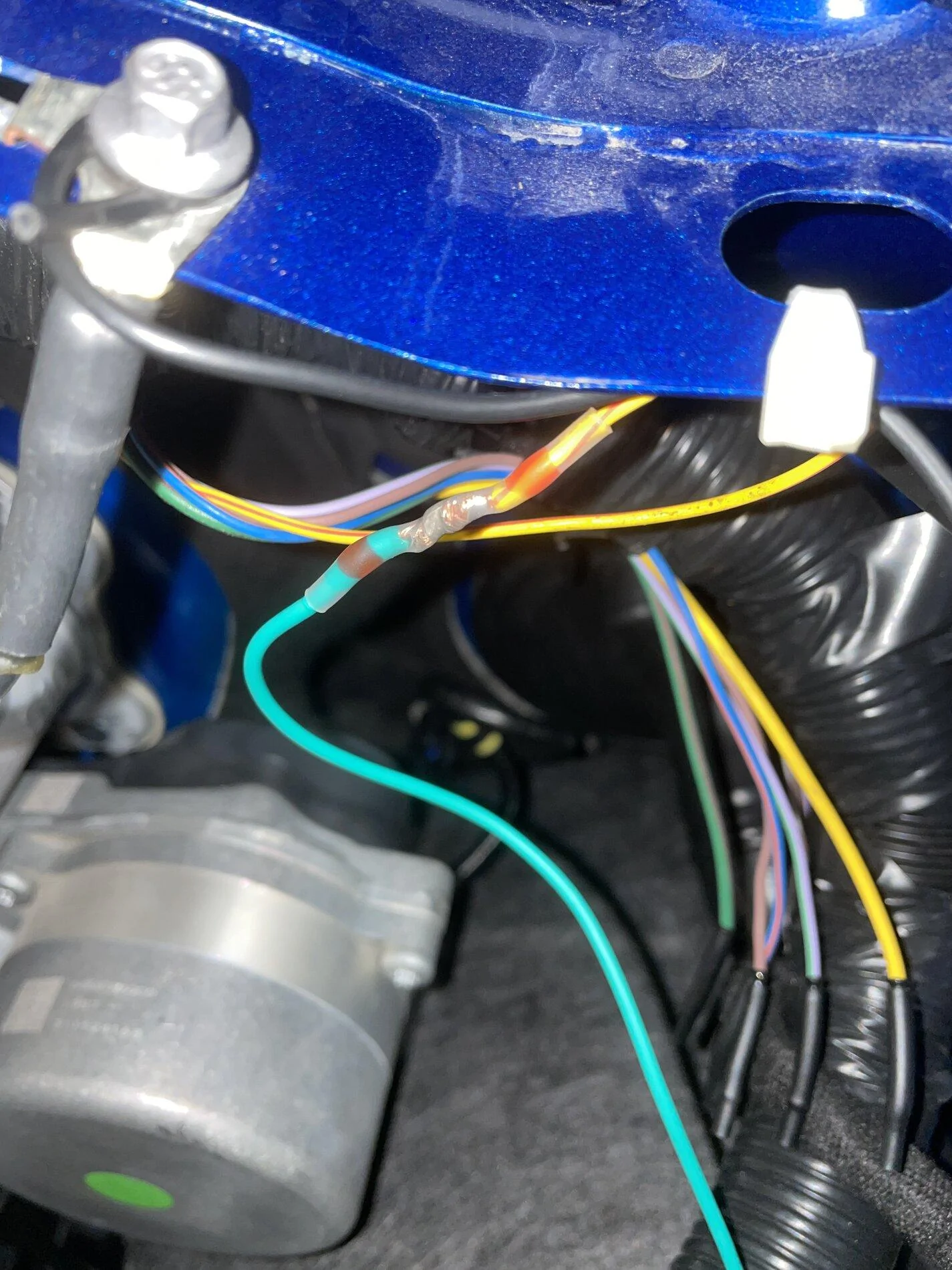

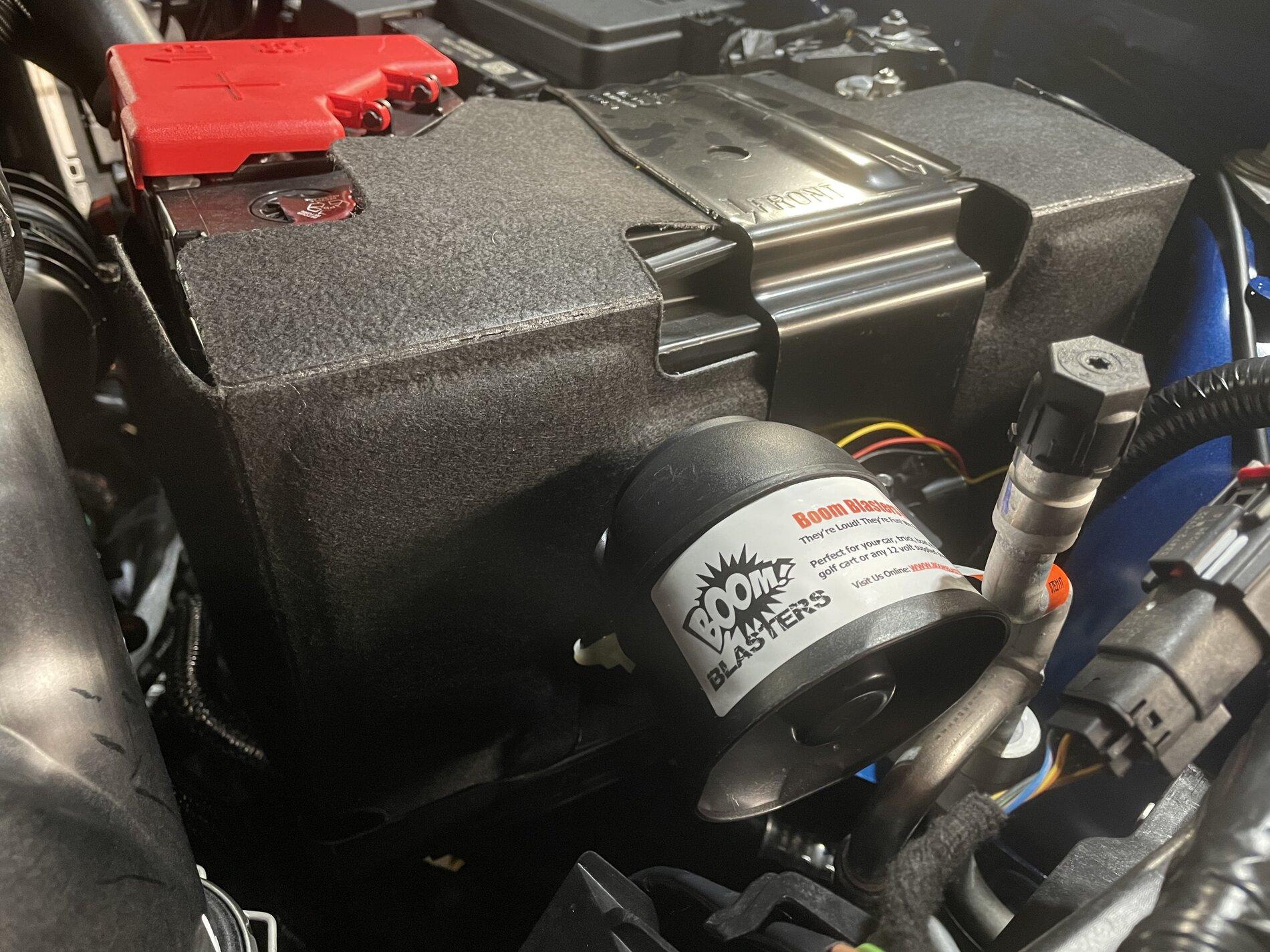

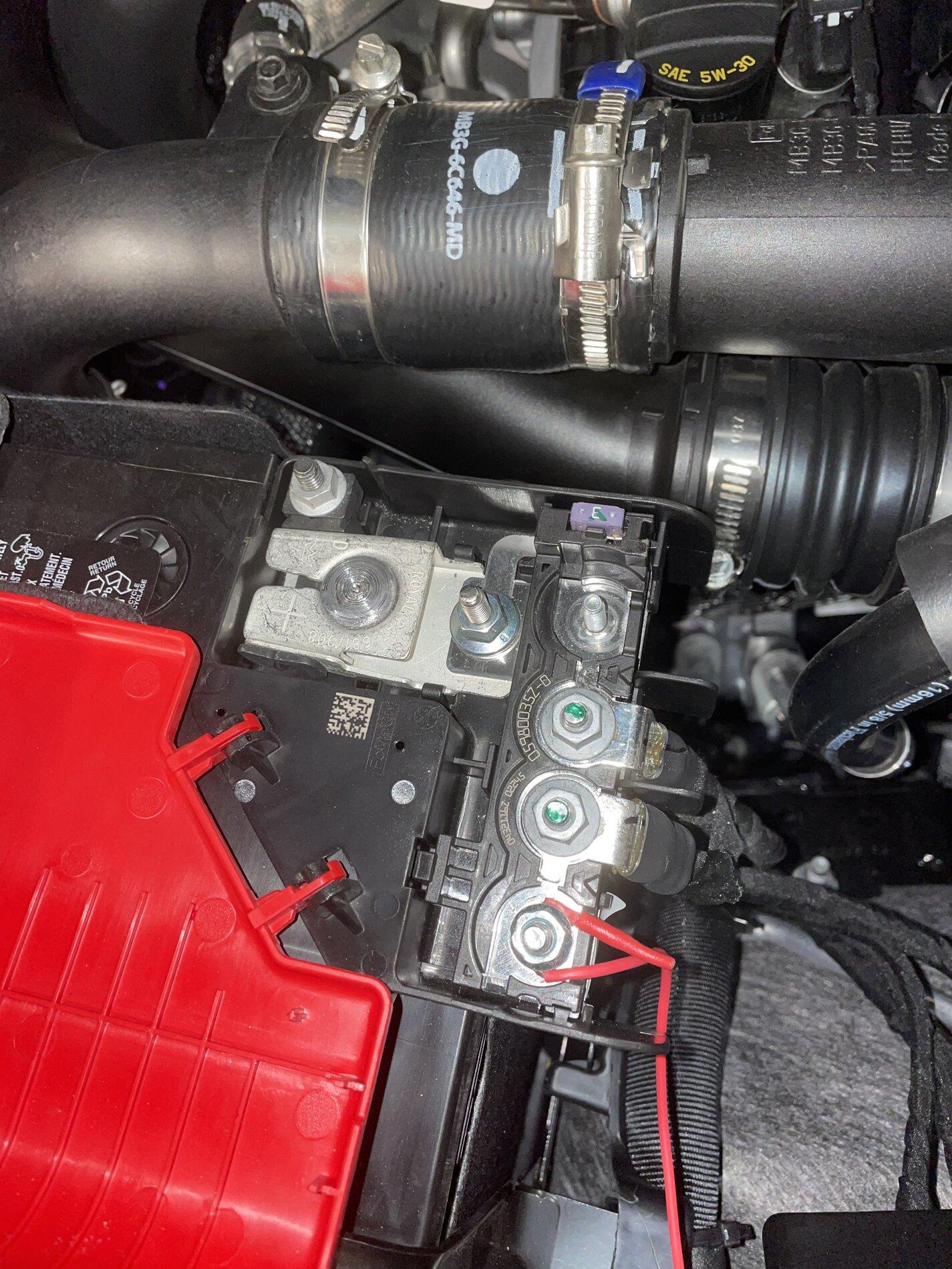

Here's how I'm using Aux 6: https://www.boomblasters.com/product/horse-sounds-car-horn/
Very easy install, there is even a bracket on the front of the battery that serves as a great mounting point.
I simply zip tied it on there, ran the red wire to the battery, black wire to a negative terminal on the body, and the yellow actuation wire to the yellow/orange aux 6 wire. Now everytime I toggle the switch, unsuspecting wranglers get this (Sorry for the shaky video):
