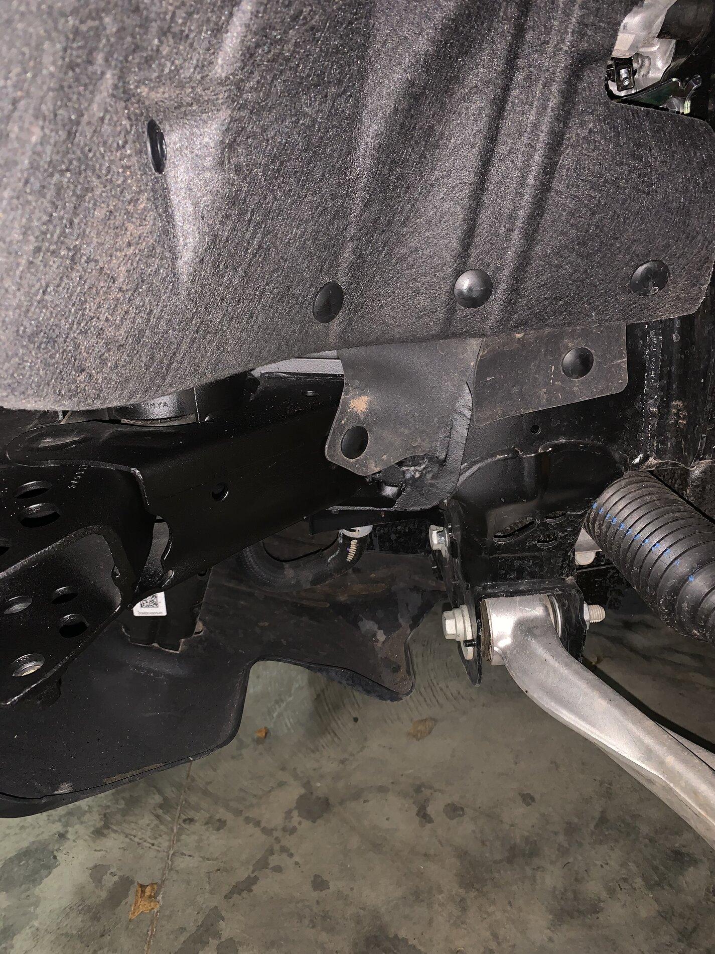

I received my Bronco from Grainger Ford on 9/25 got it home installed a 1“ RC level and some 37x12.5x17 Goodyear MT/R’s on the stock Sasquatch wheels knowing that I would likely have some clearance issues but with the intent to get them on and work to correct the issues because I love the look of the 37’s and I’m unsure of how the CV’s will handle being lifted much more and much taller and my 5’2” wife is gong to need a ladder to get in.

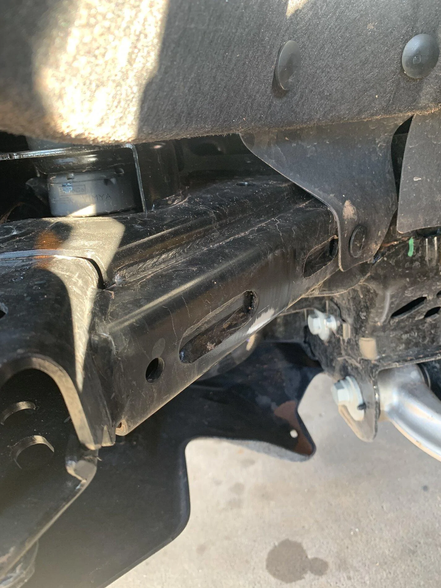

First noticeable rub was on the frond wheels at full lock on the support that goes from the frame to the bumper. Still kicking around what to do with this, considering notching it out and welding in some more steel, another option I might try is spacers but I don’t really want to add any width or deal with them.

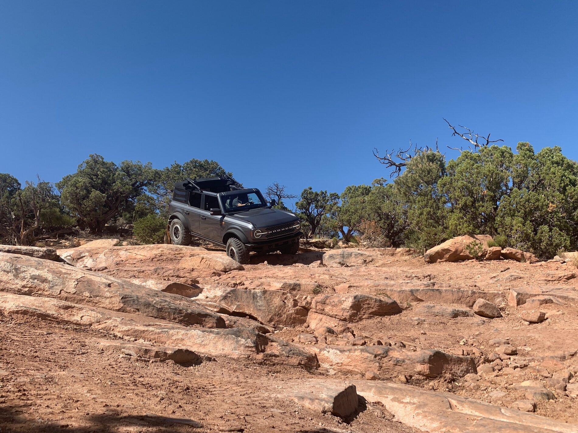

Next I drove it to Moab to see how it would do. I decided to try Top of the World trail, on the trial I ran into a group of 3 rubicons and they adopted me for the day. On the trail which has some decent ledges to play on the Bronco did awesome and on a few of the obstacles the Rubicon 4XE in front me took a couple stabs to conquer the bronco walked right up. I love the 1 peddle drive for going up hill of on fairly flat surfaces but dropping down a ledge it’s a little tricky because if you don’t work the throttle just right it will brake hard and cause a harder drop than ideal, also using for a long duration downhill I started to smell my brakes so I think they were getting too hot so I turned it off.

Can you take a pic Of this spot please?
((First noticeable rub was on the frond wheels at full lock on the support that goes from the frame to the bumper. Still kicking around what to do with this, considering notching it out and welding in some more steel, another option I might try is spacers but I don’t really want to add any width or deal with them.))
Also do you think It would rub with no lift the way you have it now?
Also do you think It would rub with no lift the way you have it now? Yeah

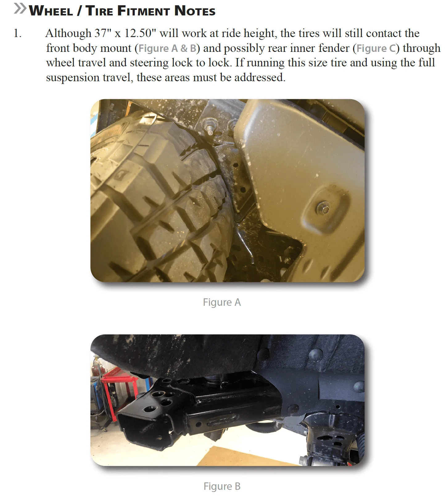

These are the photos in the BDS/Zone SAS+3" lift kit instructions. Still waiting for photos of someone brave enough to cut into the frame...

Pro tip…”small” 37s like the BFG KO2 and KM3 might be the way to go on these Bronco’s to keep from rubbing the frame off road. They run about half an inch to inch smaller than a “true” 37.

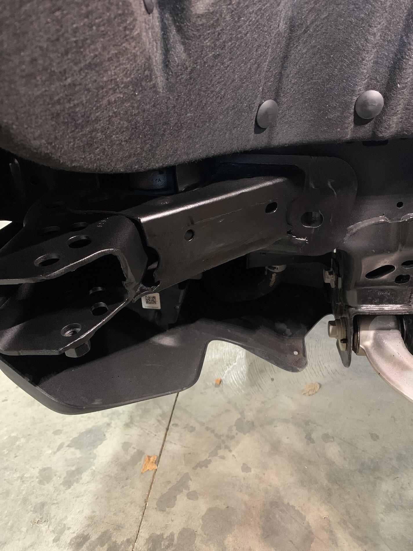

Well I did it😬 cut off where it was rubbing and welded the seam. IMO the area will still have plenty of strength but time will tell. Good news is tires have no clearance issues that I know of now😁. I’m going to keep wheeling it and update this if anything else pops up.
You are the man!
Keep it up and keep us posted.
To me it looks like that bracing you removed was likely there for extra support for the crash bar in the event of an accident. If you removed the crash bar, it probably serves no purpose...

To me it looks like that bracing you removed was likely there for extra support for the crash bar in the even of an accident. If you removed the crash bar, it probably serves no purpose...
yeah that was my thought on it but I didn't engineer it so just experimenting I guess.
