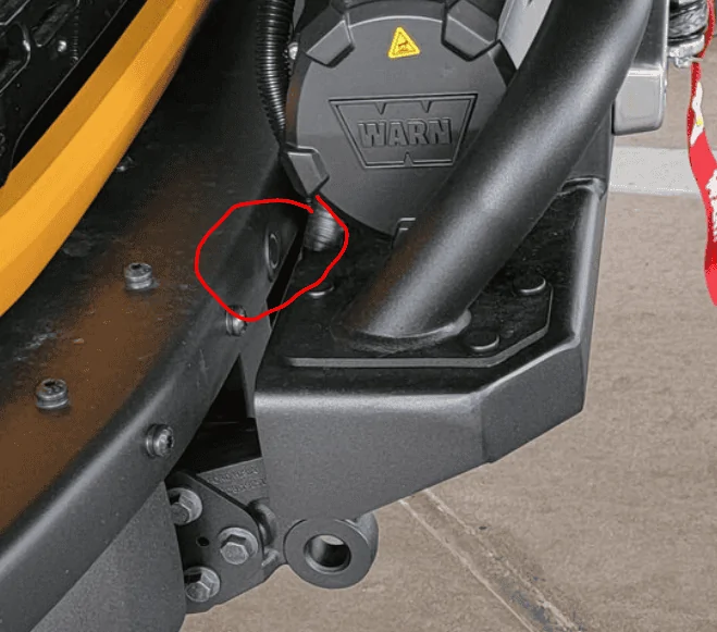

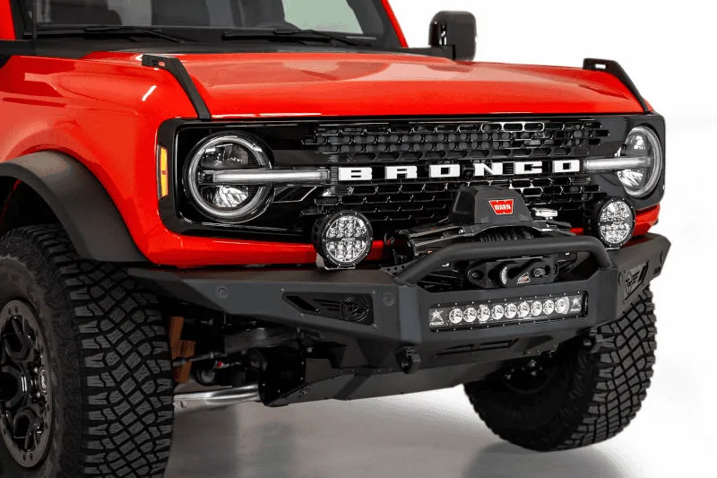

I think this is the Ford Performance Winch Package, which I kinda thought was a bit butt-ugly - side shots like this are a bit rare, so this changes my mind a bit (I am getting a Base so no parking or ACC worries). My understanding is this requires the modular bumper and accommodates the factory skid plate with no modifications, the price (which includes a 10,000 # winch, which one is not clear, it is shown as "Unique WARN® 10,000 lb. Winch") is $3,500 not really that bad when you price up other options. This looks like you might be able to put it on and take it off seasonally? So far my list of folks who may have a near to real design are: the Ford Performance (designed with WARN, above), Warn (Elite bumper), Rough Country (really a skid plate mounted winch), Addictive Desert Designs and Road Armor. DV8 has shown a few designs ... below is the ADD design.
Ford Bronco SSM 50169 - how to disable front sensors via touchscreen for 2021 Broncos with front parking aid sensors & winch 1633396948710
The bumper only (winch extra) is $2400, but you have to trim "3 - 4 inches off each side" of the OEM plate or buy their (aluminum) one for $700 so about $3100 so far. I am getting a Basquatch with standard bumper and no skid plate so I save $825, making the $3,100 not so bad (except for the winch). They do have a bracket to relocate the ACC. Does anyone have any opinion on ADD rep/quality?

Where did you get that picture? Do you have others?
