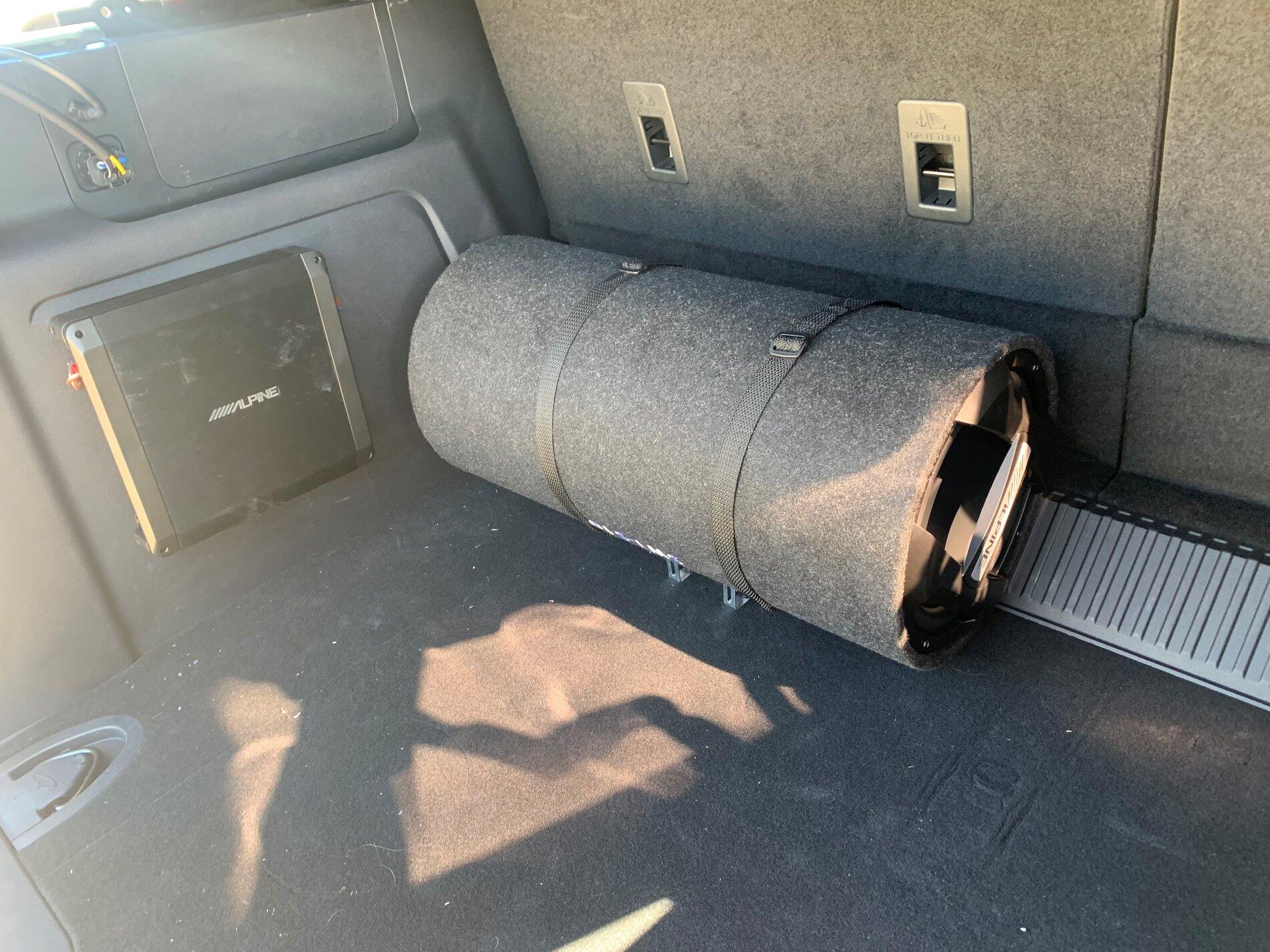

I installed a 600W Alpine amp and a 10" Alpine subwoofer tube. All in about $250-300 with parts and wiring. It sounds incredible, i worked as a custom car audio installer and built several state competition winning vehicles... it's not a competition sound, but sounds great. This is my first post so hopefully this works, i'm adding some pics of the factory sub and wiring.

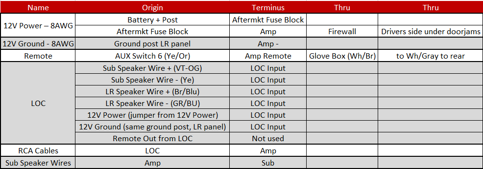

I used my AUX switch #6 for my remote wire, that way i can turn off the "extra" bass when necessary, without having to have a separate bass control knob. If you haven't wired any of your AUX switches yet, it's pretty easy. The hardest part is the glove box... the wires aren't long enough so getting both hands into the small space to splice them together was tough.

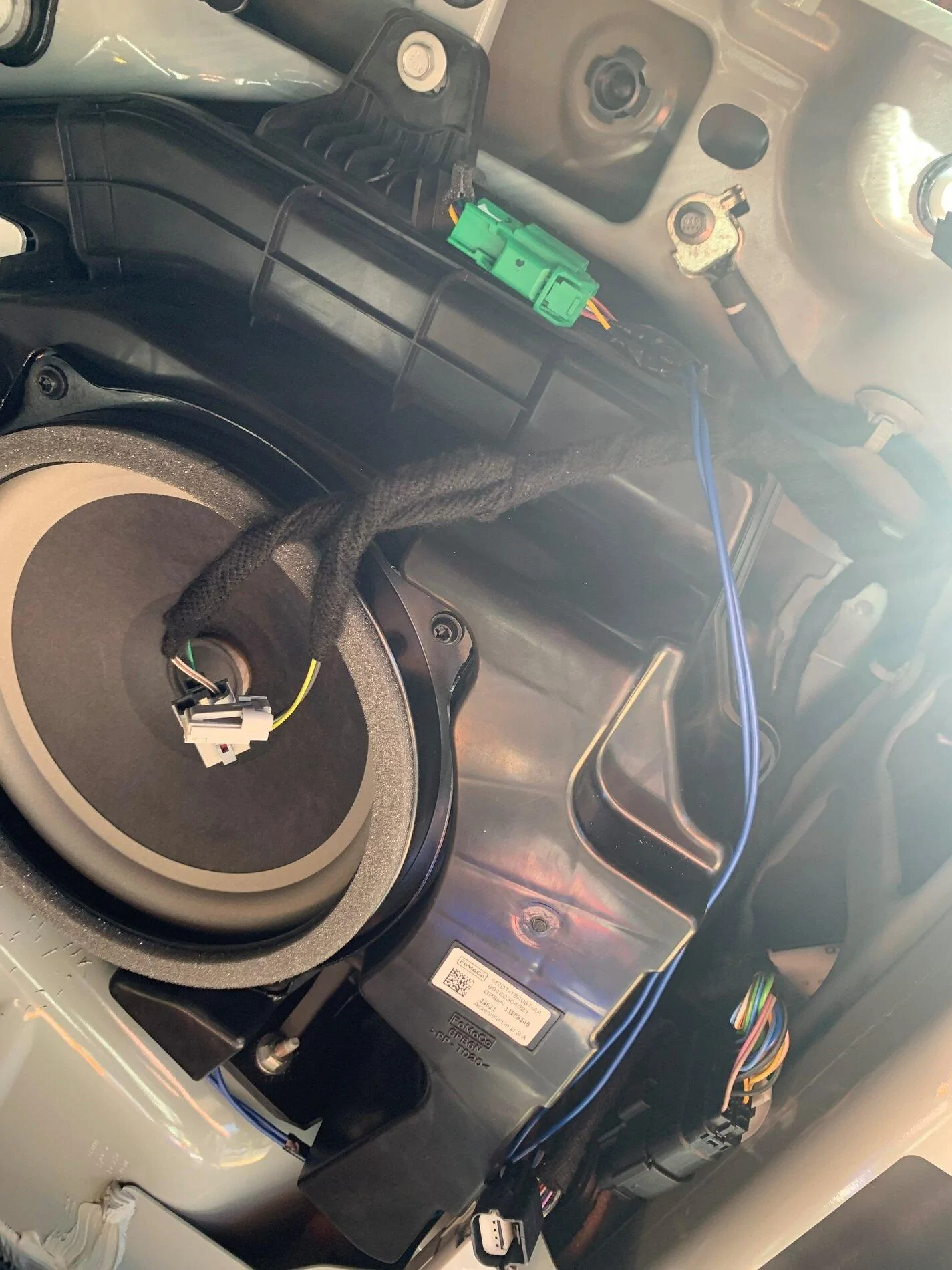

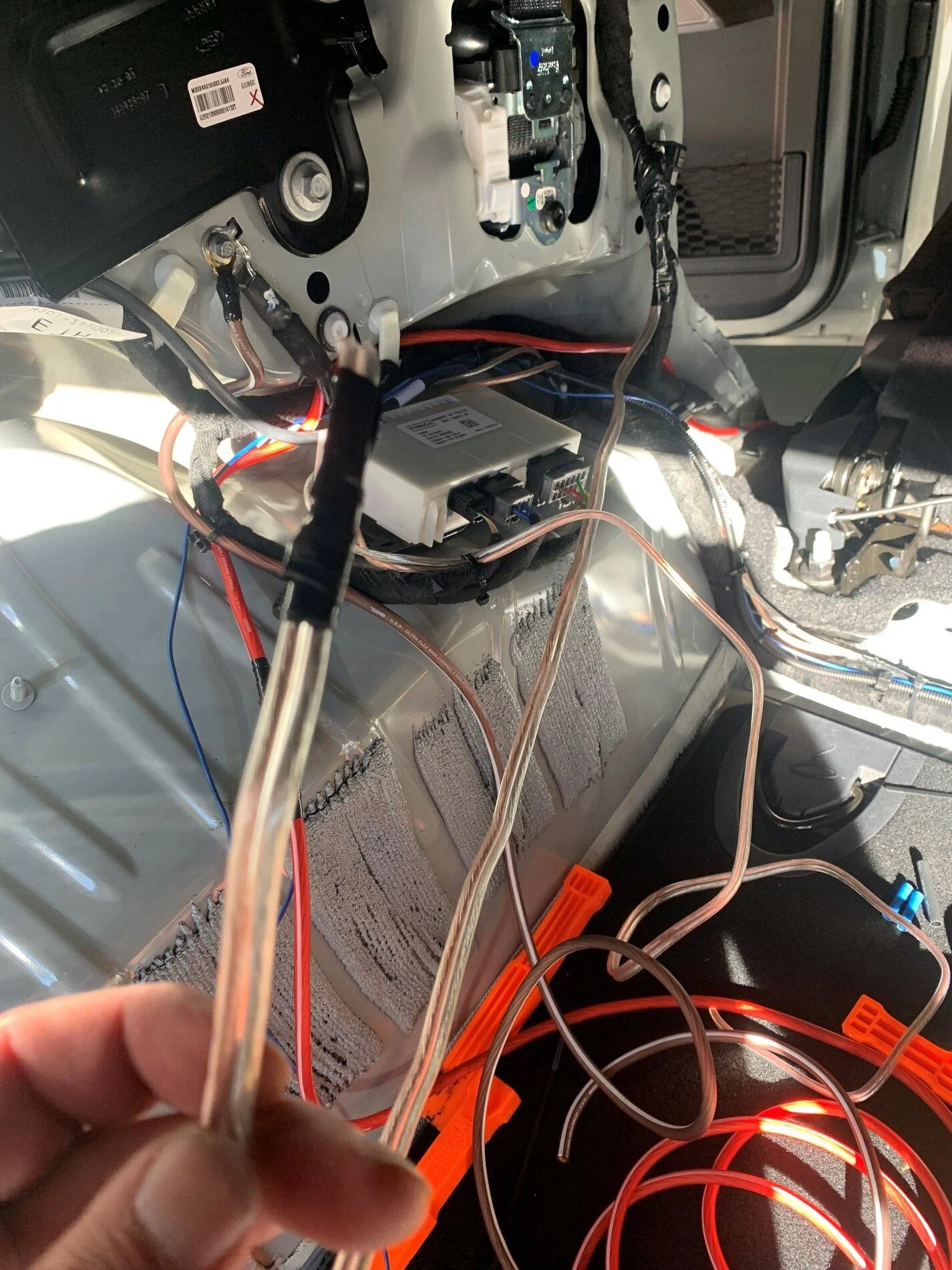

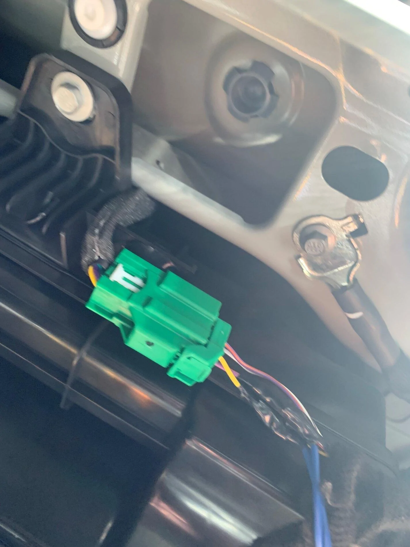

I installed a 8 AWG power wire from an empty battery post > new 40A fuse block > Driver's side firewall (gasketed hole already there, no drilling needed). Ran Power down drivers side under the door jams. Grounded near the amp on a factory grounding post. Installed a LOC from the factory wiring. There are four speaker wires going to the factory sub. My LOC had four speaker inputs. Because I've read that the factory B&O system tones down the subwoofer at higher volumes, I wanted a fuller sound without that downscaling. So i used the speaker wires from the Rear left speaker, and one of the pairs from the subwoofer. Ran RCA's from the LOC to the sub. Connect everything, and good to go. Total install time, about 4.5 hours.

Wiring:
Ford Bronco Subwoofer & Amp Install in B&O System (OuterBanks/LUX/Sasq/B&O/4dr) - Writeup DIY screenshot-2021-10-21-130933-

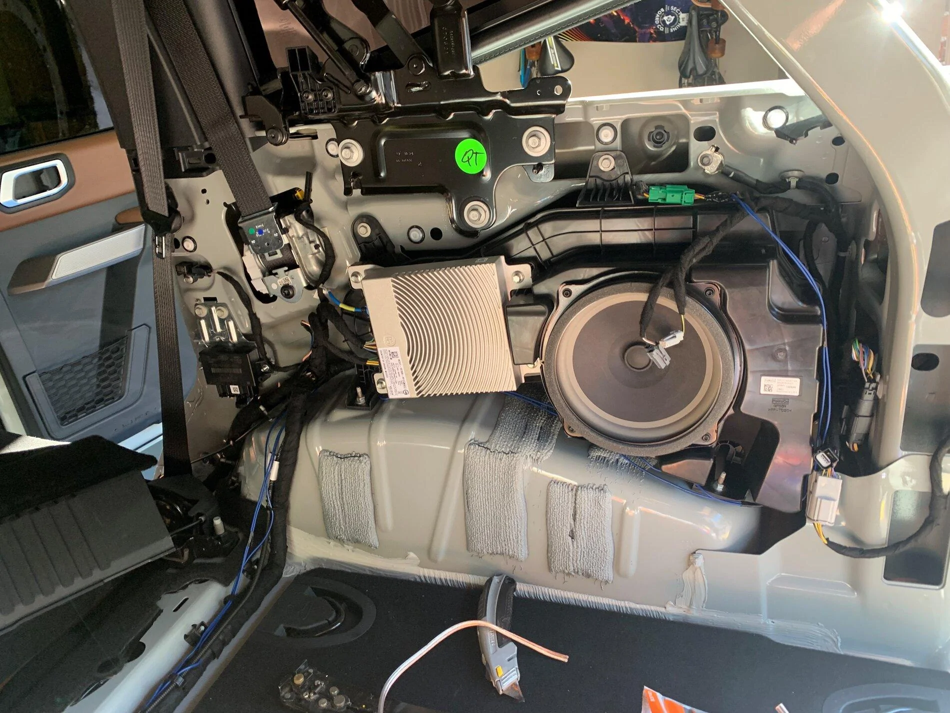

Factory Sub & Amps (blue wires are my subwoofer > LOC splice)

DRIVER REAR Speaker Tie-in

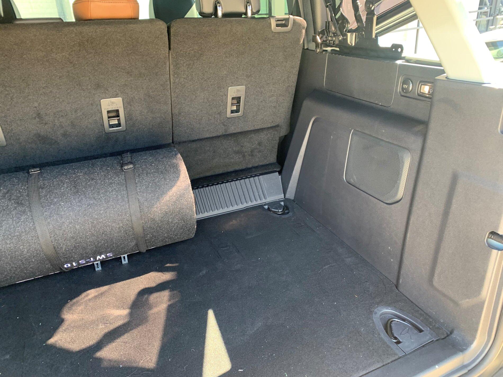

Sub and amp installed:
Ford Bronco Subwoofer & Amp Install in B&O System (OuterBanks/LUX/Sasq/B&O/4dr) - Writeup DIY 6-
Ford Bronco Subwoofer & Amp Install in B&O System (OuterBanks/LUX/Sasq/B&O/4dr) - Writeup DIY 7-
Ford Bronco Subwoofer & Amp Install in B&O System (OuterBanks/LUX/Sasq/B&O/4dr) - Writeup DIY 8-

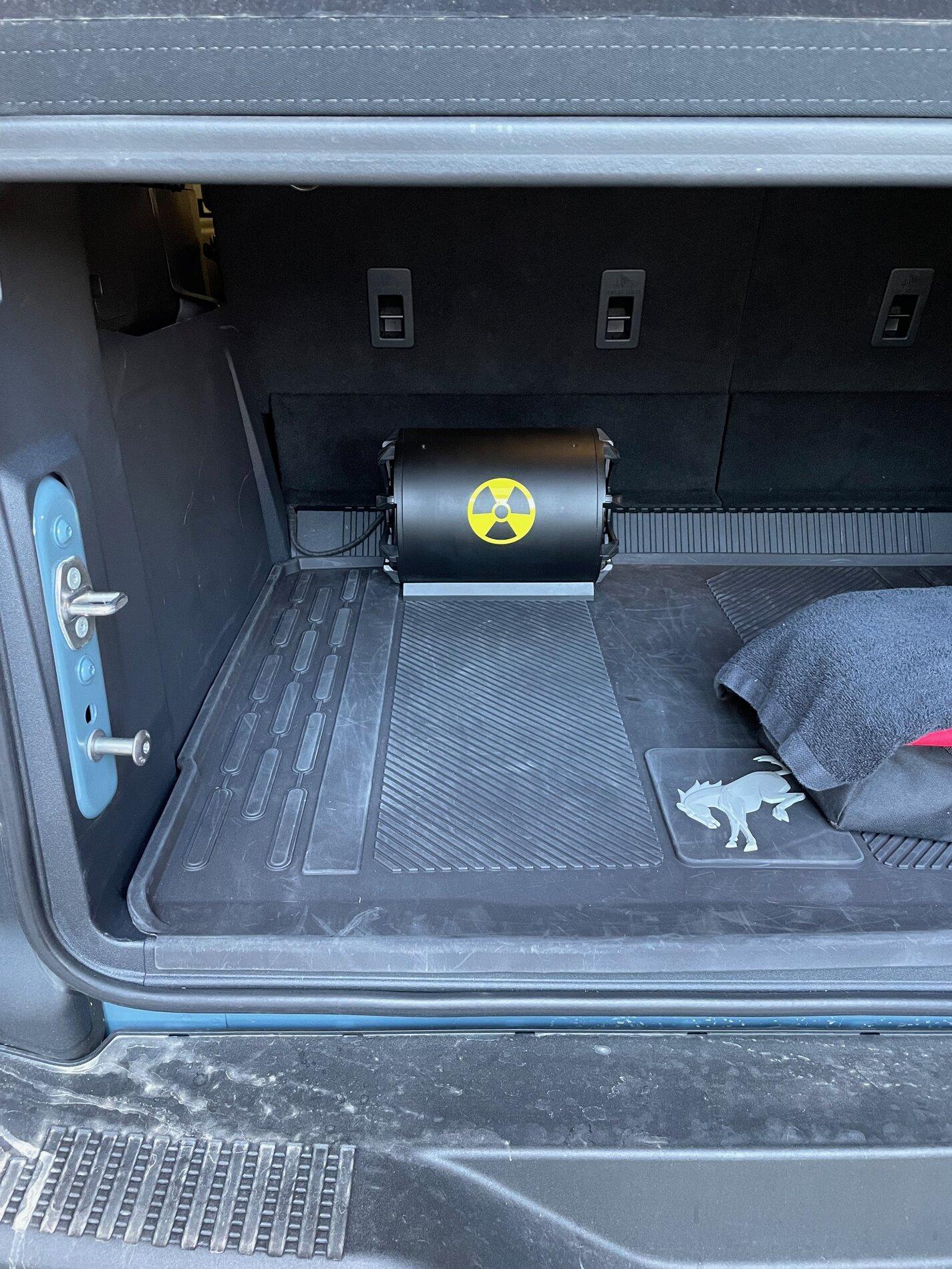

Ford Bronco Subwoofer & Amp Install in B&O System (OuterBanks/LUX/Sasq/B&O/4dr) - Writeup DIY IMG_0954
I built an enclosure which sounds great but takes up too much room.
Ford Bronco Subwoofer & Amp Install in B&O System (OuterBanks/LUX/Sasq/B&O/4dr) - Writeup DIY IMG_1017
So I replaced with one of those removable Kicker Tubbies.
Ford Bronco Subwoofer & Amp Install in B&O System (OuterBanks/LUX/Sasq/B&O/4dr) - Writeup DIY IMG_0980

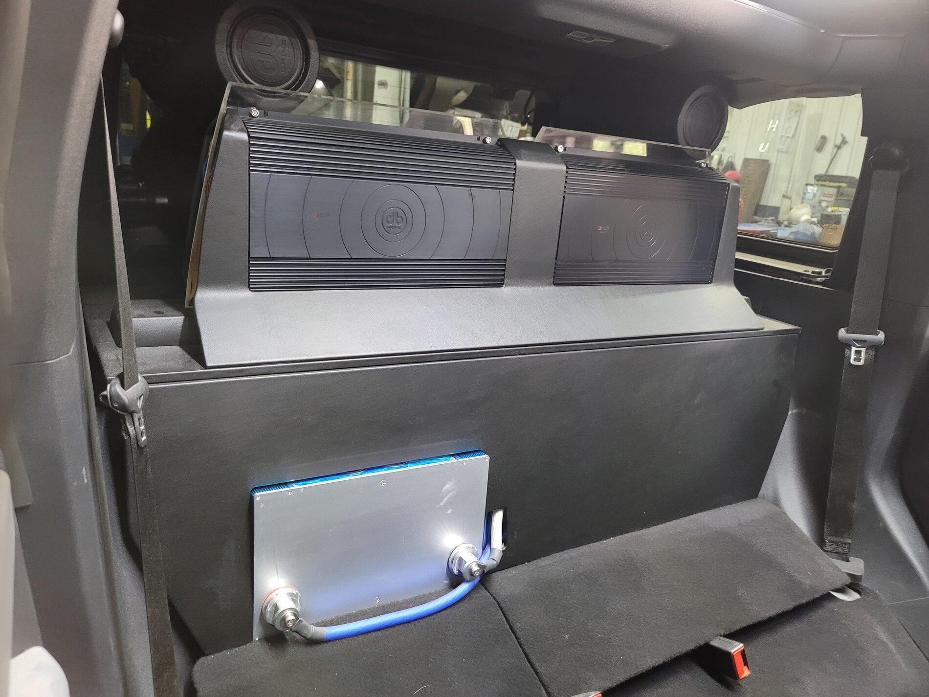

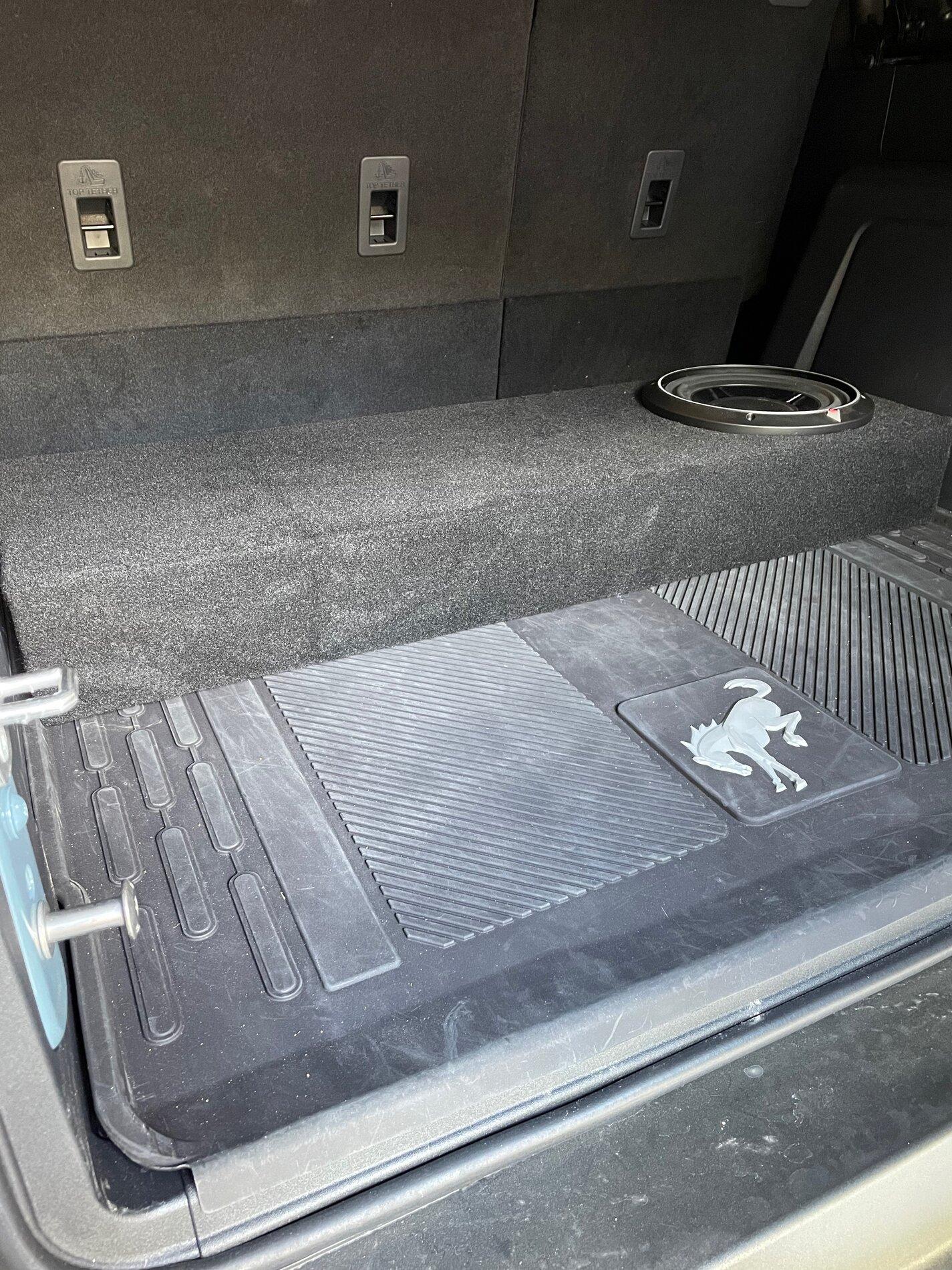

I went crazy with mine. It's loud AF also. I'm going to add 2 more 8" Marine Towers also.
Holy hell!!! I assume this is more for tailgates and stuff with the everything facing backwards? How's the rattle? Did you dynamat this thing?
Also, did you put a Cap in line? Do your lights turn off completely when the bass hits lol. This is nuts! I'm impressed.
