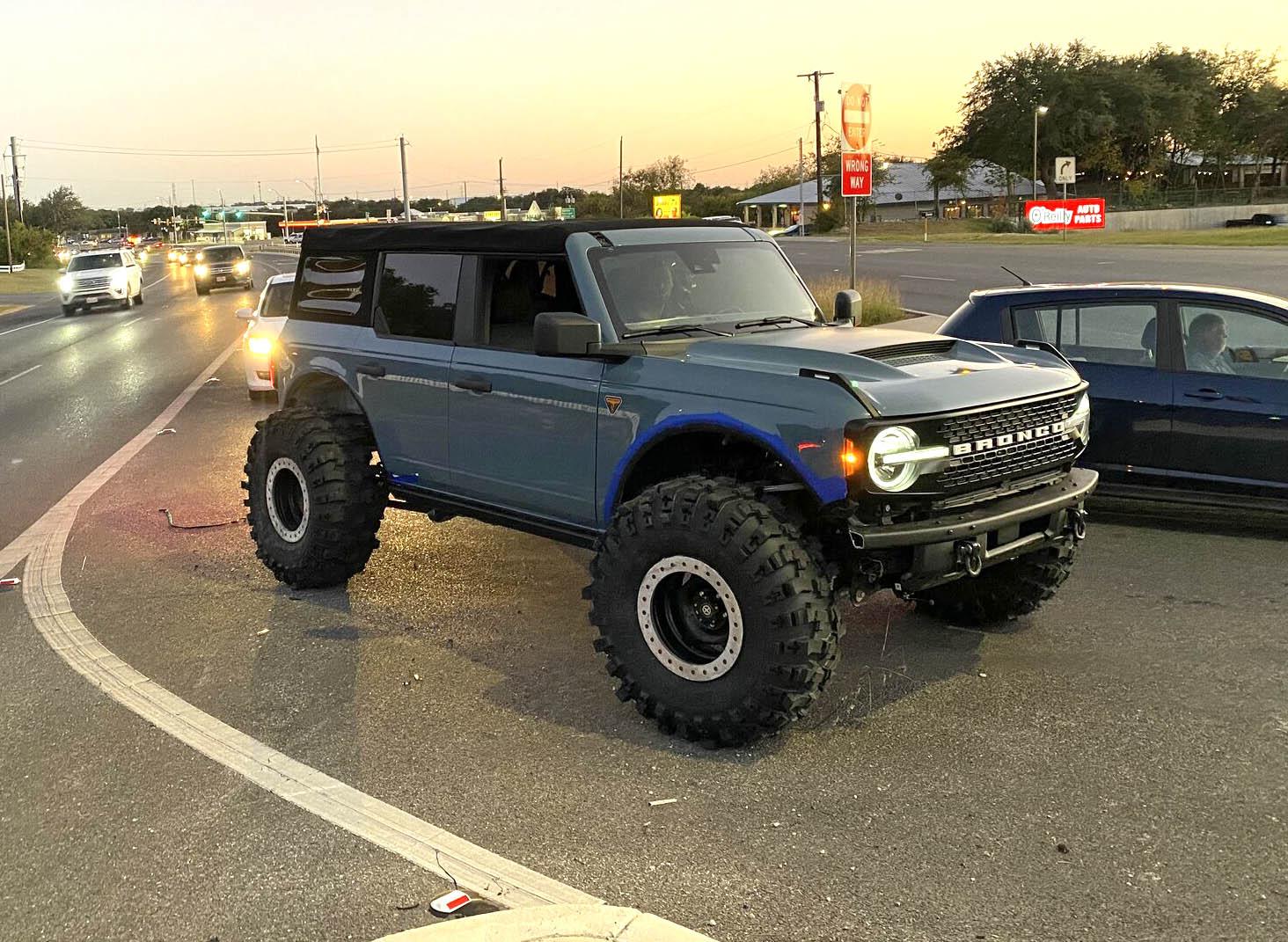

Super sick, happy to see IFSs on 37s and 40s.
Did they have to shave the wheel wells?
What's the lift and hardware on her?

Wheel wells. Bumpers. Anything inside the wheel well. Part of the frame too by the looks of it.

Cut out wheel wells, cut fenders up about 4” from stock. 2” puck lift. 4 wheel parts upper control arms

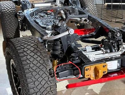

Probably not the safest mod I've seen - looks like the frame was removed a little below where the body mount attaches.
