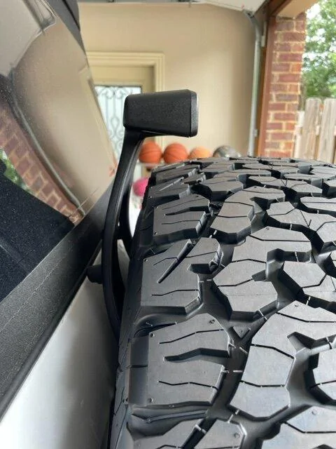

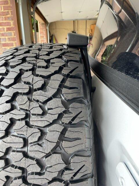

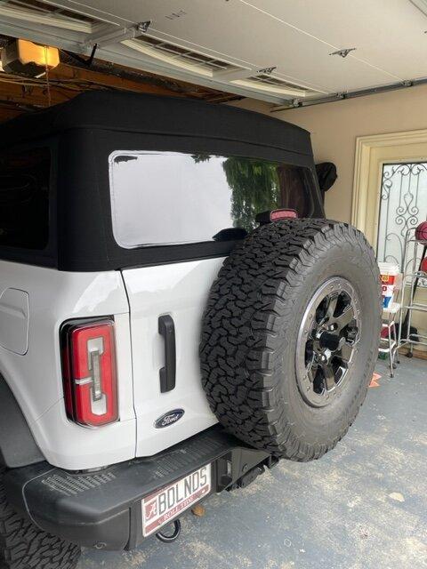

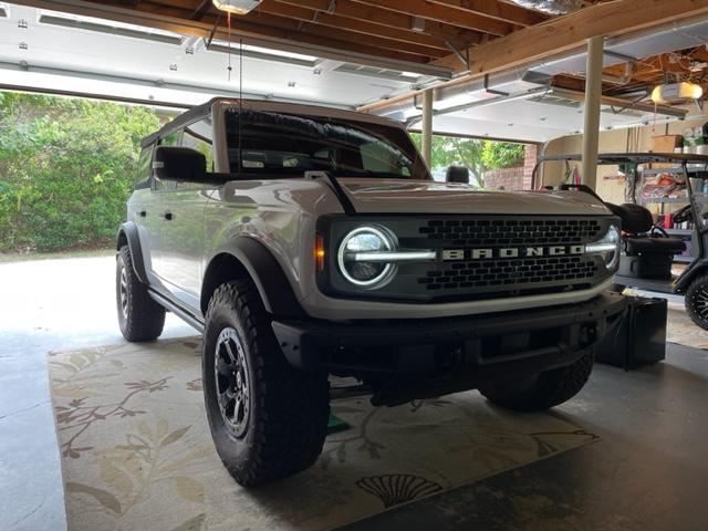

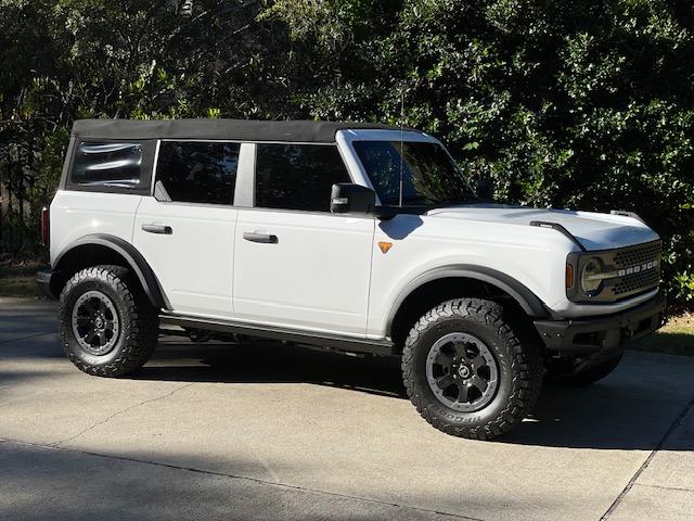

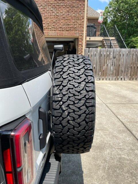

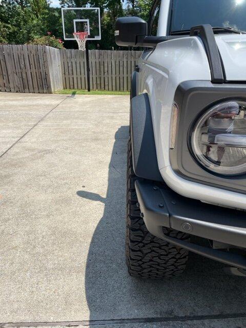

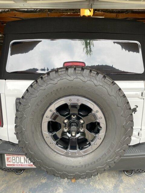

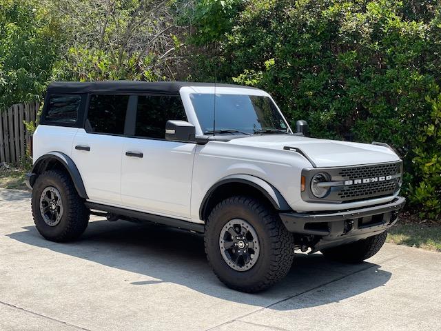

Recently purchased 3K mile takeoffs from a F-150 Raptor which replaced the 285/70 that came factory. For the front, all I did was remove the crash bars to fit the tires. I purchased the Rough Country 3rd brake light extender and had to shave the rubber bumpers .5" for the new spare size. I did not use the spacer that came with the RC kit. In hindsight, it appears I could of gotten away without the light extender but I will keep in for now. No issues at all and a great ride. I was very close to the 1" level kit but it doesn't look terrible to me so I'll drive it for a bit and see how I feel. I also kept the stock fender flares which are almost perfectly even with tire. First pic is before then rest are after install.

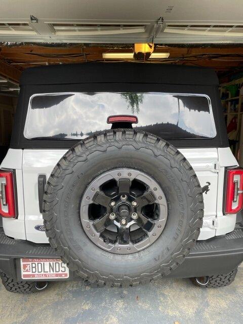

Okay I couldn't stand it anymore. I had to take the extension off. To each their own I suppose but the gap was bothering me. Also, the amount of water and debris that gets on the doors and sills is ALOT without the SaS flares. I will be adding those soon.

Looks great my friend!! 100% better without the brake extension to👍
