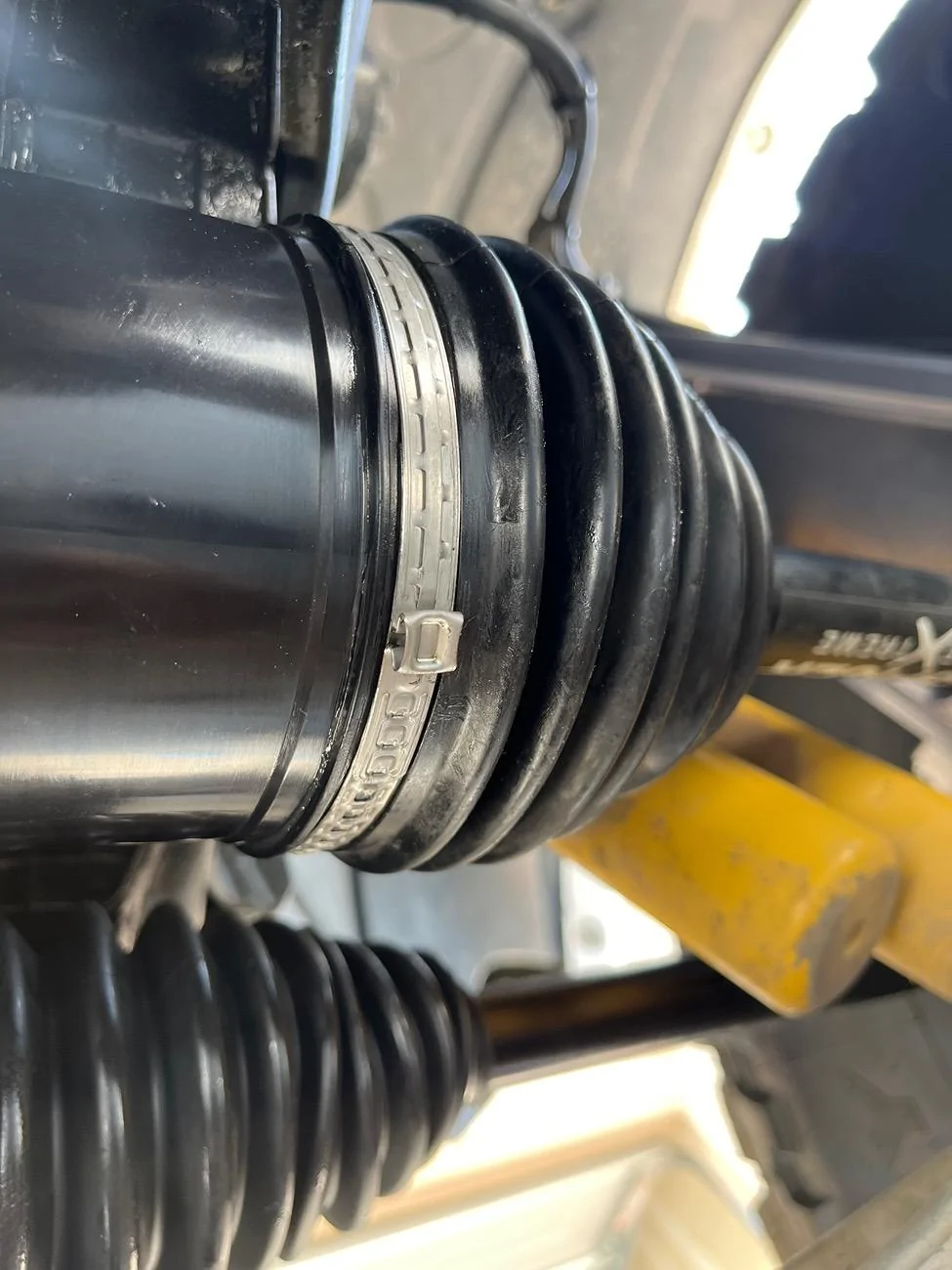

Got it filled back up with plenty of grease and new clamps installed. Also-there is a lip on the outside of the bell. I’m feeling like the original clamp may have been installed loosely as I was able to move it by hand. This new one was installed with a wrench operated clamp vs pliers (no idea what they use at spicer but the latter would certainly be more efficient) and I’m not able to move it. Fingers crossed!

Based on all the inquiries asking about this (exactly zero) it was time for an update:
Replacement boot is looking good and holding up well. The driver side recently did the same thing, but that was while the bronco was sitting on jack stands and the suspension was drooped out. Put a hair dryer on it and got the boot back to normal. Peculiar that it happened but it seems good to go.
No other issues with this setup.
