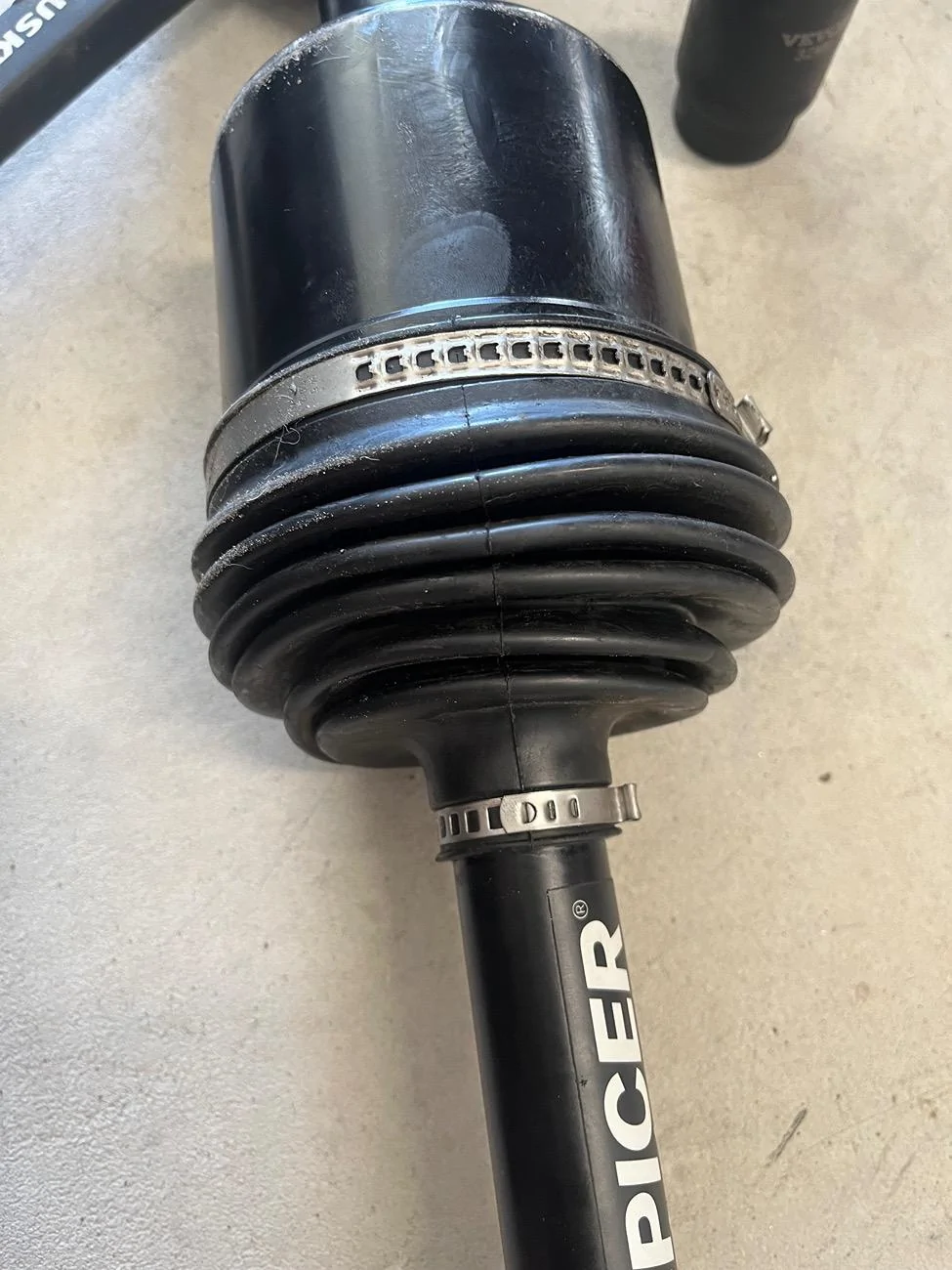

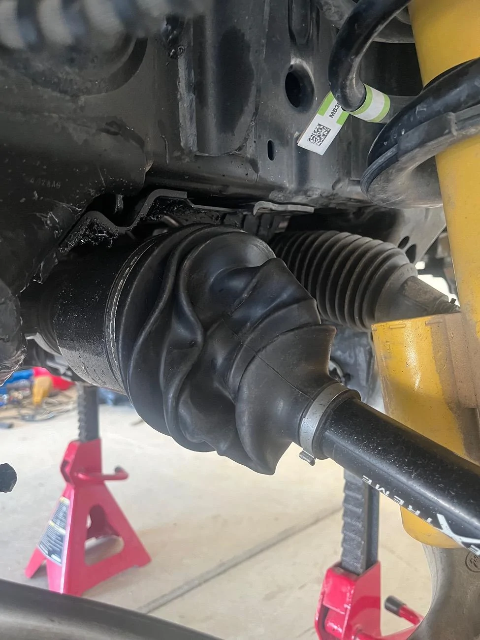

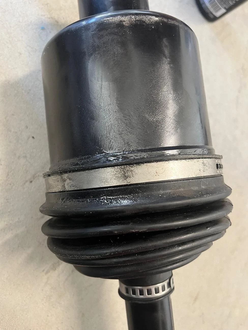

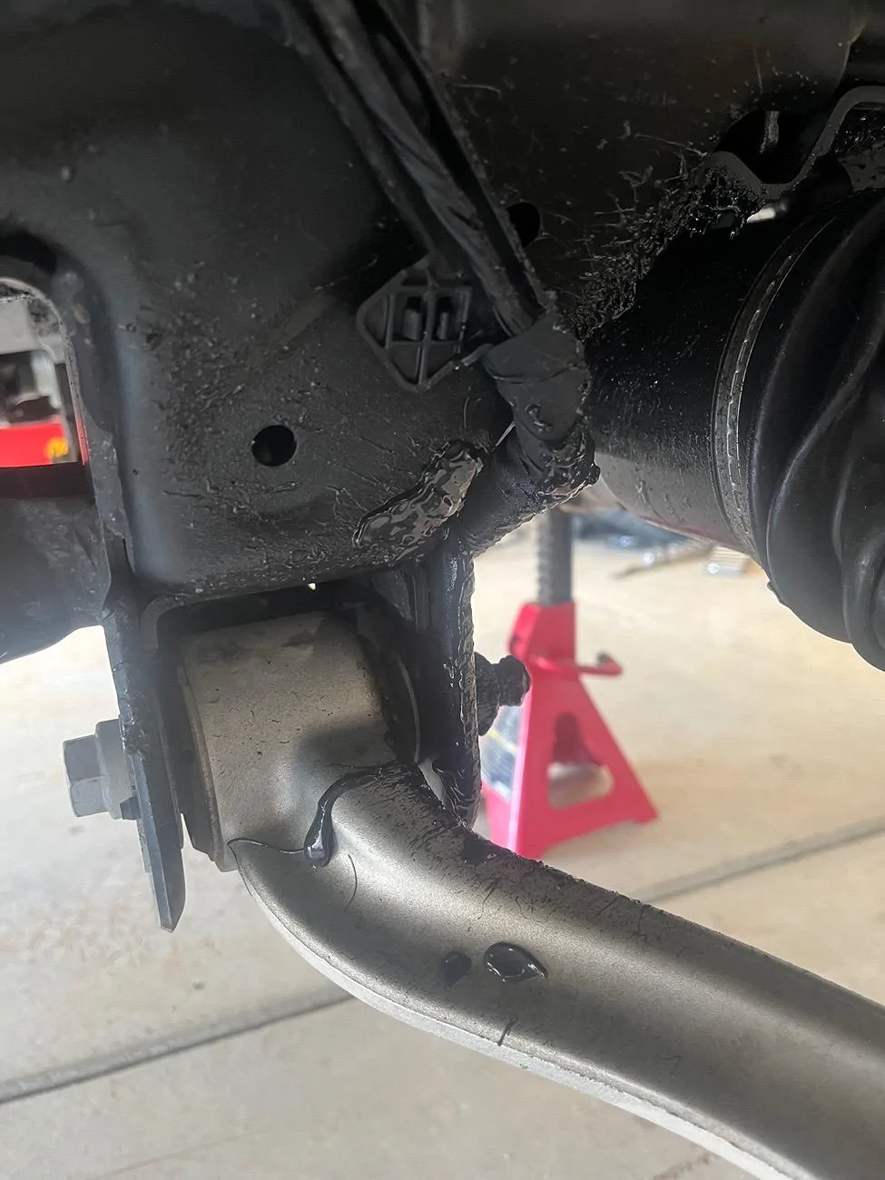

Went to change the break in oil on the diff and start tearing everything else apart and noticed all kinds of grease has been leaking from the passenger side CV axle. And the boot almost looks like it has a vacuum on it-I cannot pull those creases out. I don’t see any holes but it’s kinda hard to get to. This is after maybe 300 miles and no wheeling. Northridge is getting with Dana at the moment to see if this is a warranty issue or not but I thought I’d check with the group to get some feedback on what is happening.

I was able to get everything straightened out with it out of the vehicle, but it wants to stay in the collapsed position. The grease appears to be pushed out of the boot. There’s no excessive play or noise and it still feels brand new. Which makes sense seems how it only has a couple hundred miles on it 😂
Northridge is being awesome on customer service, frequently letting me know they’re still waiting on Dana for a warranty decision. I think I’m going to go ahead and cut this off to install the portals instead of waiting for what might be months and then see what kind of deal @Northridge4x4 might be willing to work out on a replacement so I can have a spare if this fails prematurely.

Update-Dana said this is due to temperature changes and is sending a new boot and clamps. Is that a thing? Other side is fine. All the stock boots are fine 🤔🤷🏼‍♂️
you must have some really strange temperature distributions in your garage. Be careful walking around in there you may get burnt in the wrong spot. 😂
hopefully it is just a quality control issue and that was one bad boot.
