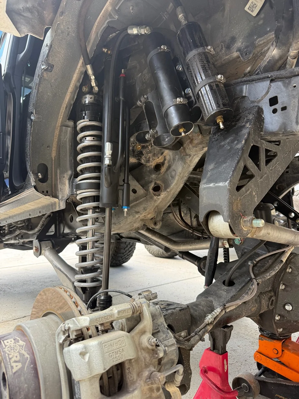

With the gas tank being in the way, the upper links are “semi-triangulated” and you do lose some axle control with the panhard deleteThe lateral axle movement when wheeling is real, but the amount of said movement will be the result of the rest of your components. If you get the PB&J lower links that allow for much higher misalignment, that will contribute. Aftermarket coilovers with more travel and spherical bearings will allow further movement of the setup. When we had Rock Krawler coilovers designed for the factory mounting locations and PB&J links, the driveshaft just kissed the Next Venture gas tank skid plate mount when articulated. Got a double cardan driveshaft and fixed that issue. Not sure whether the stock driveshaft would have hit the stock gas tank mounts or not.
My buddy with the 4link put longer travel RK coilovers on the back. Flexes like crazy and performs very well on the trail, but his driveshaft actually rubs against the gas tank even with the smaller diameter Adam’s Driveshaft propshaft driveshaft driveline.
