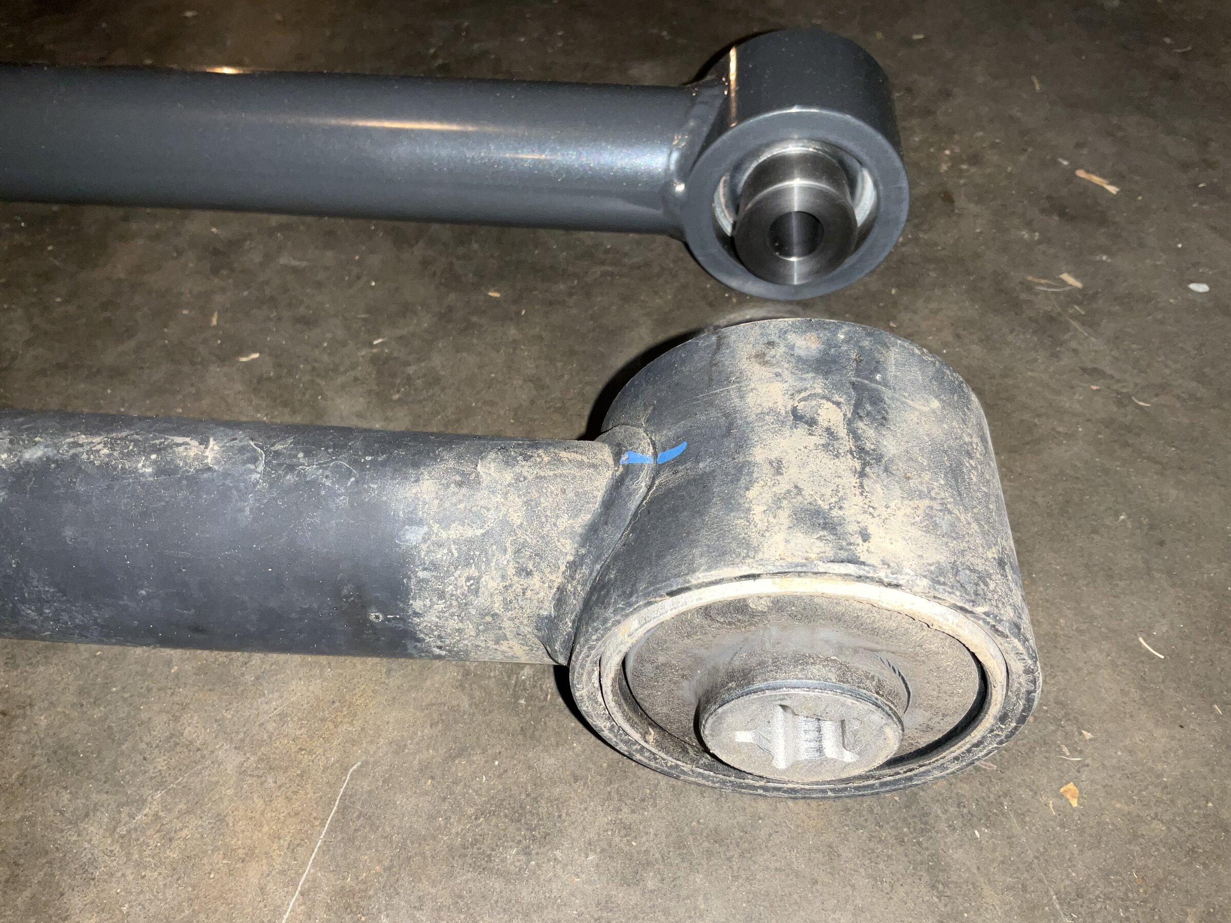

kodiakisland
Jul 10, 2020
5,767
16,374
Arkansas
12 Tacoma, 18 Indian, 23 GV70
My rubber bushings on the lower arms were already cracking. Hard, brittle rubber. Glad I replaced them.
