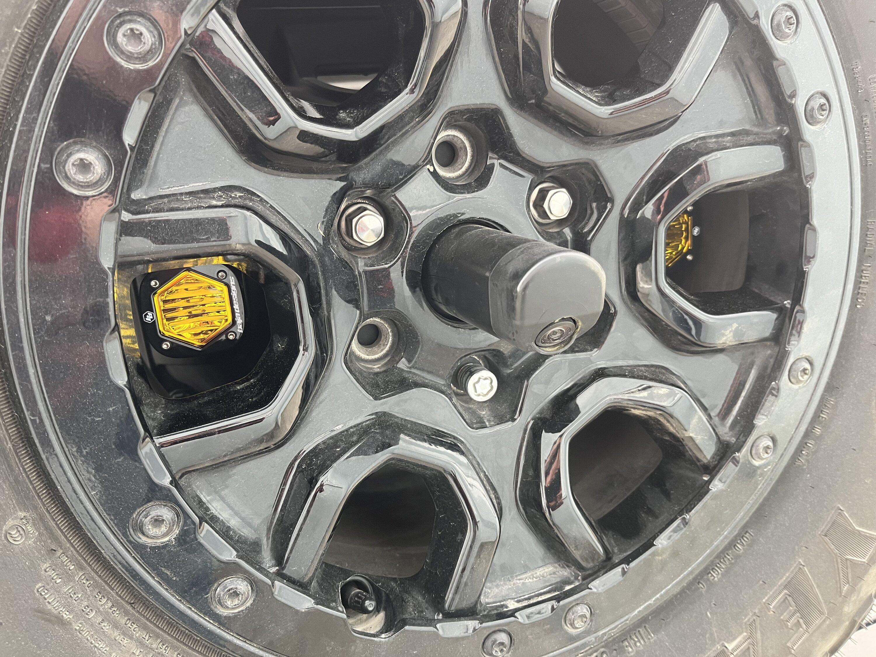

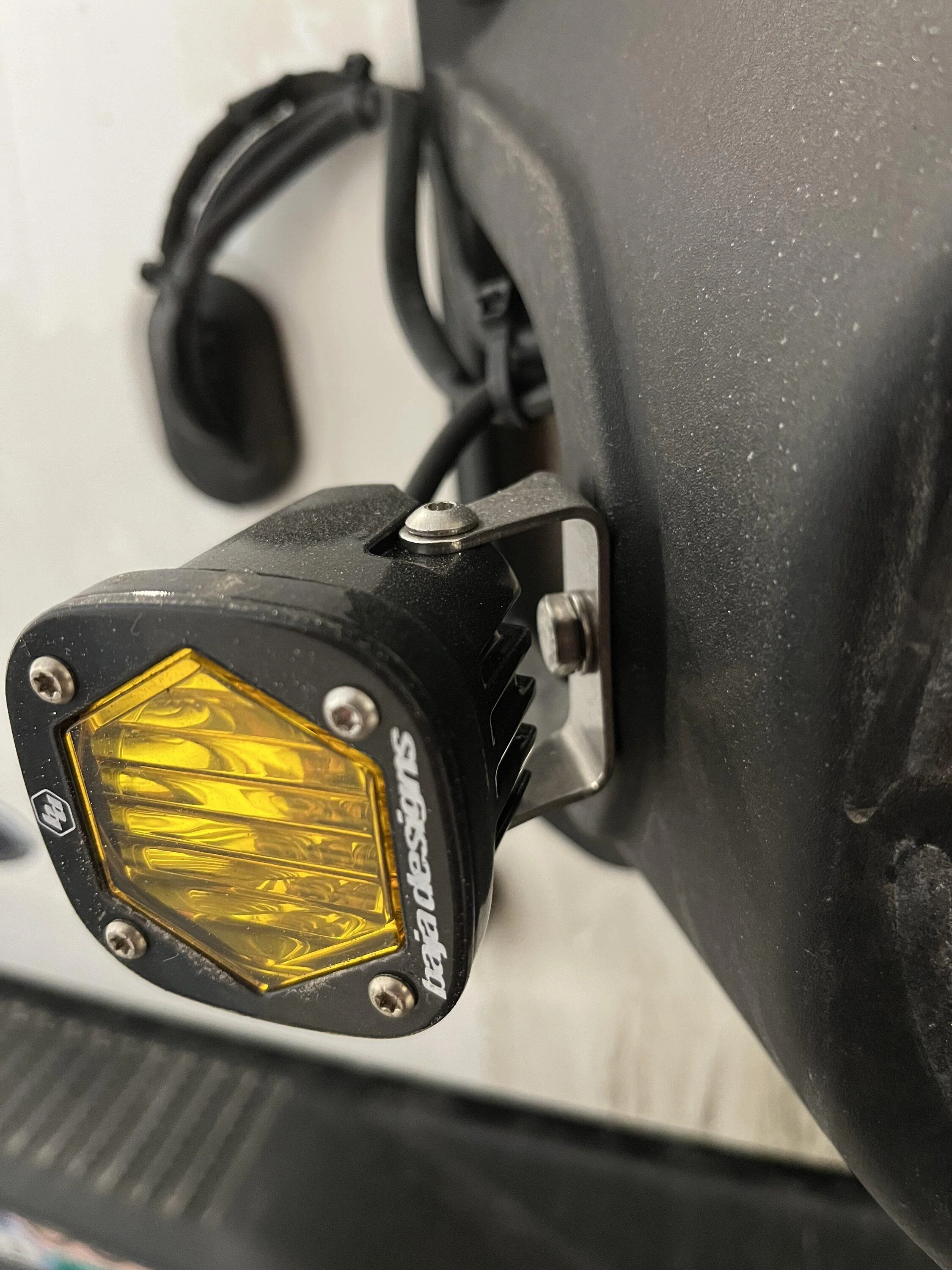

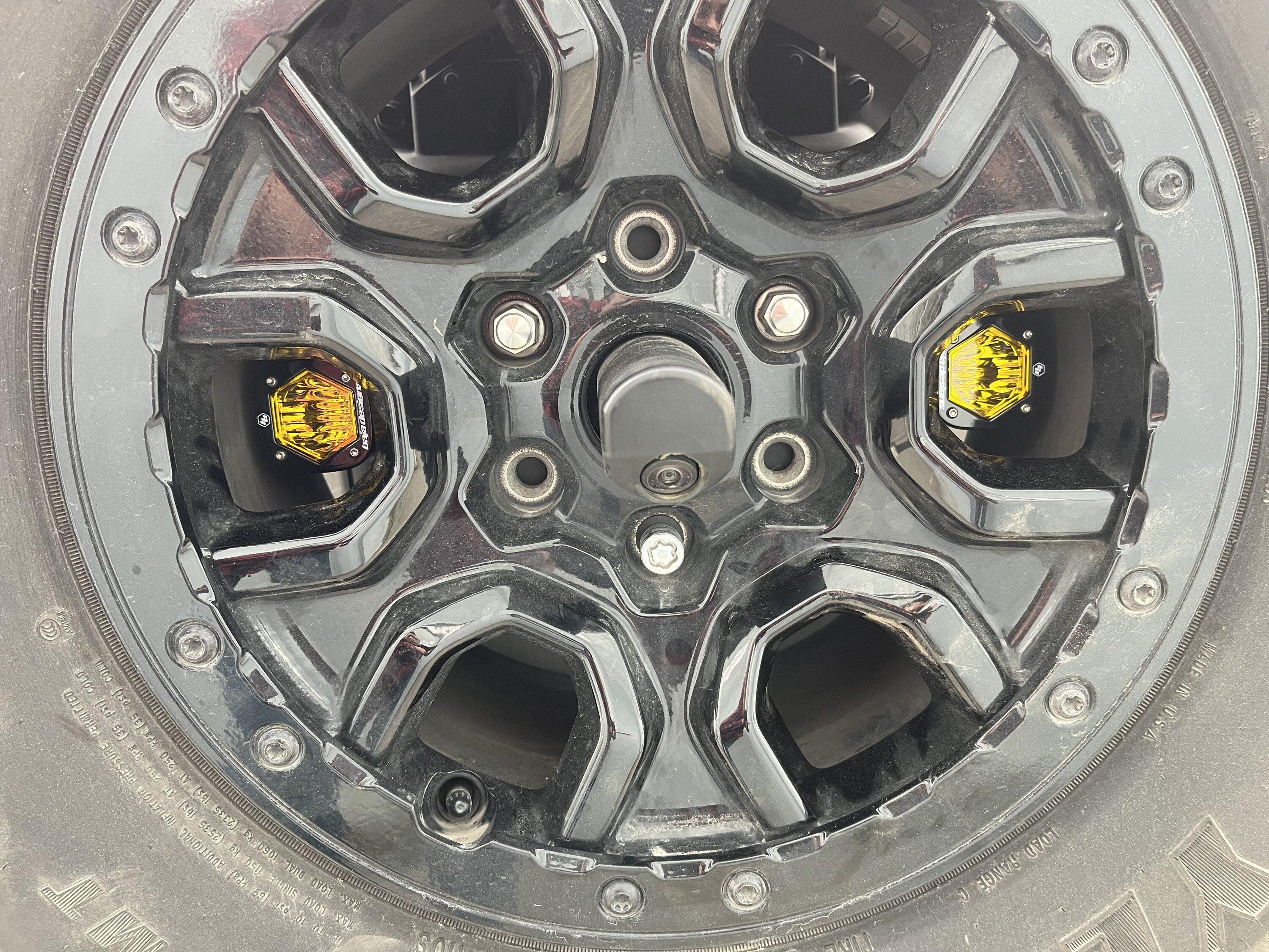

Rear Chase Lights:
I recently had installed a pair of amber chase lights. For this, I used the Baja Designs S1 Black LED Auxiliary Light Pod Pair (Amber - Wide Cornering) Chase Lights (Baja Designs Part # 387815) with a 12V GS-100C Flashing Module (From DZS ELEC). Big thank you to @Carbon Bronco for the module info to get the strobe feature I was looking for.
Below are some pictures of the setup, concealed behind the spare tire. No special bracket was needed, as the ones that came with the lights worked great. Very happy with how this turned out - Subtle, bright as heck, and a little more secure being behind a spare tire with a wheel lock.
Any questions, please ask away!

any pictures of this setup without the wheel,, im curious how did you mount them, thanks ! this is by far the best option for my needs good job man !

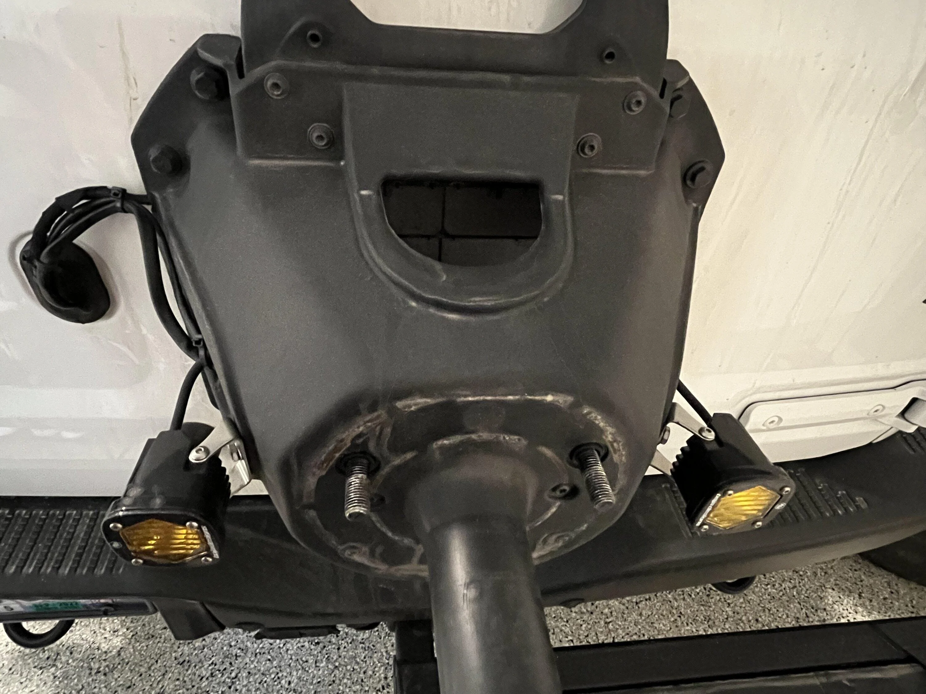

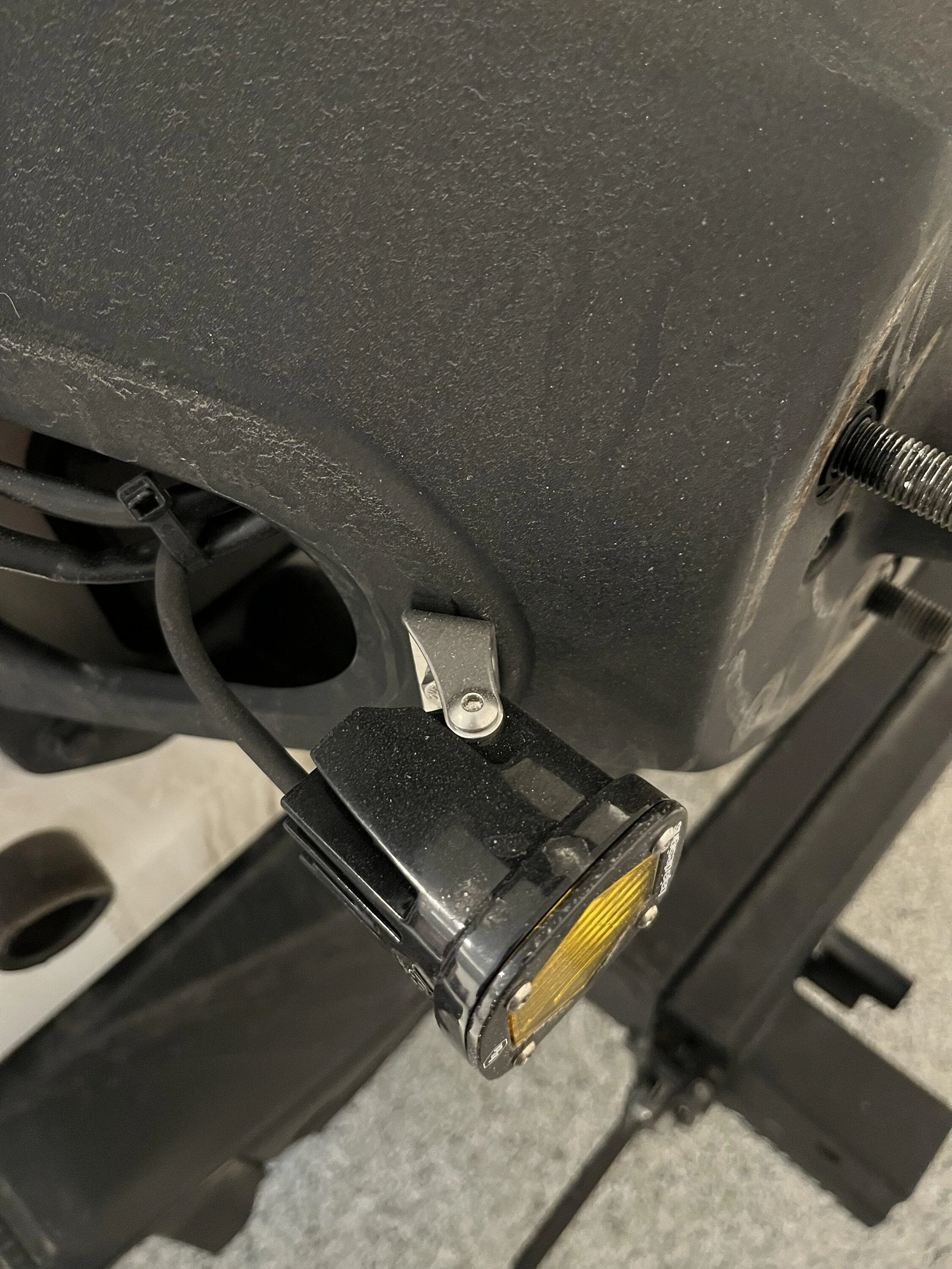

I had a few minutes now so here you go. Yes, a hole needed to be drilled on each side.
Ford Bronco 604Bronco’s Build Journal IMG_1118
Ford Bronco 604Bronco’s Build Journal IMG_1119
Ford Bronco 604Bronco’s Build Journal IMG_1120

this is Genius ! thank you so much i know removing the wheel is a pain in the ass, but you did it ! i owe you one !
