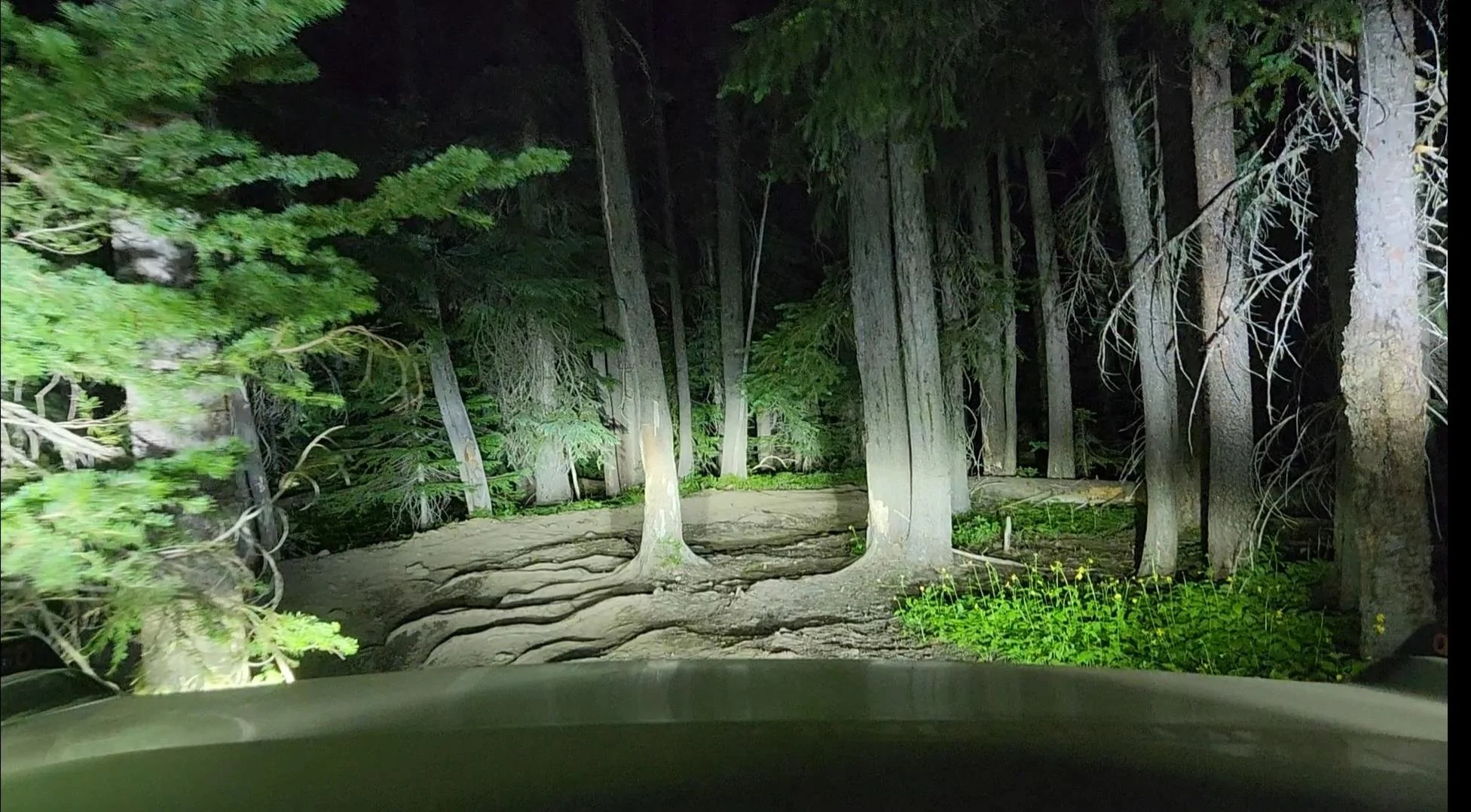

Forget about just keeping up... I am still trying to figure out how you managed to follow me (at night) down the sxs trail with no TTA... either you're a 4x4 magician.. or you rubbed a lot of trees (and hid all the evidence).. or you did a lot of 9-point turns back there... lol
Ford Bronco 7speed manual for off-road/crawling Screenshot_20220716-232110_Gallery
