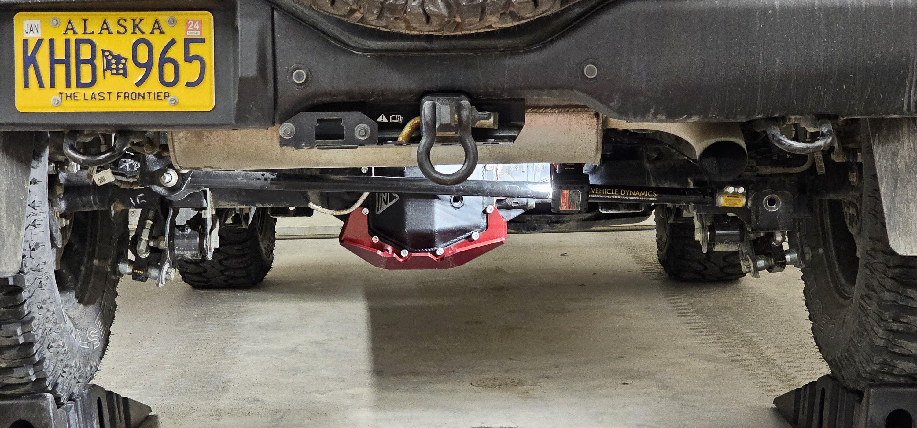

Next Venture shock and diff skids
Next Venture diff cover
Ronin oil drain valve

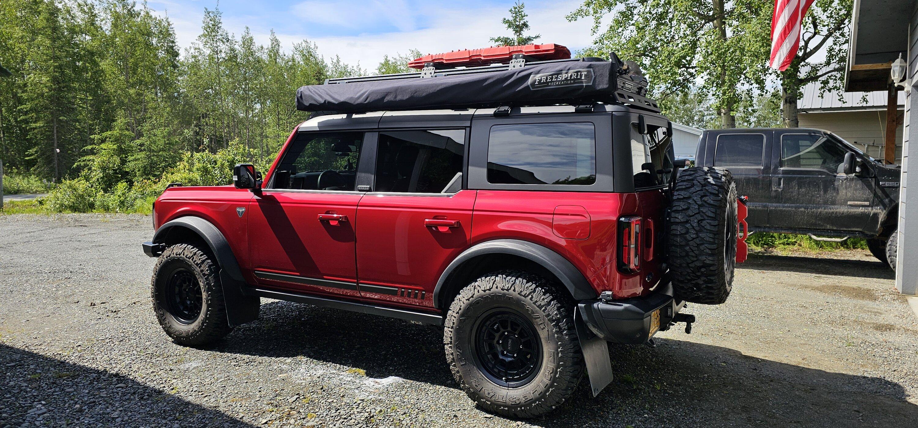

RCI roof rack
FSR 49" Odyssey w/ crossbars and ARB traction boards

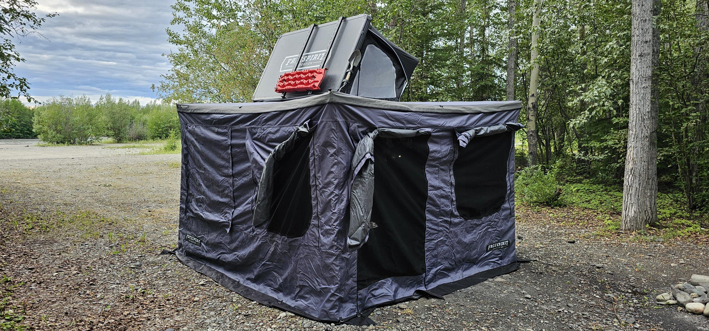

FSR Odyssey multifunction awning
FSR 270° awning w/ awning room

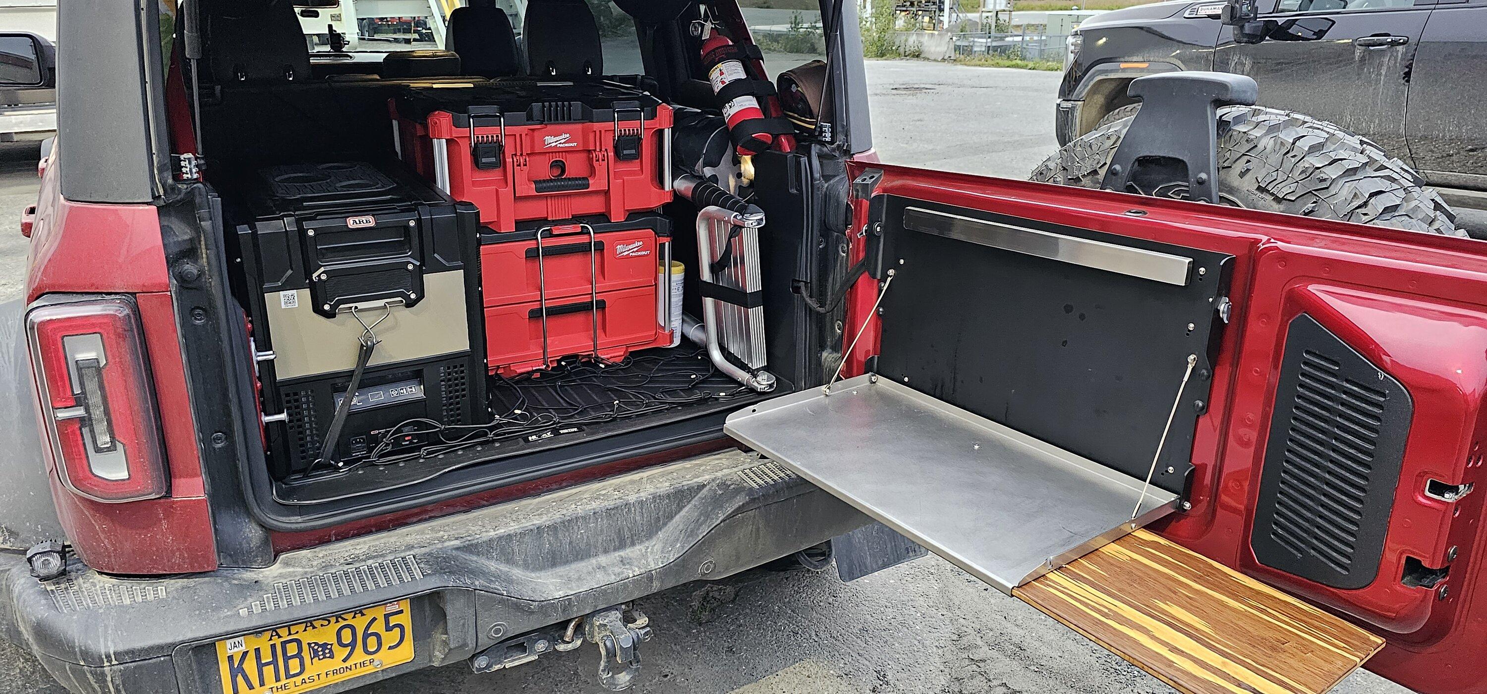

Trailgator tailgate table
ARB 47l fridge powered by a Goal Zero Yeti 1000

Milwaukee Packouts as a poor man's cargo system

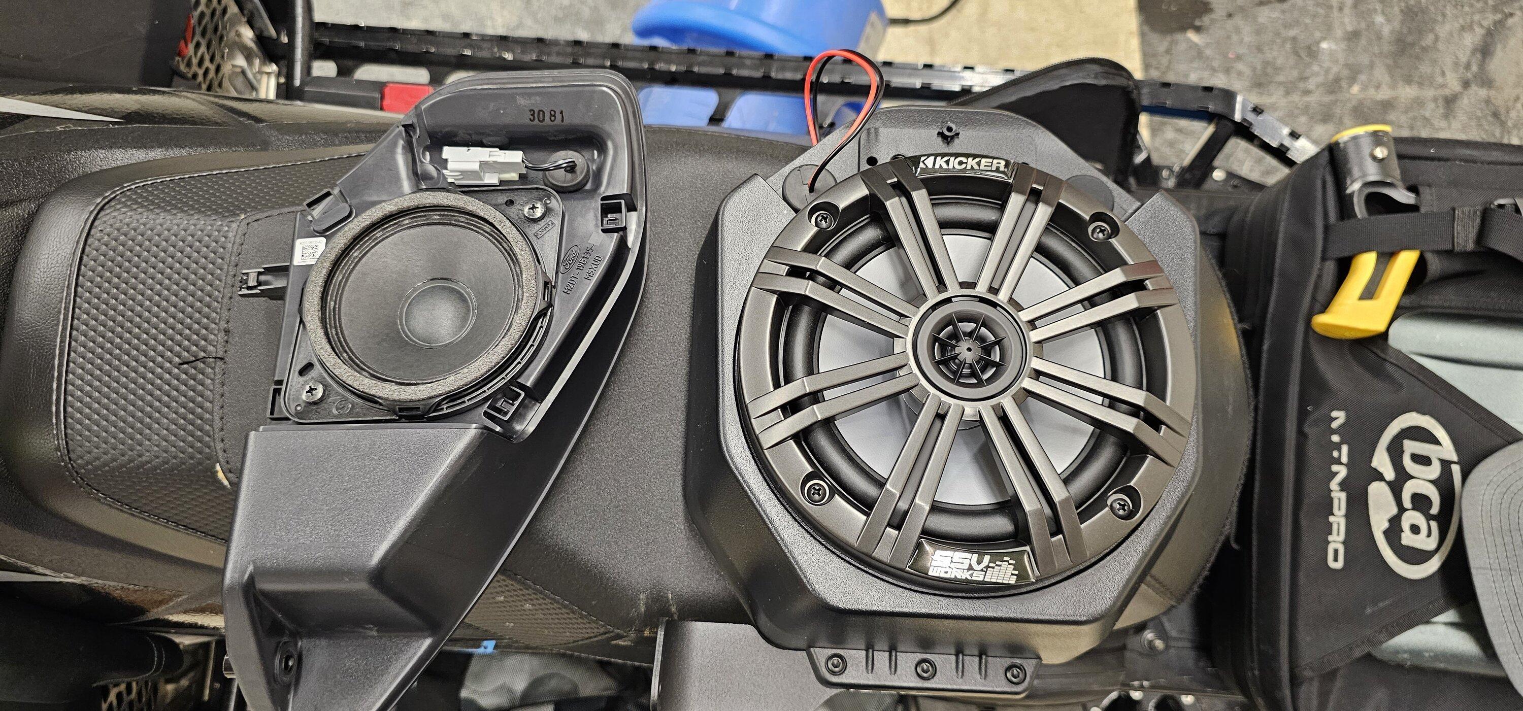

SSV Works rear speaker pods

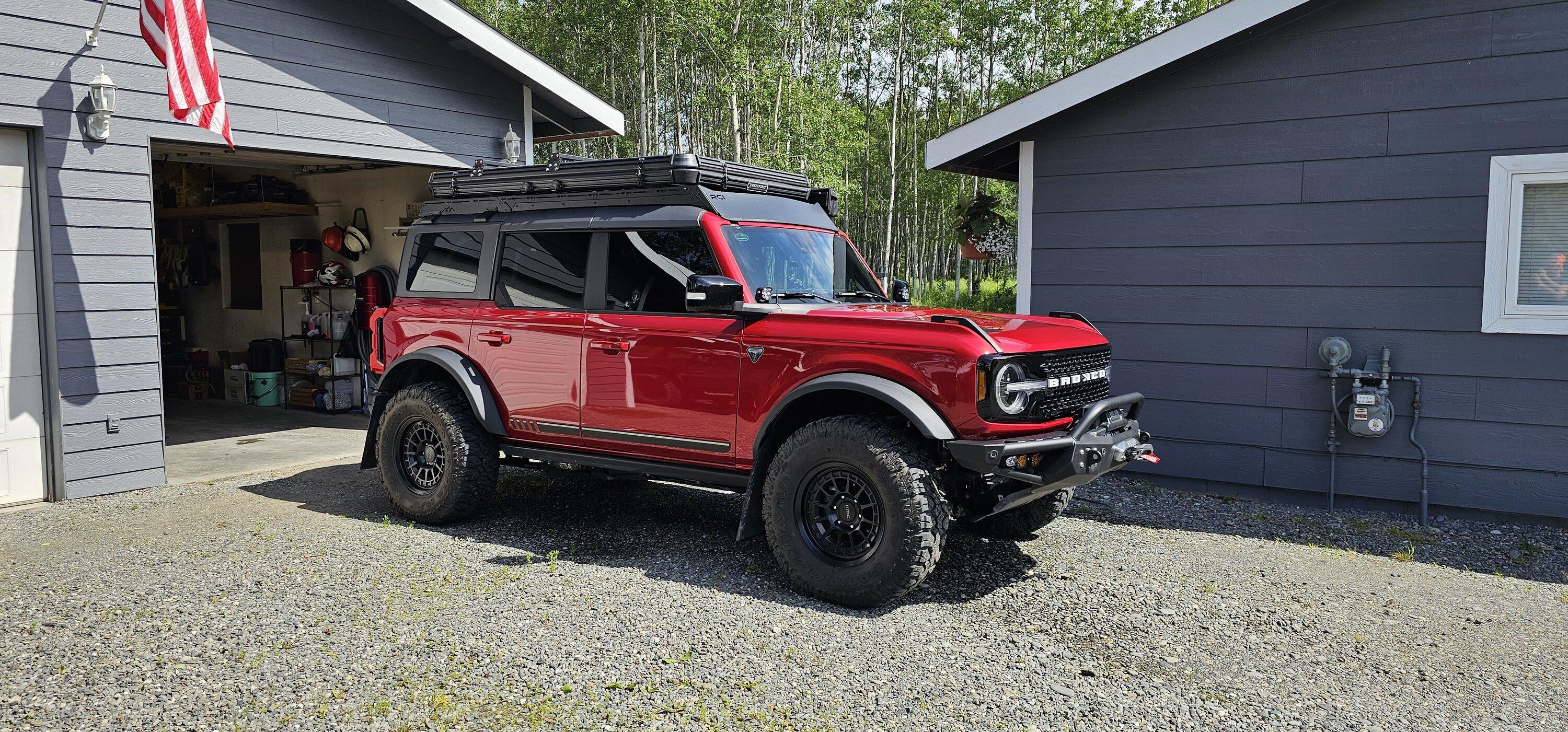

Do you have any of the roof sagging issues with the RCI rack? Middle panel looks a little angled which makes me think yes?

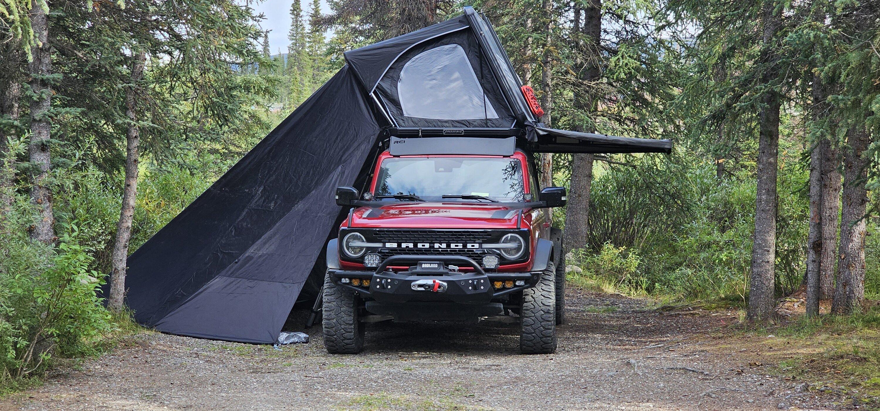

What brand is the Roof Top Tent?

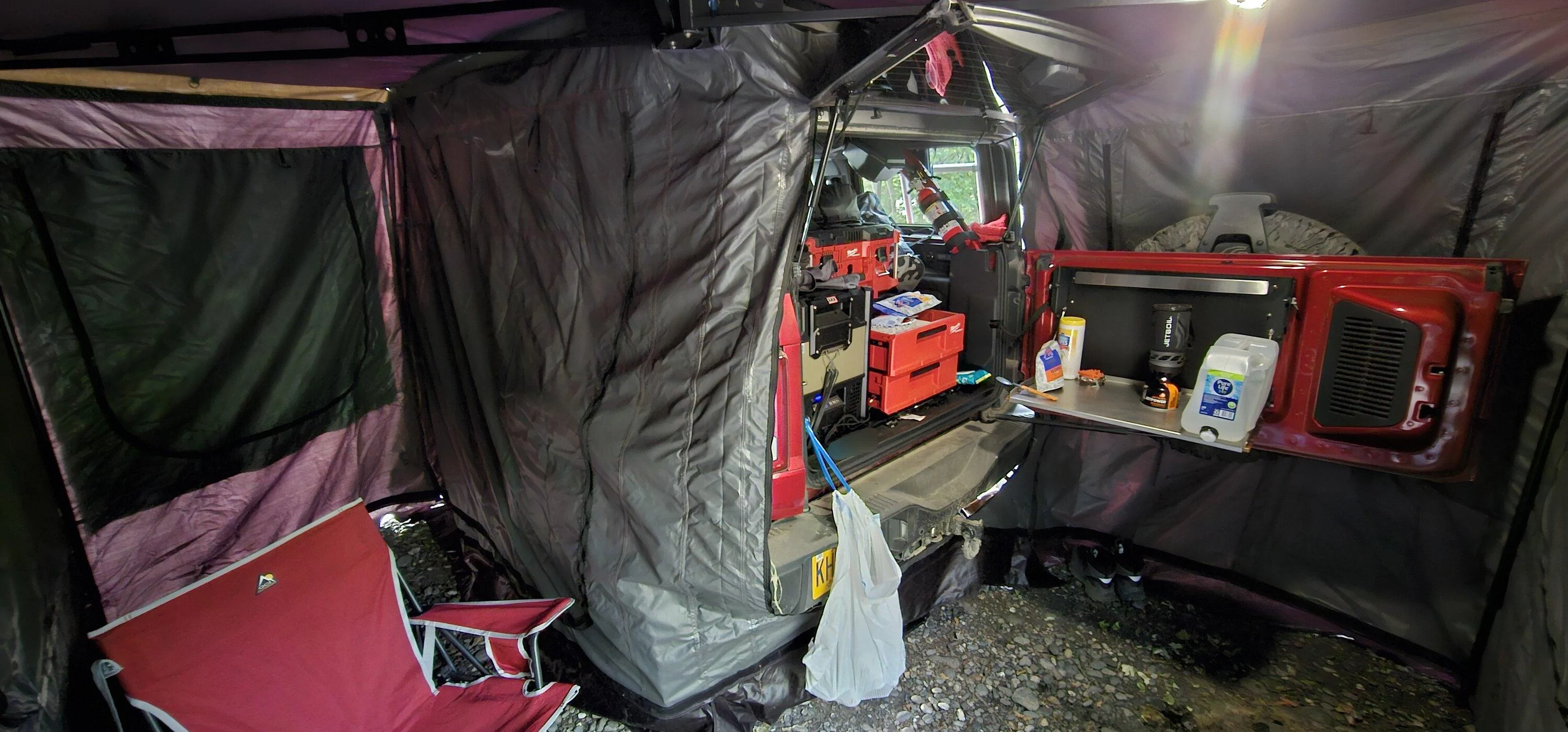

Any pictures of insides, including the external add on tents?

Yea very much so, it sags bad. That middle latch for the mid panel actually contacts the horizontal roll bar on bigger bumps.
Tried to order the JCR Roof reinforcements but their website wouldn't ship to AK and my email went unanswered. Keep forgetting to try them by phone.

FSR, Freespirit Recreation.

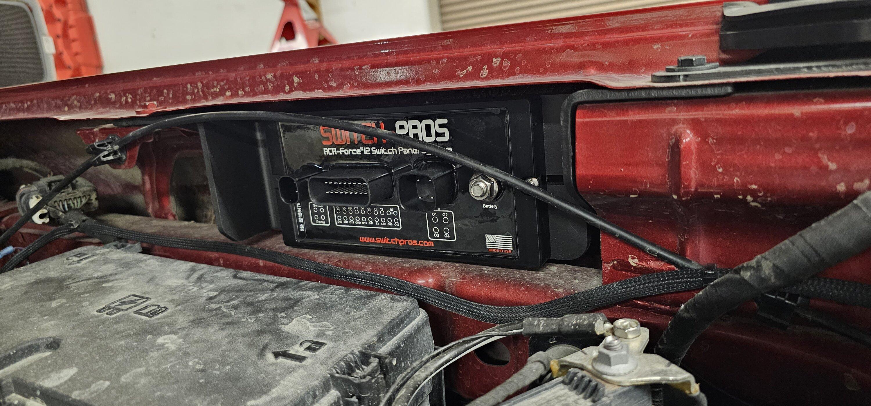

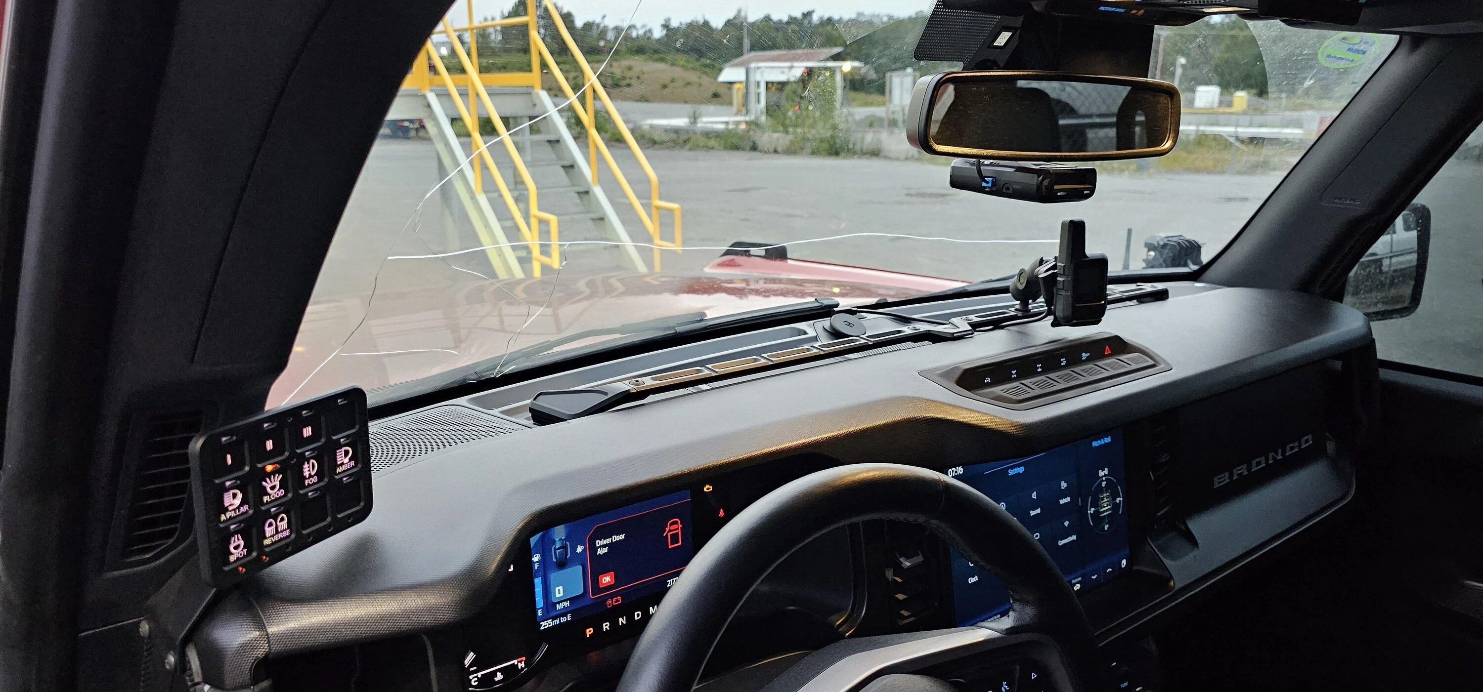

The Switch Pros is awesome though, love the thing. It all fit so nicely, works great and super customizable.
There are a LOT of wires there when the harnesses are plugged in.

I get it. I run a Feniex 4200 Mini on my Colorado, and it was a ton of wiring. Def not for the faint of heart.

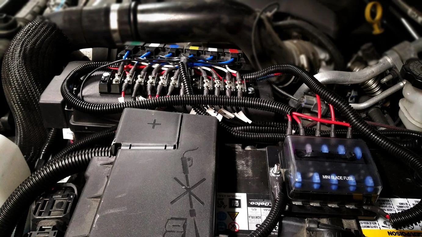

The reason SwitchPros are so expensive, turns this:
Ford Bronco AK Snows 2021 Bronco First Edition Build Thread 1693259920639
Into that clean unit recessed into a fenderwell that you have.
I also like that all the circuits are flashers.
On the Feniex, only circuits 1 and 2 flash, which works for my use in plowing.
I'm pretty sure you could get the PakRax kit from Trailrax and modify the RCI rack (drill holes) to alleviate the sag.

Where did you get the mount for the Switchpros solid state board in the engine bay?
I used an old Tacoma mount for mine.
Also, if you're willing to give up the OEM AUX switches, I used the
SDHQ mount for the control panel to replace the AUX switches altogether. Was never a fan of the wiring on the AUX so I re-did all of that while doing the swap.

Switchpros sells a Bronco install kit. It comes with the fender bracket, a bracket to mount the switch unit to the drivers grab handle, and an appropriate length comm cable.
