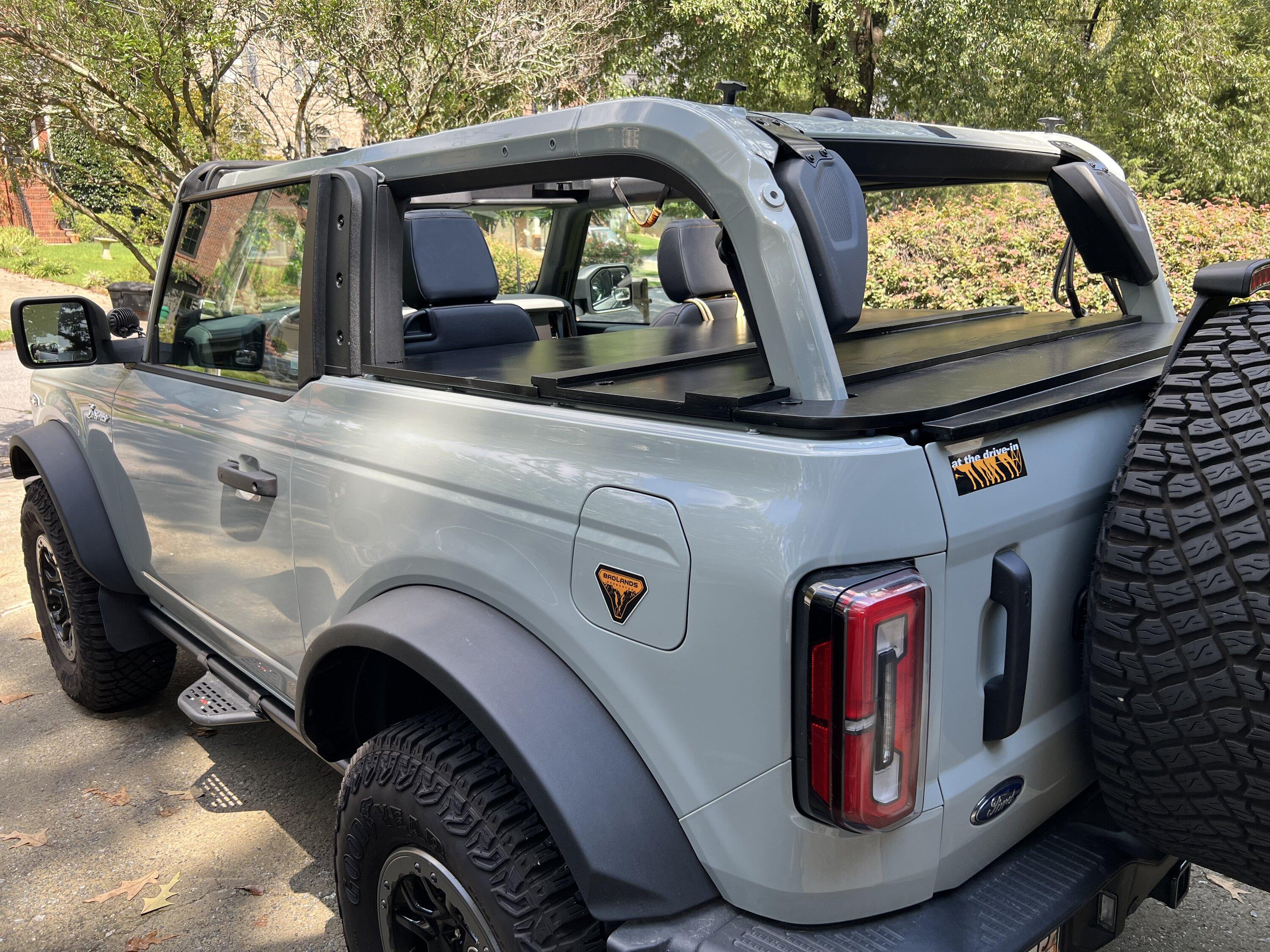

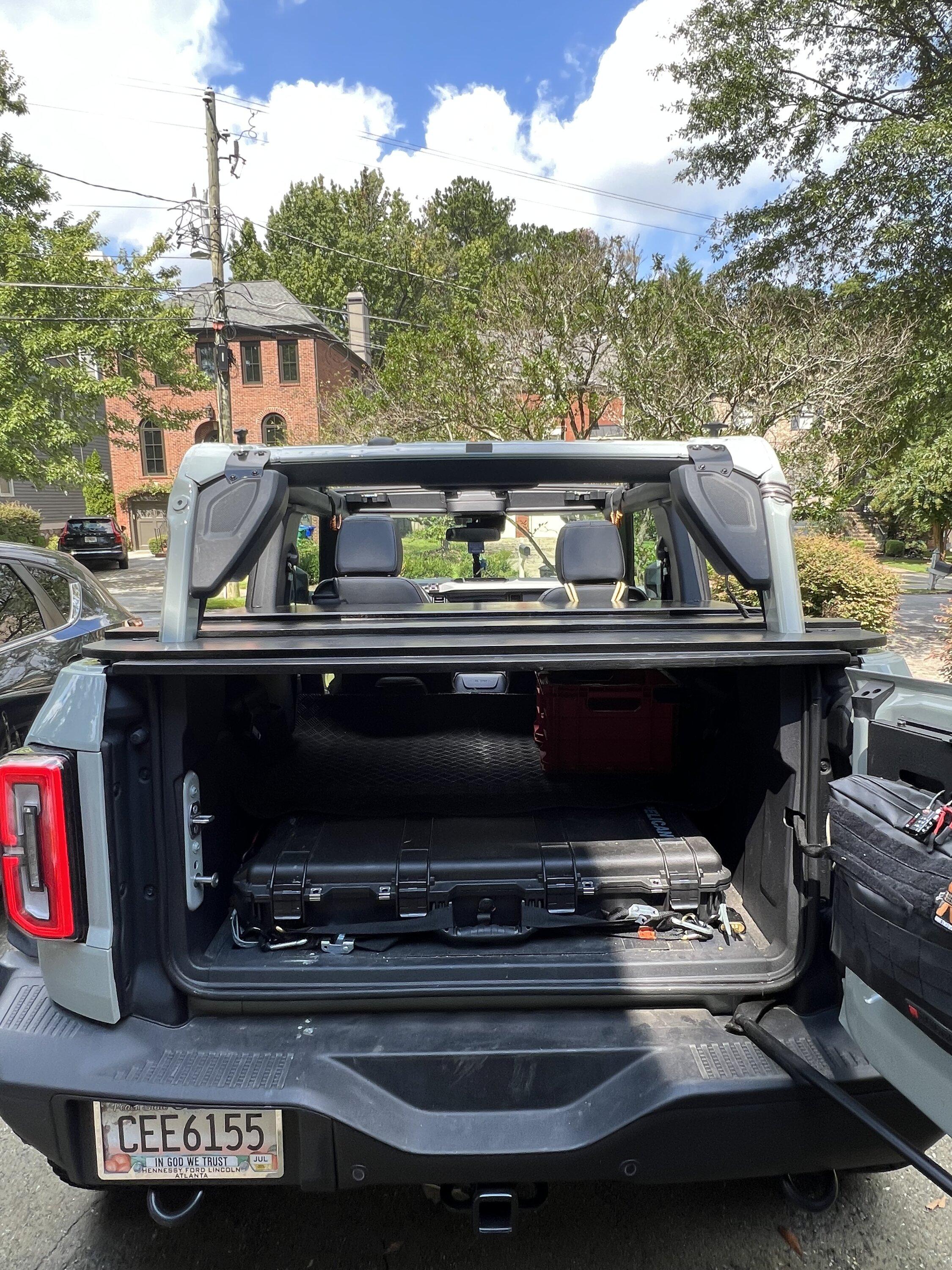

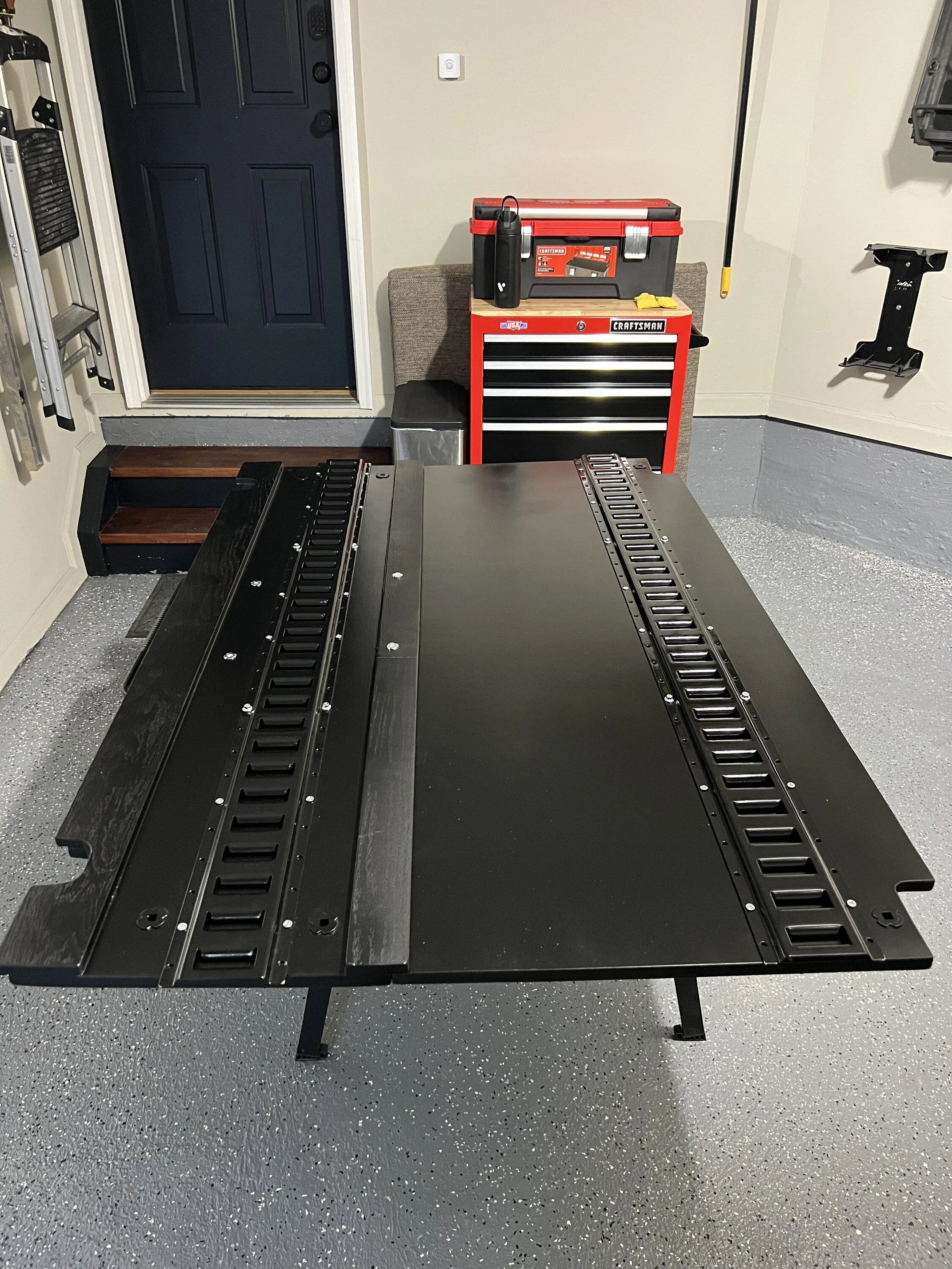

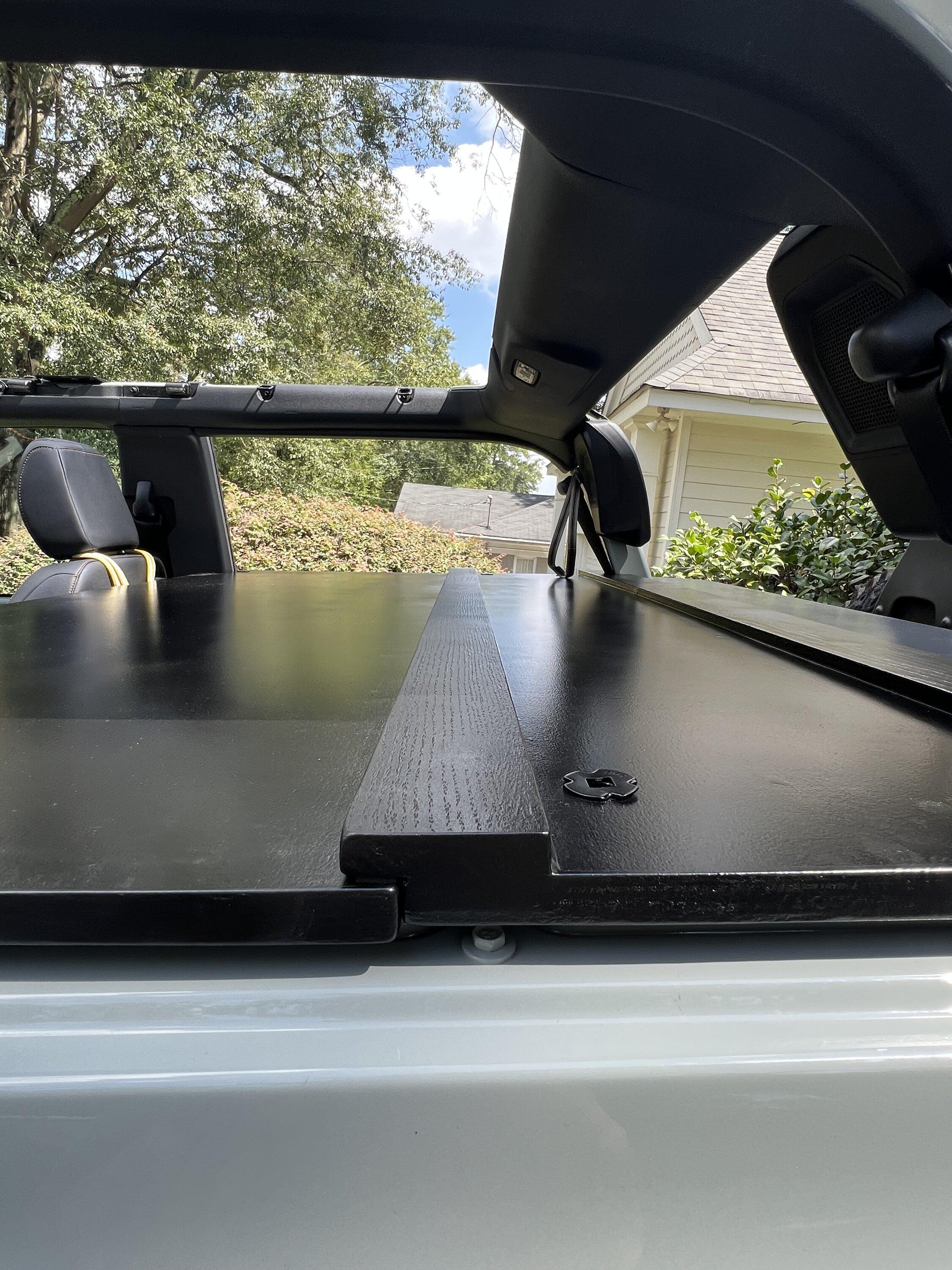

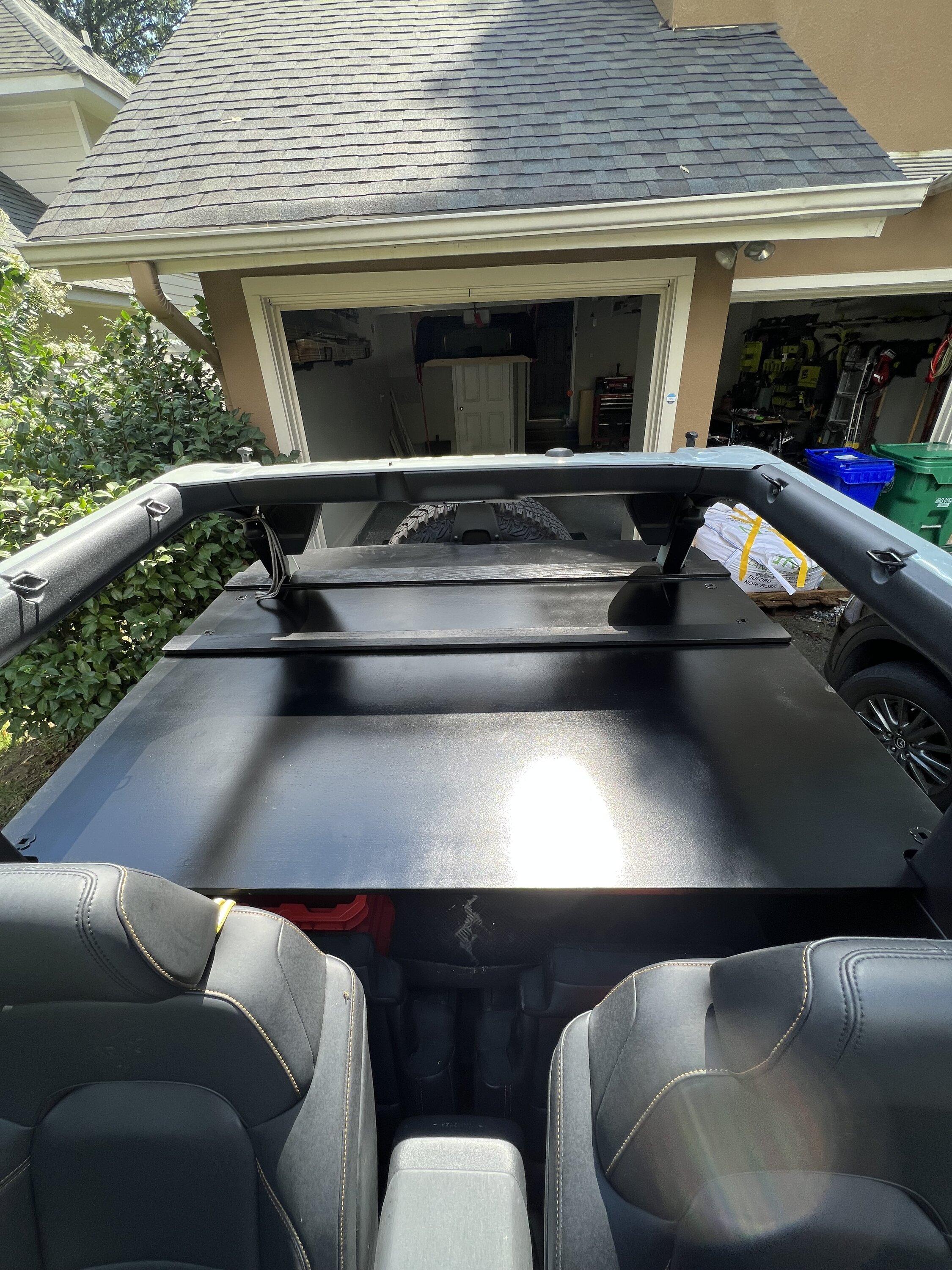

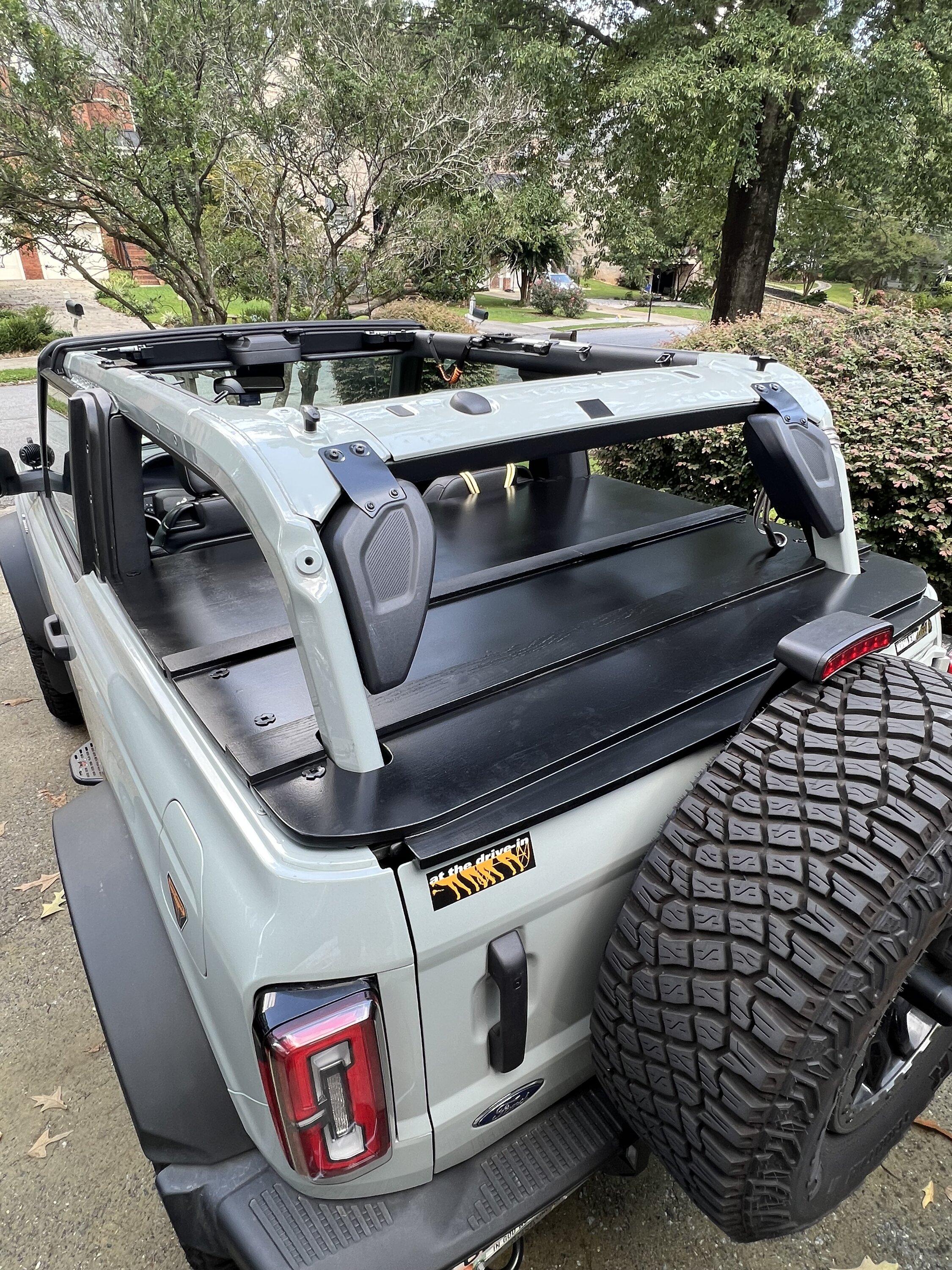

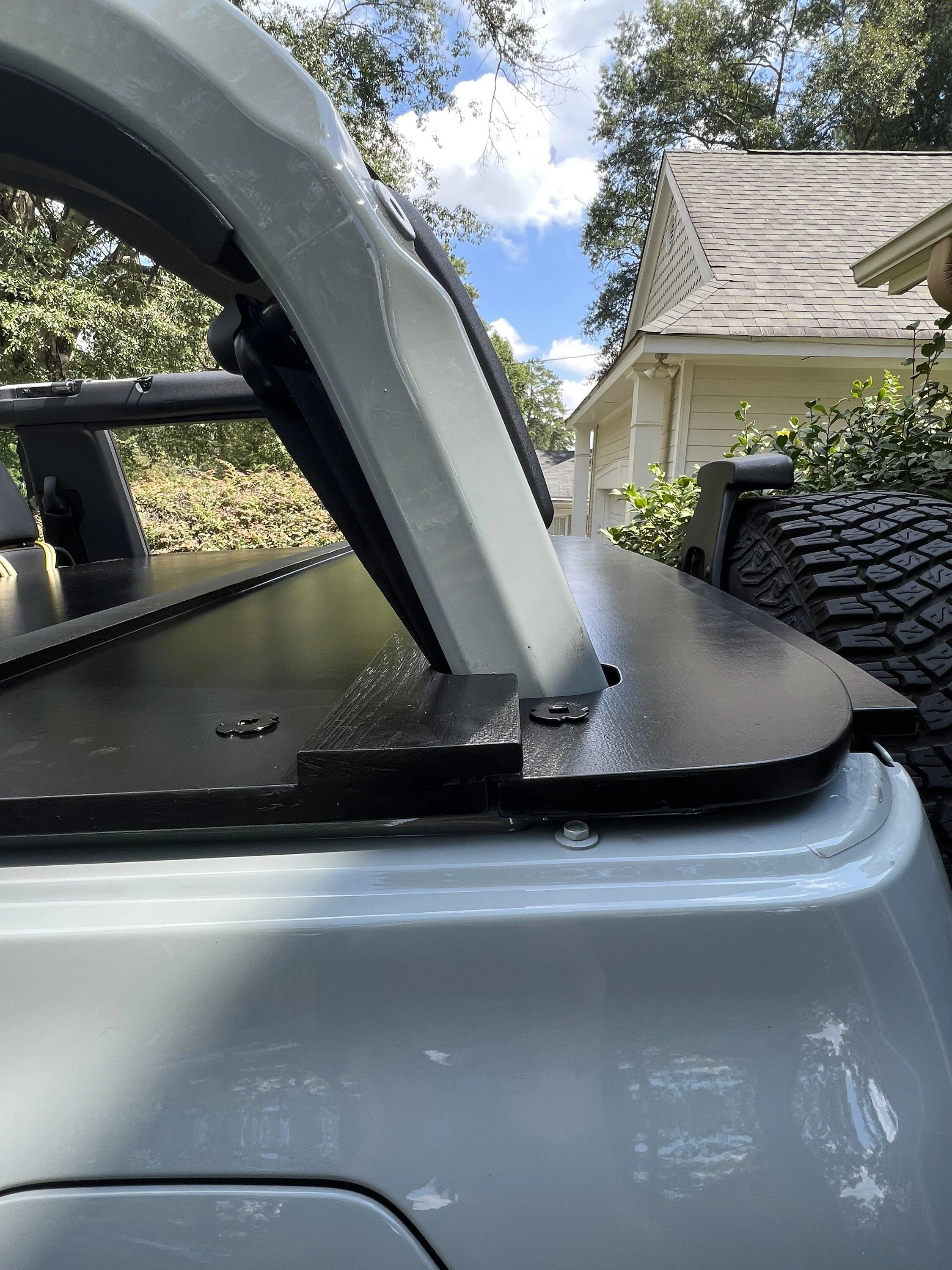

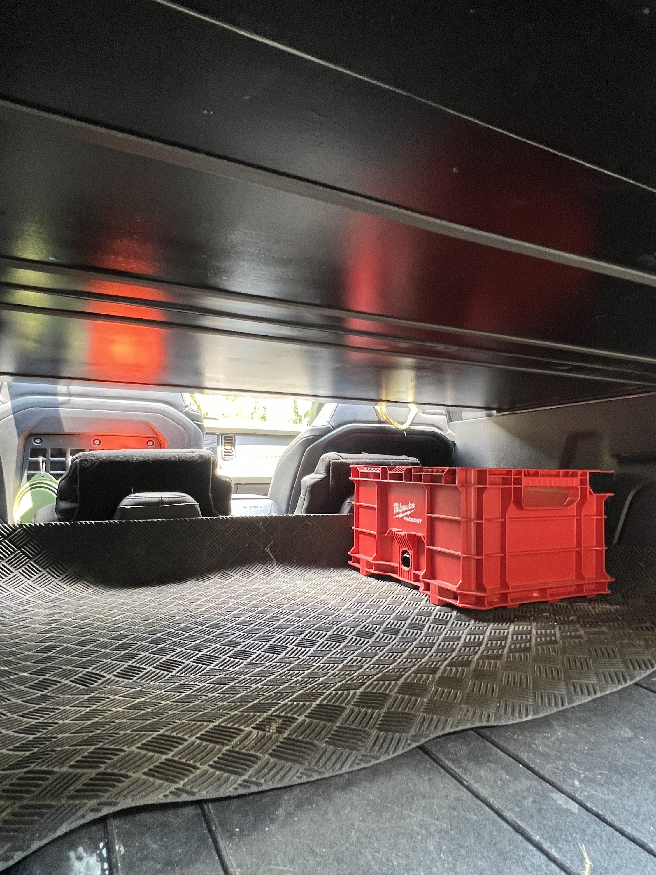

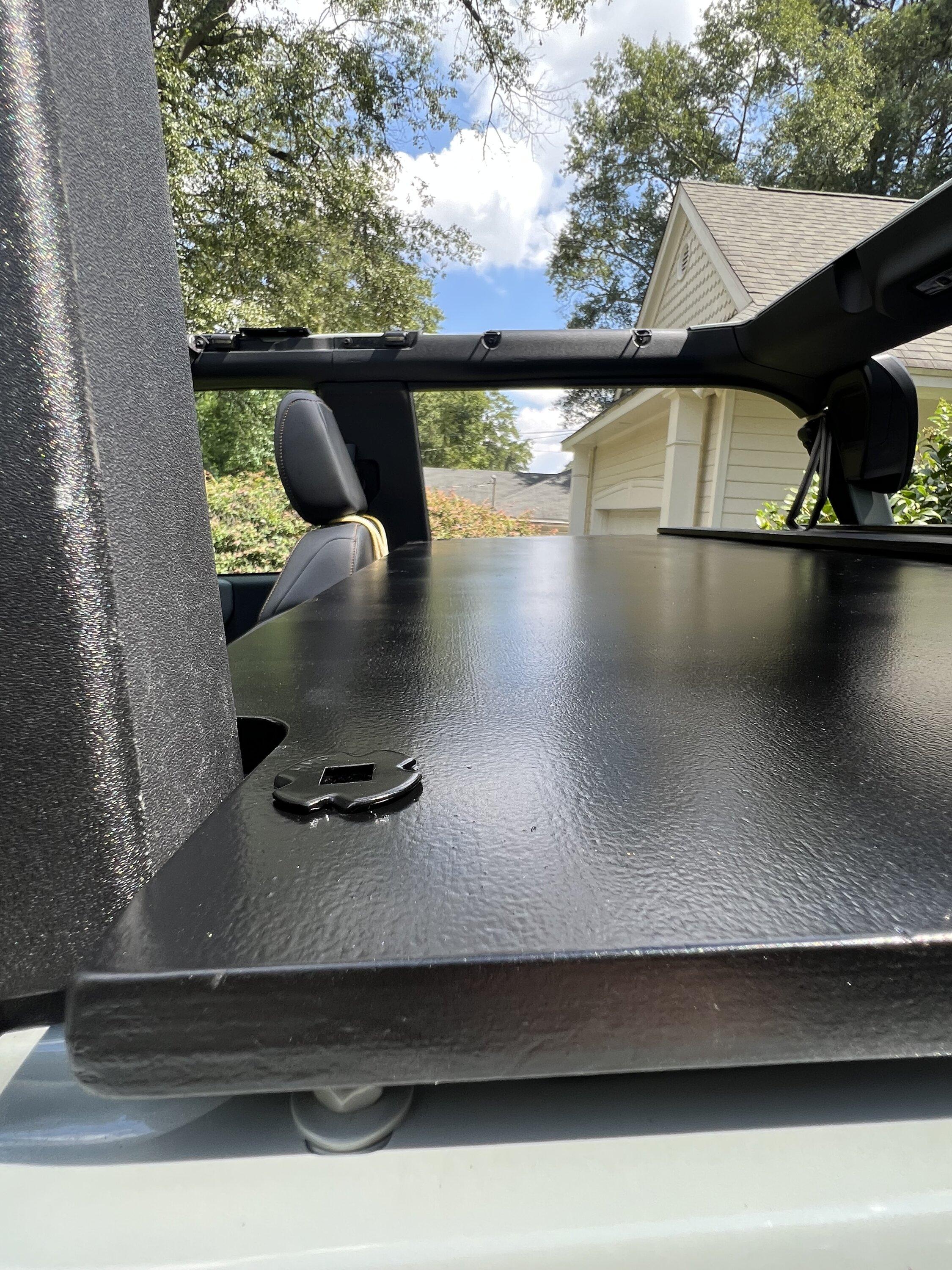

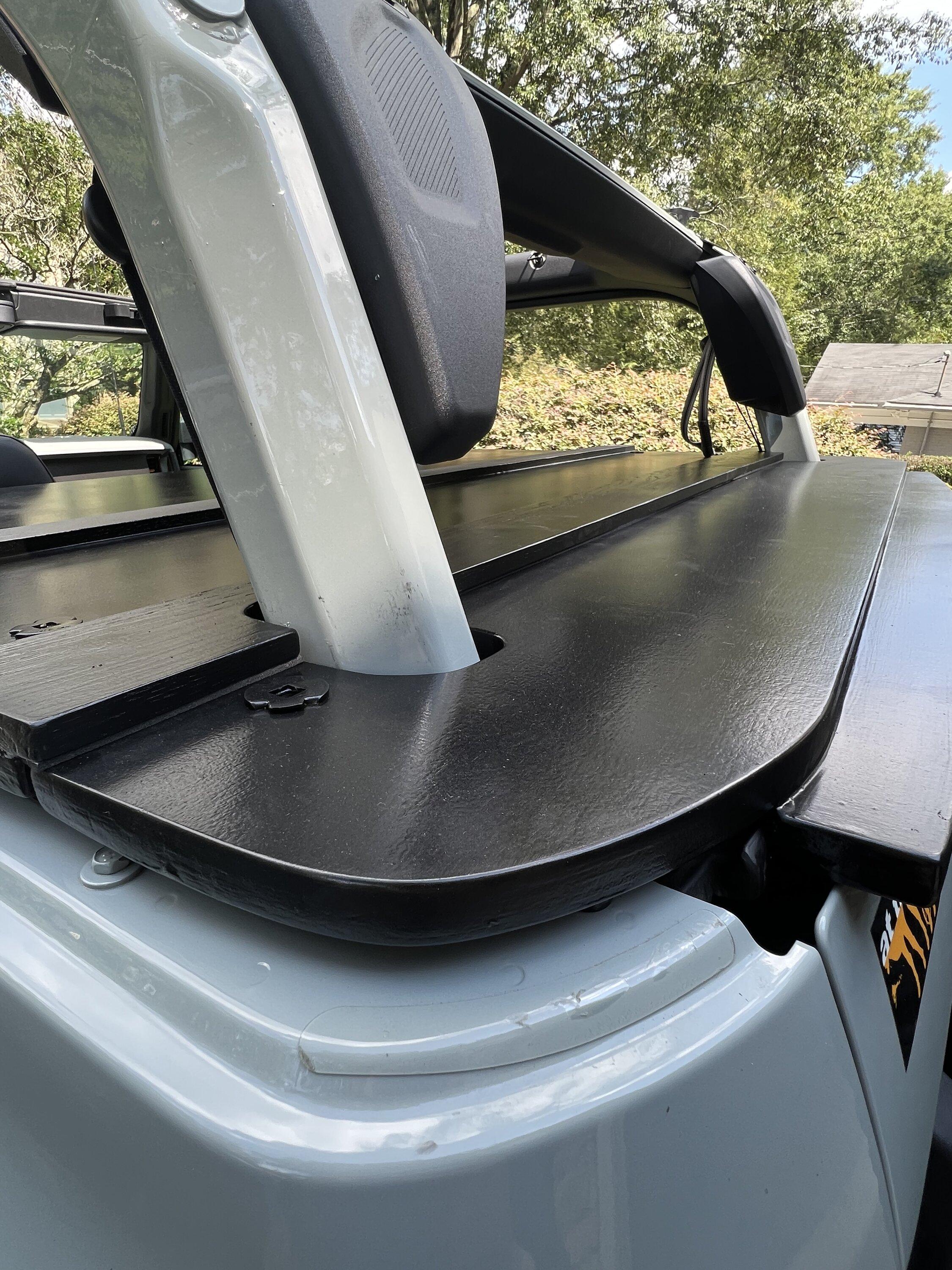

Gonna be honest, I improvised a lot, so I can’t really share a helpful step by step.
It’s made out of plywood, wood filler, spray paint, weather stripping, a jigsaw, and lots of sandpaper.
The cover attaches to the bronco using the same mounting points as the hard top, but I had to buy longer bolts to account for the 3/4” plywood. I made it 3 separate pieces to reduce the weight of each panel and make the installation easier, but could be done as 2 pieces.
There’s weather stripping where the panels meet and on the underside to protect the bronco. It should also help keep rain out of the cargo area; I’ll report back on that.
I was still waiting on the bolts to arrive when I took these photos, so it’s not bolted down. I’ve also improved its rigidity with additional bracing and some E-Track rails. I’m very happy with it.
More installed photos to come!

Hey man, that looks really clean and reminds me of how I saw 60's Broncos jeeps and Scouts as a kid. people made what they wanted to do with them.
Looks nice ... gives me ideas!!

Nicely done. I made something similar, but in 2 pieces, and not nearly as carefully crafted. I didn't bother with any weatherproofing. Mine was made primarily for a minimal security system to prevent somebody from grabbing my golf clubs when the top is off.
For anyone else making a hard tonneau cover, if you want to try to match the curve of the tailgate, it's approximately a 20'6" radius. Good luck - you'll need it. I should have just traced it and used a template.

Can't tell, but does it have a bulkhead at the seats? That would be nice as a full enclosure that could be open or closed at will.

Is that a Bronco Door mounting bracket on the wall to the right of the tool cabinet? If so - how do you like it?
