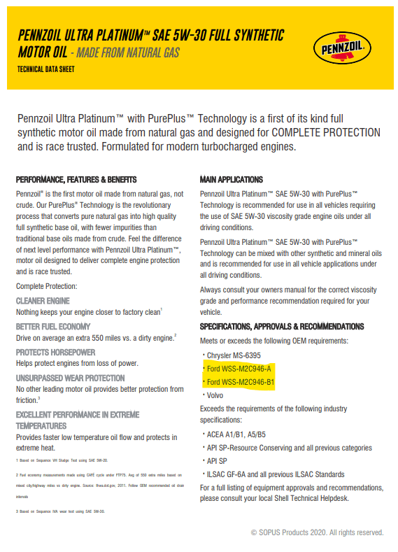

Updated with @CarbonSteel's great 5W-30 compilation list:
Here are all of the 0W-30 and 5W-30 commonly available oils there are on the market that I could find that are "comparable to Motorcraft". Last I checked, Phillips 66 made Motorcraft oil.
NOTE - many of these oils have statements like "Recommended For" or "Meets Requirements Of" and this is not necessarily the same as "Approved", just keep that in mind if warranties are a concern.
The sheet has comment permissions so if you see one I missed or see an error, feel free to comment.
__________________________
Original post by @telenerd
For those wanting to know what alternative oils meet the Ford Specs (WSS-M2C961-A1) according to the service manual Ive started on a list. Please reply to thread if you see something missing! One stop shop. Yes another oil thread!
  1. Valvoline Advanced Full Synthetic SAE 5W-30
  2. CASTROL GTX FULL SYNTHETIC 5W-30
  3. Amsoil OE 5w-30
  4. Mobil 1 Advanced Full Synthetic 5w-30
  5. Pennzoil Platinum Full Synthetic 5w-30
  6. Motul 8100 Ecolite 5w-30
  7. Quaker State Full Synthetic
  8. Kirkland Signature Full Synthetic 5W-30

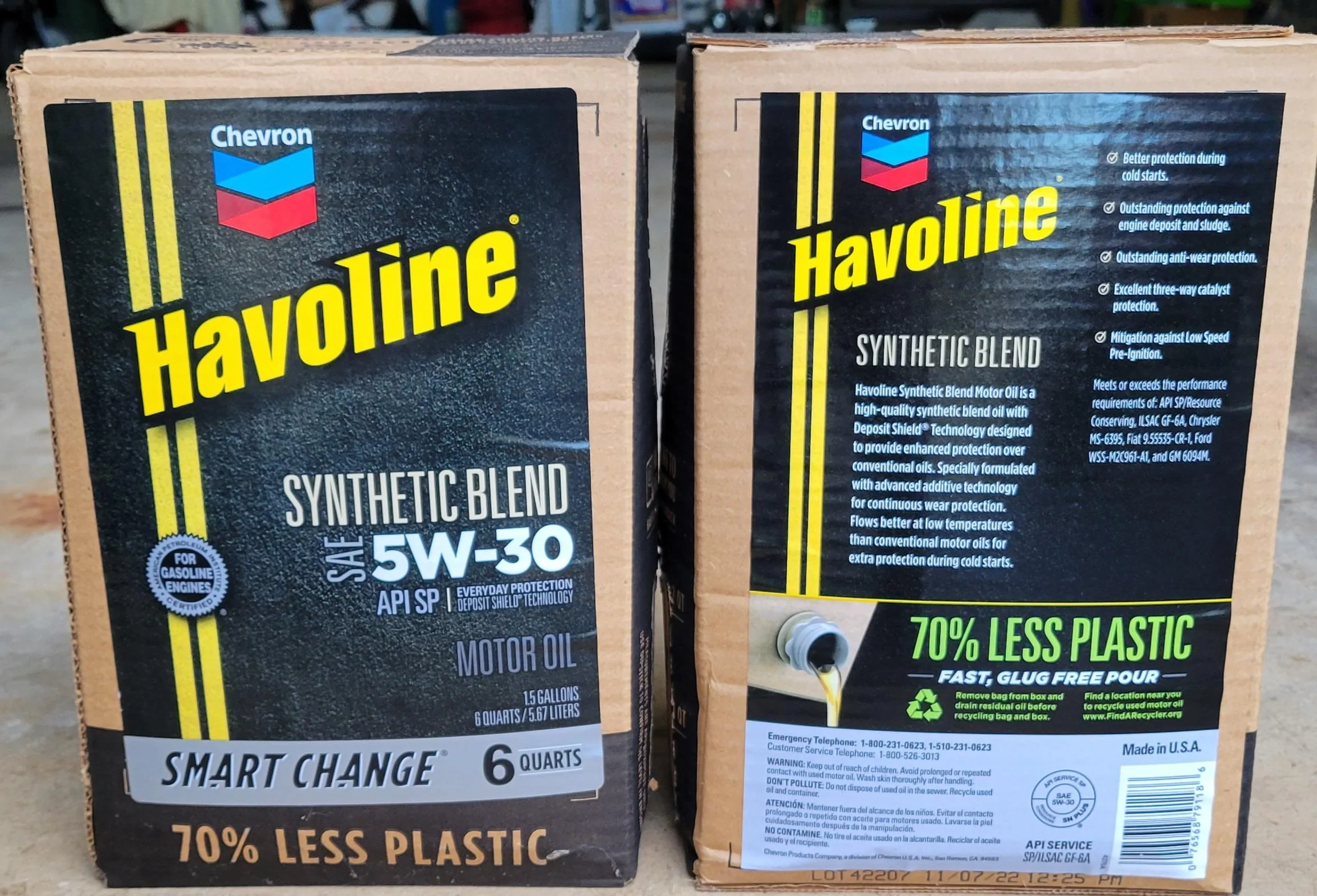

  9. Havoline Synthetic Blend
