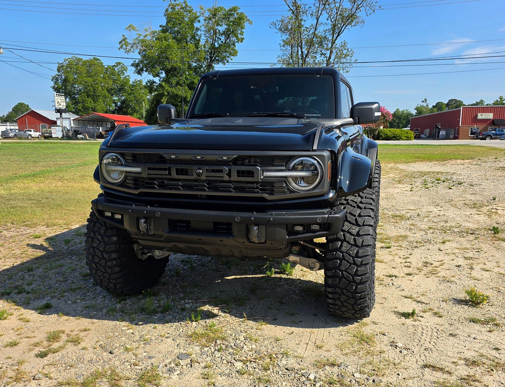

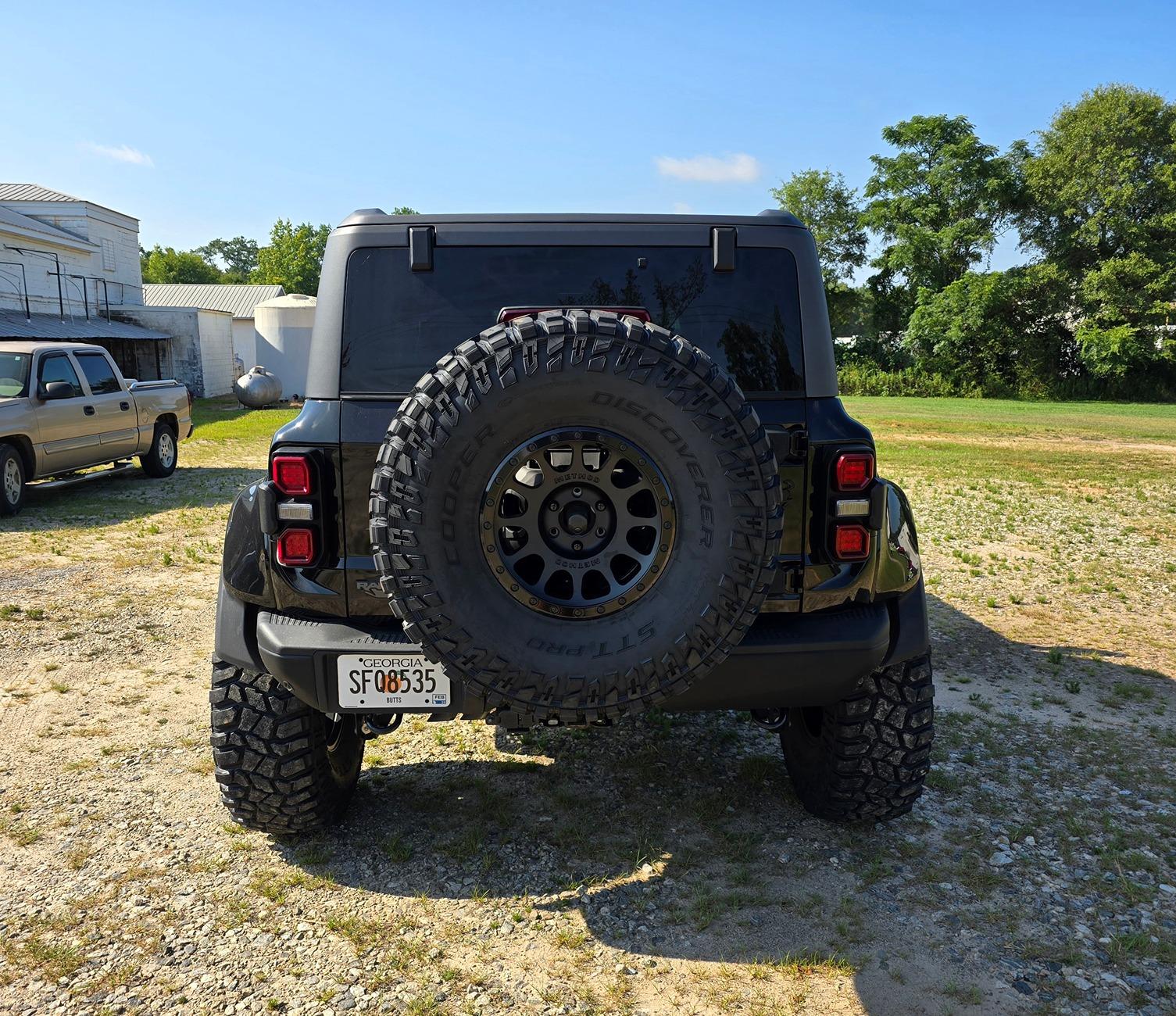

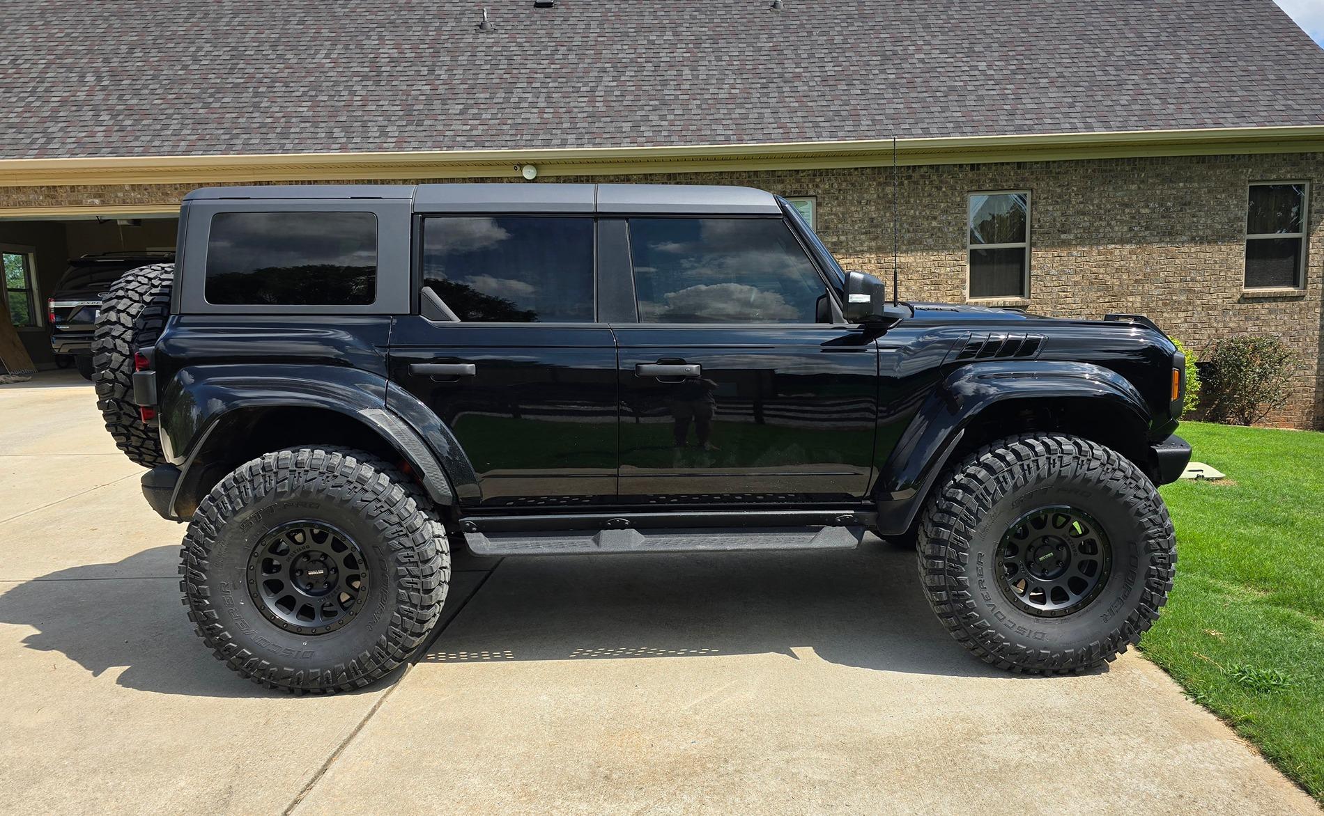

I installed the 2.25" rpg collars up front with the 1.5" in the rear. Install was about what I expected. I did them with some spring compressors while leaving the coilovers on the bronco. There's not much room to work with in the front, but the rears were very easy.
40x13.5x17 cooper stt pros on method 305's in double black with 0mm offset.
Removed the little plastic "fins" on the sides of the front bumper and there's no rubbing under normal driving.

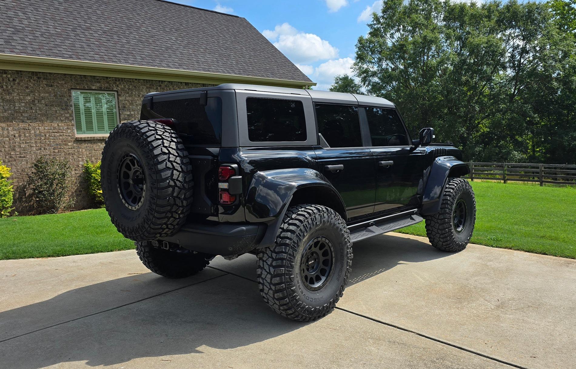

Yeah I was thinking the back of the rear fenders will be an issue first, especially with the rear suspension being so soft.
I know it looks like the rear mudflaps will make contact first. Also though if you push on the mudflap you could pin it back for a tad more clearance.
I'll probably flex it out in the fields at my house and see how close it is.

Did you happen to measure how much actual lift you got from the collars? I am Looking to do the same and you got your stance nice and level. My situation has the added change/weight of a winch on the front, stock Modular bumper with the JCR high mount winch plate and PreRunner Hoop. So I’ve been debating on how much extra collar I need on the front to account for the added weight/rake created by the extra 100lbs on the front bumper.
I blew a front flare off that way, hit the mudflap, doesnt take much and its a harder hit than you think.
