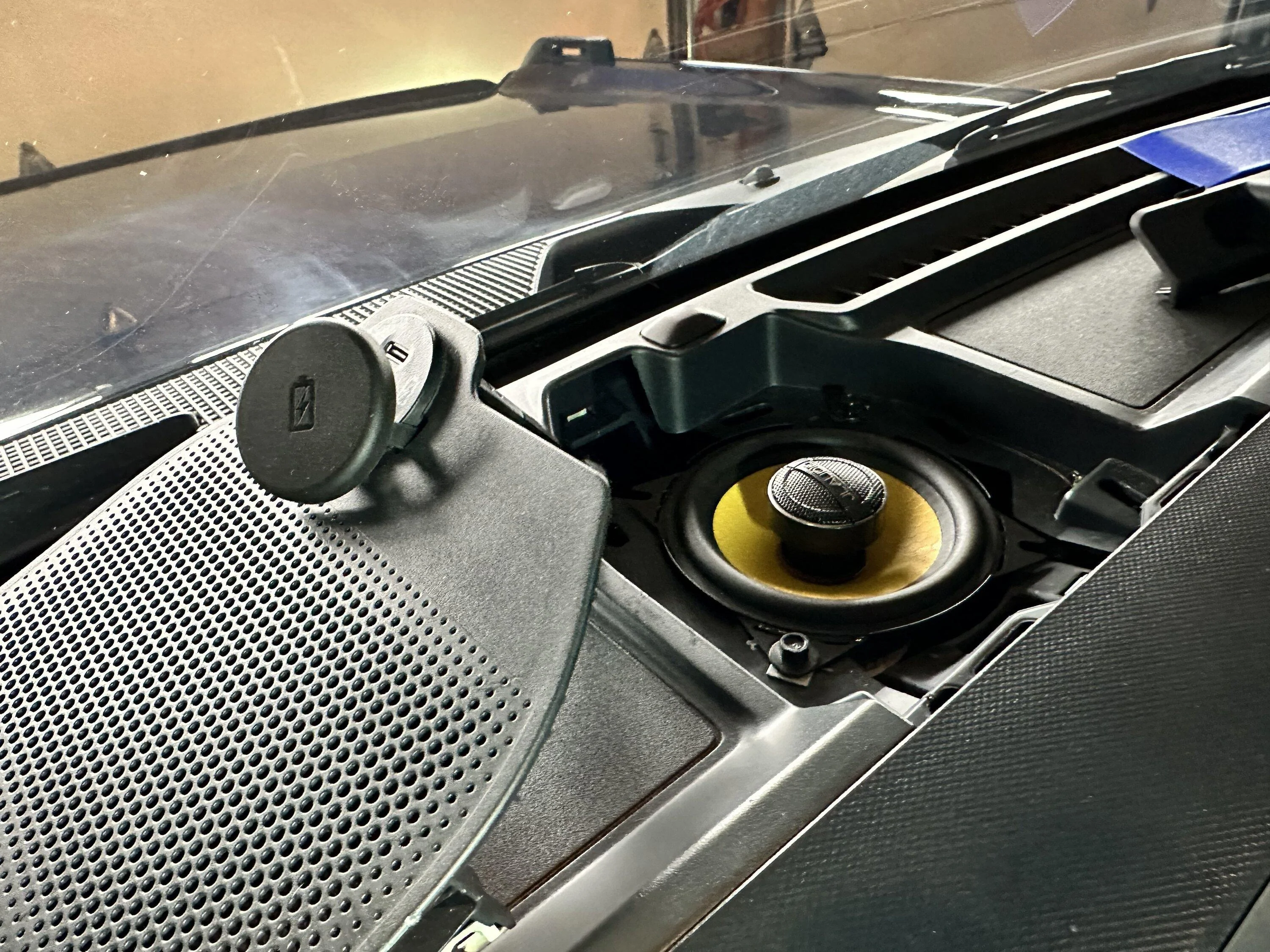

No clearance issue, you just need to plug in the speaker to the adapter first, tuck the adapter in, and then twist the speaker from side to side until the clears the plastic edges to sit flush and screw down. No issue with new speaker touching the cover either after install.

Did you have any clearance issues with the grille when you put it back on? I see where Crutchfield says this speaker won't work in the dash corners due to height. Any issue there with grille? Still got the single speaker?
Thanks!
Doesn't even come close to hitting.
I was reading that changing the speakers dont make a huge difference unless the amp is upgraded also? Are you guys doing both or finding good results just doing the speakers?
No amp required.
Huge difference in sound going to the JL C1 Line.
