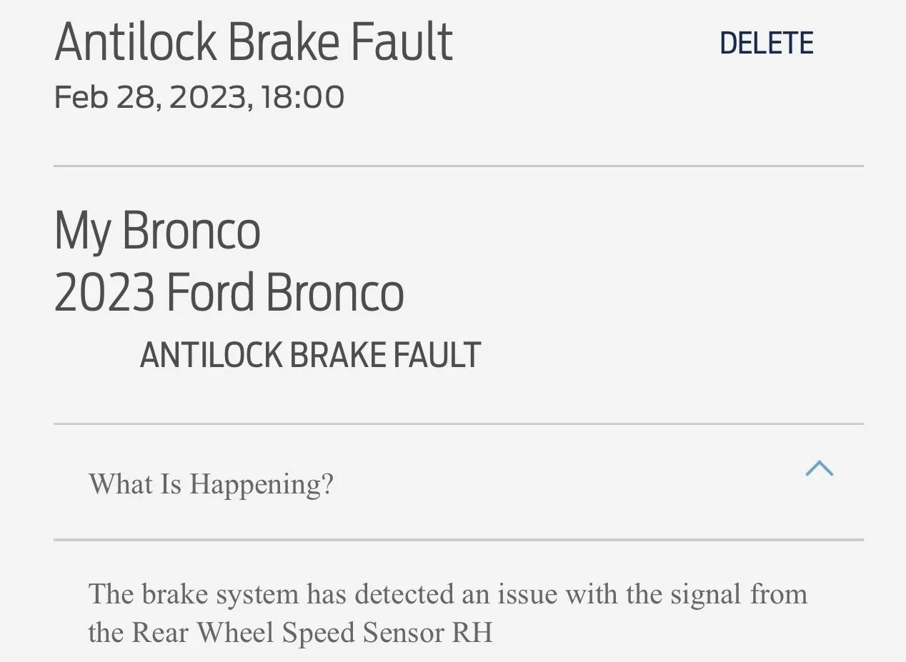

I just got RH Rear speed sensor fault @1235 miles , driving normal on road about 55 mph .
going to check bolts and connections when it cools off .
