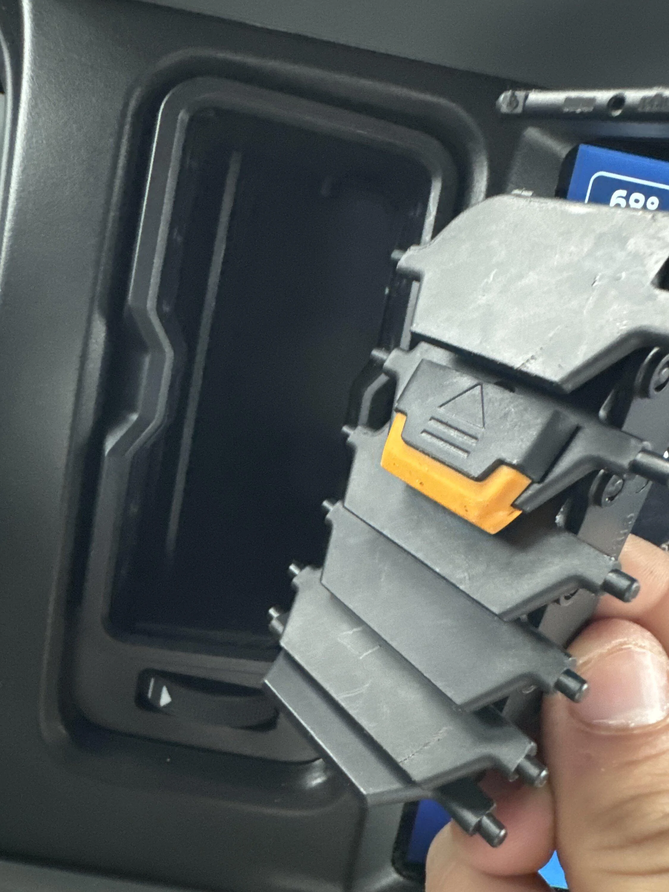

Hi anyone ever have this problem I can’t put it back without pieces flying off

Must take whole unit out and put in from backside - sort of. The body comes apart and the vents go in. This is based on dealing with this in multiple brands of cars. Patience is the key, but again, must get the main body out. -R
Ford Bronco Ac vents falling out image
Here you go. I changed the color of mine so this video should help you.

If make sure you aren't missing the top/bottom gaskets

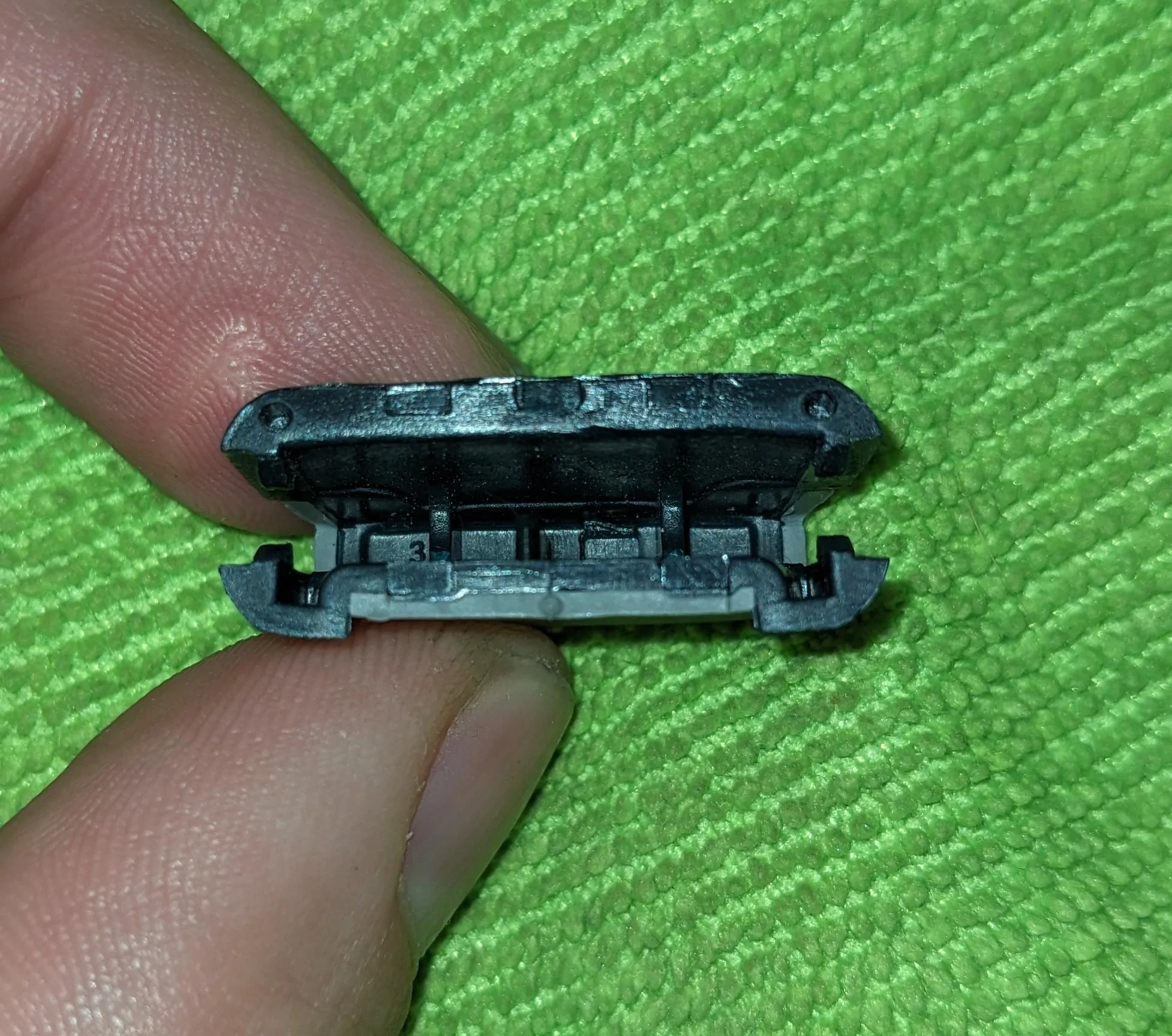

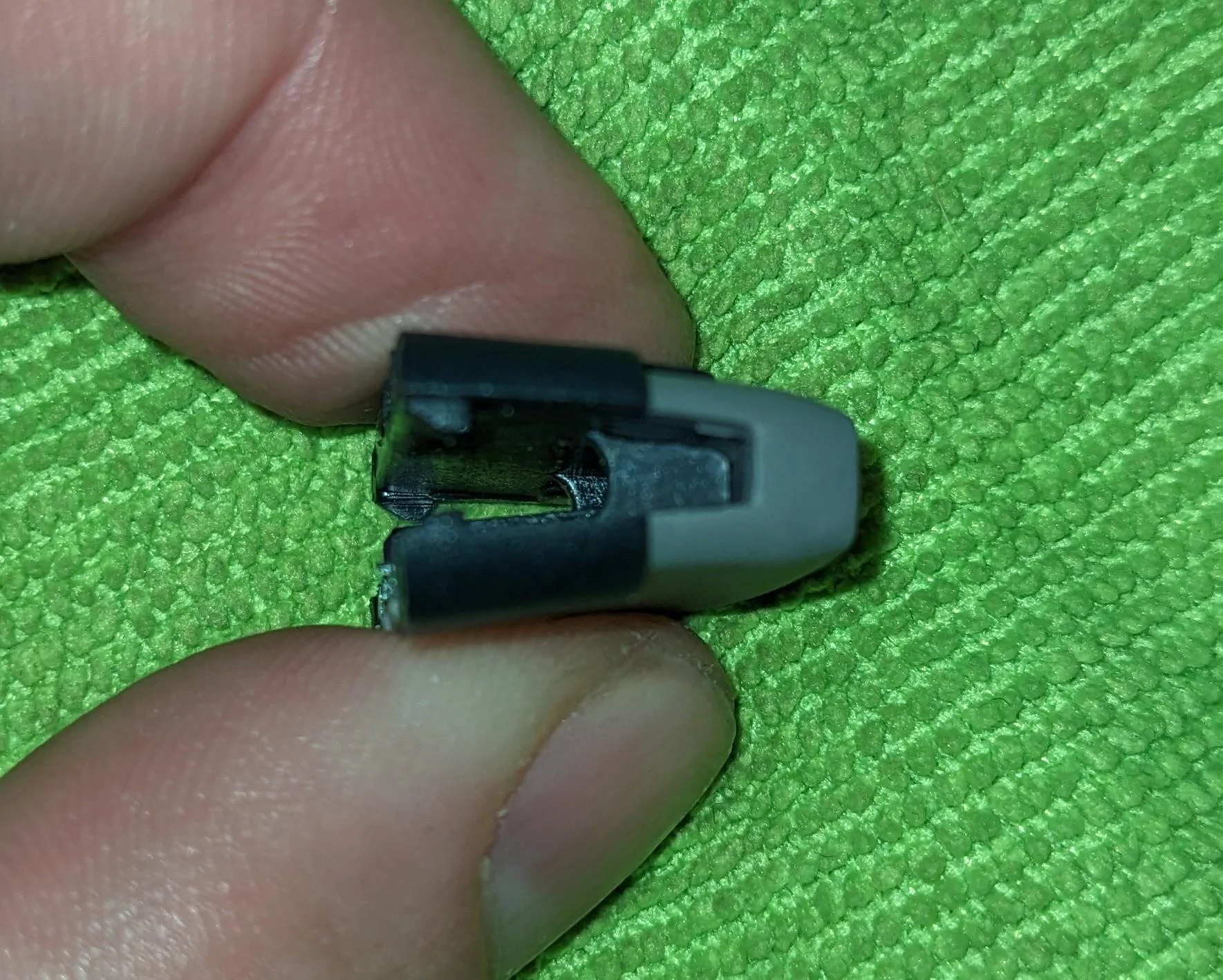

Here you can see the small tabs, two each top and bottom of the tab. All you have to do is carefully open up the tab and pull it towards you. Hope this makes someone's life easier!

The video way is so you don't do any damage to the tabs when you remove them. I've seen some pretty beaten tabs on here, it's like people used a hammer to remove them
That first tab is always experimental lol
Ford Bronco Ac vents falling out PXL_20231212_141625954
That’s definitely a lot easier and makes sense.
