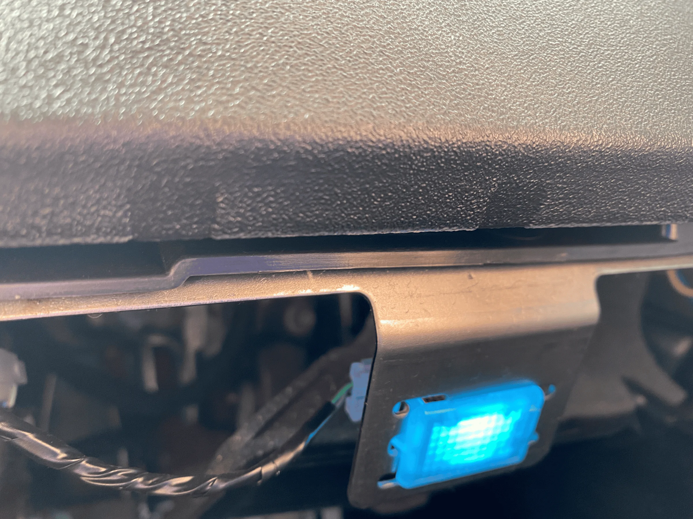

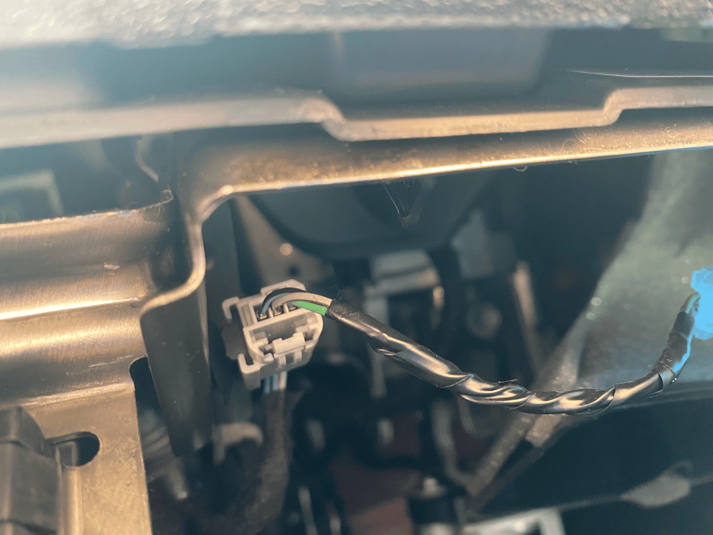

Took a pic of the actual housing earlier, sent @Mabett the pics, but figured I'd show you guys the piece as well
Ford Bronco Adding interior LED ambient lighting (now with working photos!) 1646704077624
Ford Bronco Adding interior LED ambient lighting (now with working photos!) 1646704122092

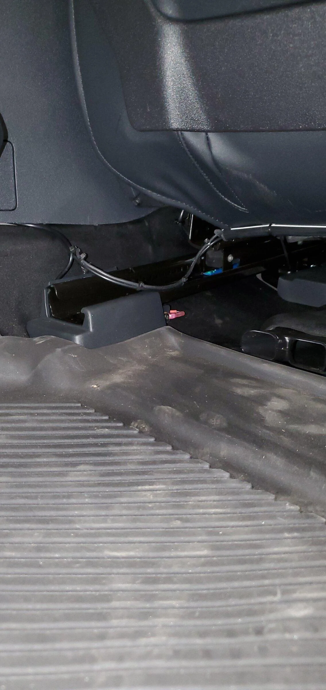

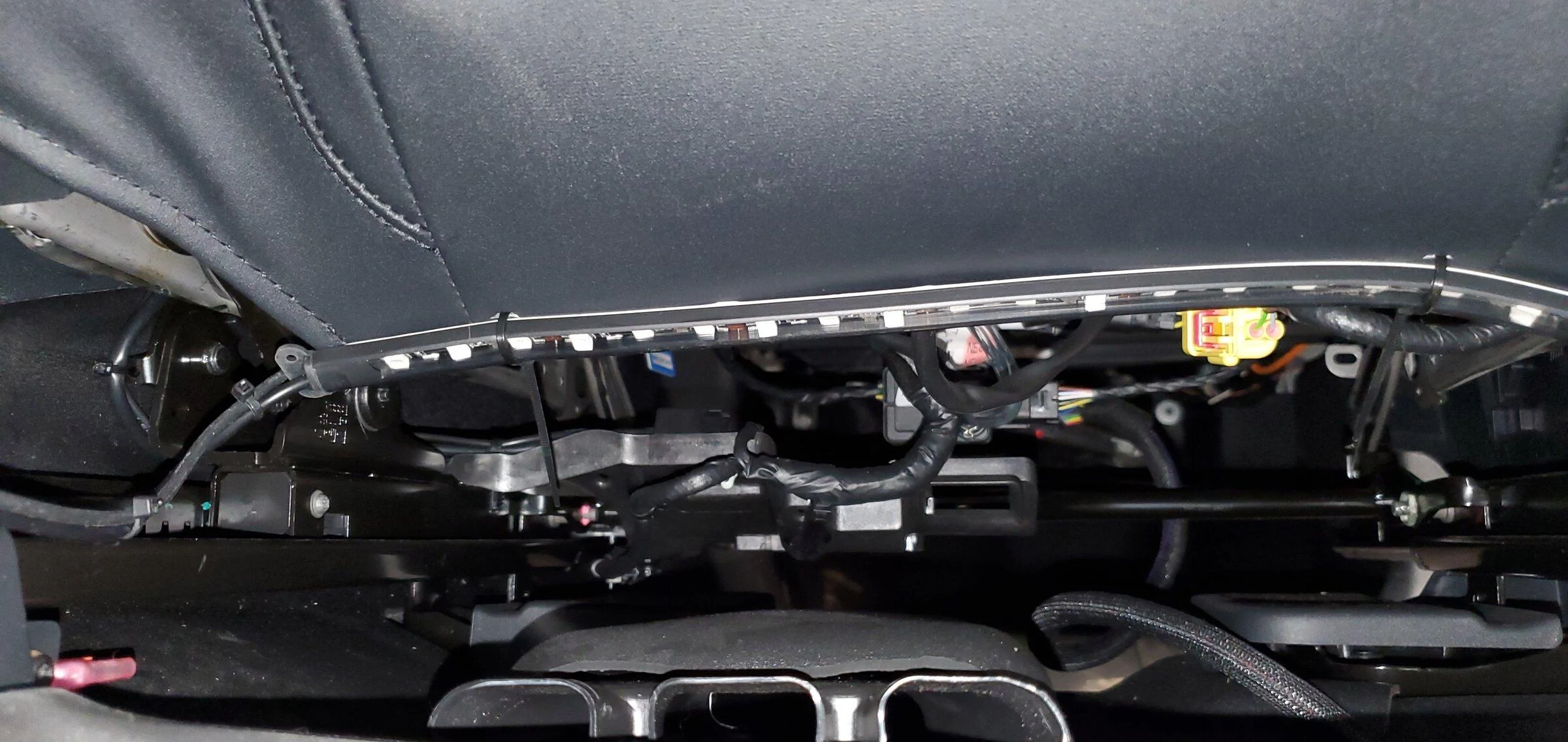

I appreciate this guide! Just installed mine and they came out great! I ended up cutting a small hole on either side of the bottom of the seat and zip tying them instead of sticking them to the floor. But otherwise came out great! May consider adding a Reed switch later but overall pleased
Ford Bronco Adding interior LED ambient lighting (now with working photos!) 20220424_124845
Ford Bronco Adding interior LED ambient lighting (now with working photos!) 20220424_124832
Ford Bronco Adding interior LED ambient lighting (now with working photos!) 20220424_124155
