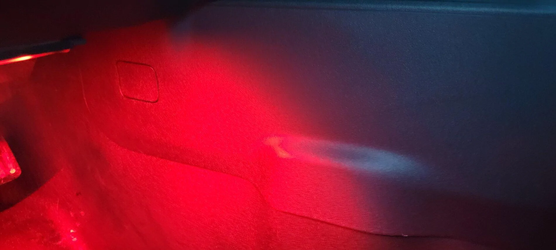

Here is a photo of the hump I'm talking about between the driver and passenger. Just a solid wall of plastic you've got to get through. Maybe your idea ends up being easier, I'm excited to hear! :)

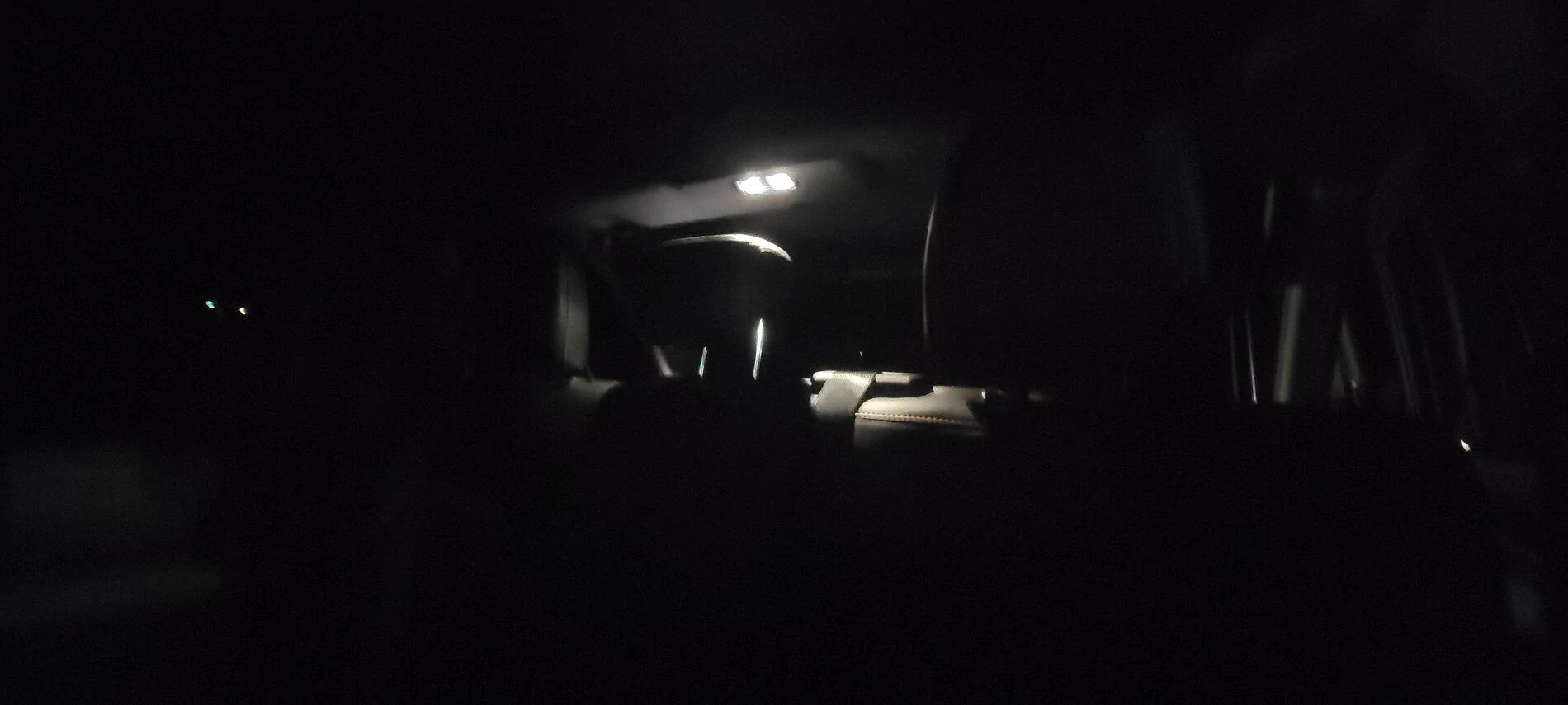

...I am VERY curious why there is such a divide re:cabin lighting. Some people swear it's more than sufficient.. Yet here we are, starved for light. There is a piece of the puzzle missing and I'm not sure what it is yet.
I am sure. Some people are satisfied with lower level of lights than others. Some are "tinkerers" and want much brighter light. Basically, it depends on what the user is doing, or just likes.

If by dome light you mean the small light on the cross pillar, I assure you it is. It's just pointless.
My badlands with high package looks just like this. I’m blown away by how bright some of the other dome lights look. I can’t see anything in mine.
Weird, isnt it?
I love the lower level lighting at night but my main issue is that my kids cannot see the seatbelt receiver to clip their seatbelts. I end up having to shine my phone light in the backseat at the seatbelts. The rear dome lighting is aimed right at the top of the rear seat. I wish it moved some to aim it at the seatbelts. Anyone else have this problem?
