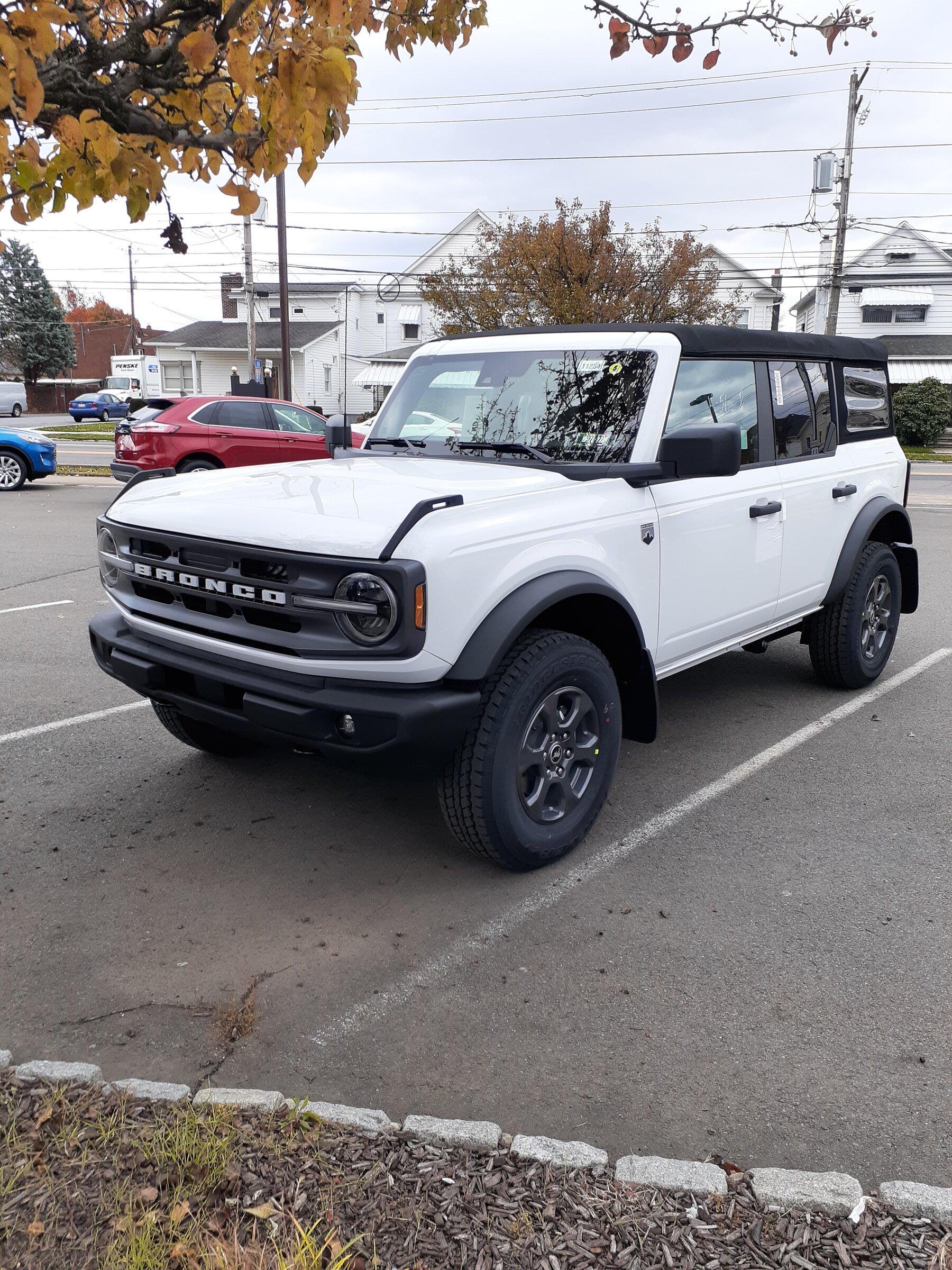

Yes, but not in the Bronco I purchased.
My wife and I really didn't like the Bronco, felt it wasn't worth the money or the headache of trying to make it work with our family. We actually turned it down at the dealership. The dealership called us the next day and told us to please take delivery of the vehicle and sell it, flip it, or whatever else you want to do with it. I told the dealer to give me the rest of the weekend to decide on what to do. The dealership stated with the allocation formula, it would benefit them if I puchased the Bronco from them. So I called around and got an offer that was approximately $2,000 over my final purchase price. (MSRP, taxes ,title, dealer fees)
So in the end I purchased the Bronco and sold it within 90 minutes of owning it.
Both dealerships made out, the seller and buyer. I walked away with just under $2,000.

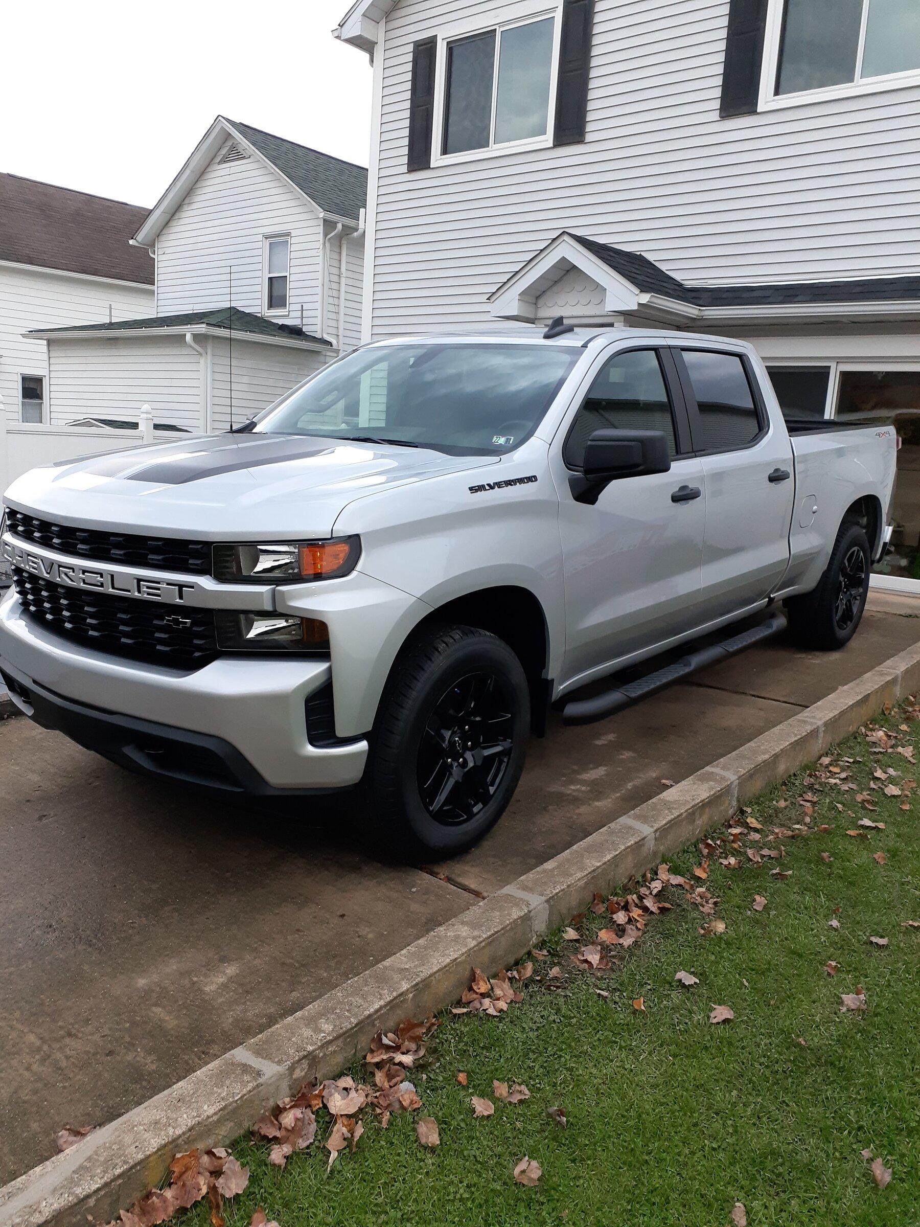

The Gooves lights are now installed in a 2022 Silverado. Wires are hidden nicely.
Front lights underneath the dash each have to zip ties on them. The rear one actually are mounted through the seat strapping under the front seats for the 2nd row light. It was like the straps were made for the lights.
The lights are a great investment for $30.00

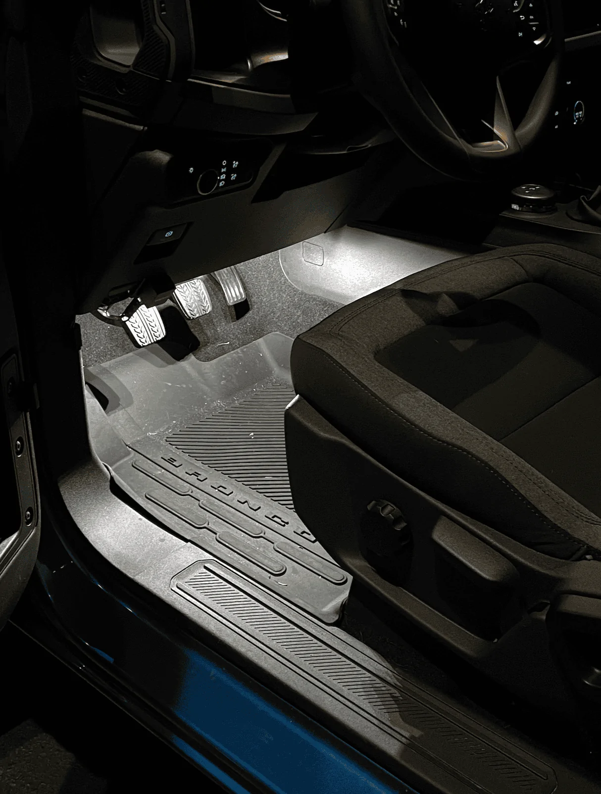

@Theherofails did you ever figure out anything on your dim lighting? Mine is the same, it’s a fucking cave in there nothing like some of these pics. The overhead and ambient footwell lights are laughably dim.

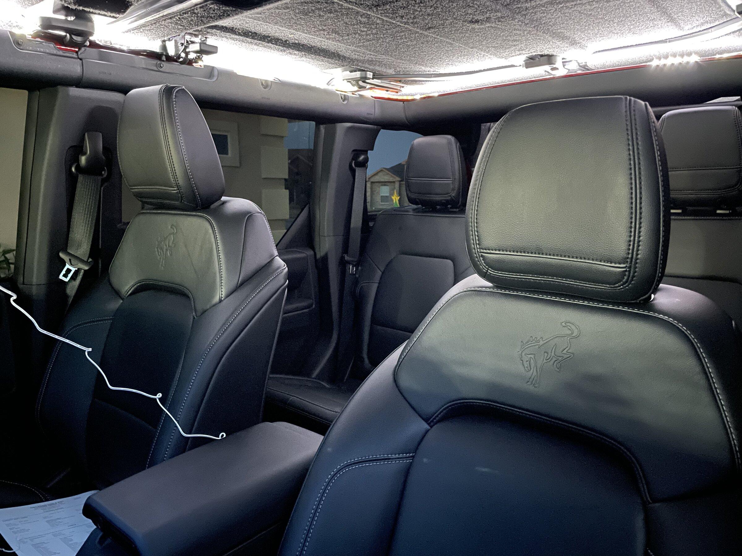

Did you figure out an overhead solution? I mocked up some cheap led tape light tonight and am pleased with the results. Looking for better quality product but this has promise.
wow. this looks very promising!!!! im working on some fixes for soft top as well
