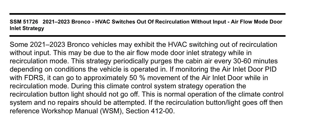

It’s normal and designed to work like this.
Ford Bronco Air Recirculating Button IMG_1601

Its part of the design. From what Ive read other ford vehicles do it as well. It doesnt matter if its on or off it will cycle itself. Im not sure why ford does this but its annoying. What bothers me most is when Im on the road at 75mph with the lowest setting on recirc then it opens and the air speed picks up and blows harder
