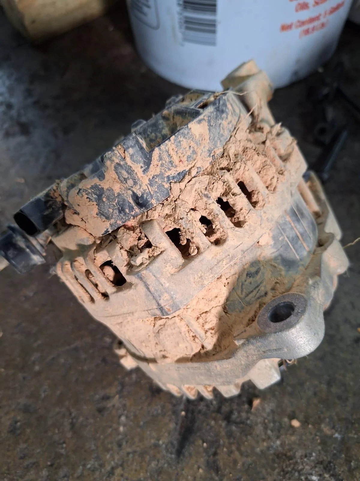

br.jonathan
Jonathan
Sep 10, 2022
Puerto Rico
Currently in my third alternator rotation. Have the original and a second to swap in these situations
1st original alternator original cover
2nd new alternator installed with revised cover
3rd original alternator cleaned (currently installed and working)
See picture this had the revised cover…
I want an Australian sealed alternator for the Bronco…..
