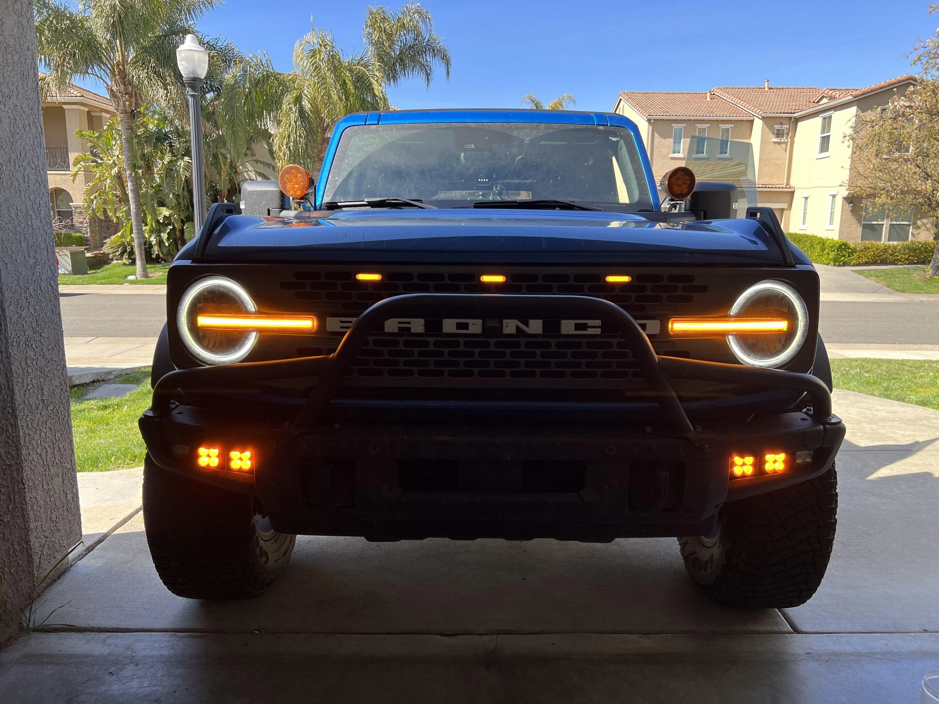

Yes it's worth it, I got it to shut off the 3 beep when I got out of the running truck with the keys in my pocket, drove me nuts and then I changed the lights, it looks good with the Rapter lights I added yesterday

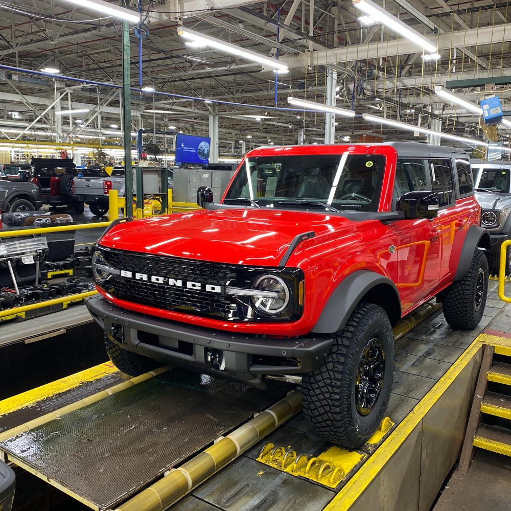

2. Can you share your factory photo with me? I never received one, and it looks like you have the same exact build as me.
Thanks!
1. Yes, I used Forescan to have them always on but they go back to the white bar when headlights come on, I put an amber sticker from stickerfab to have them stay somewhat amber.
2. here is the fac photo

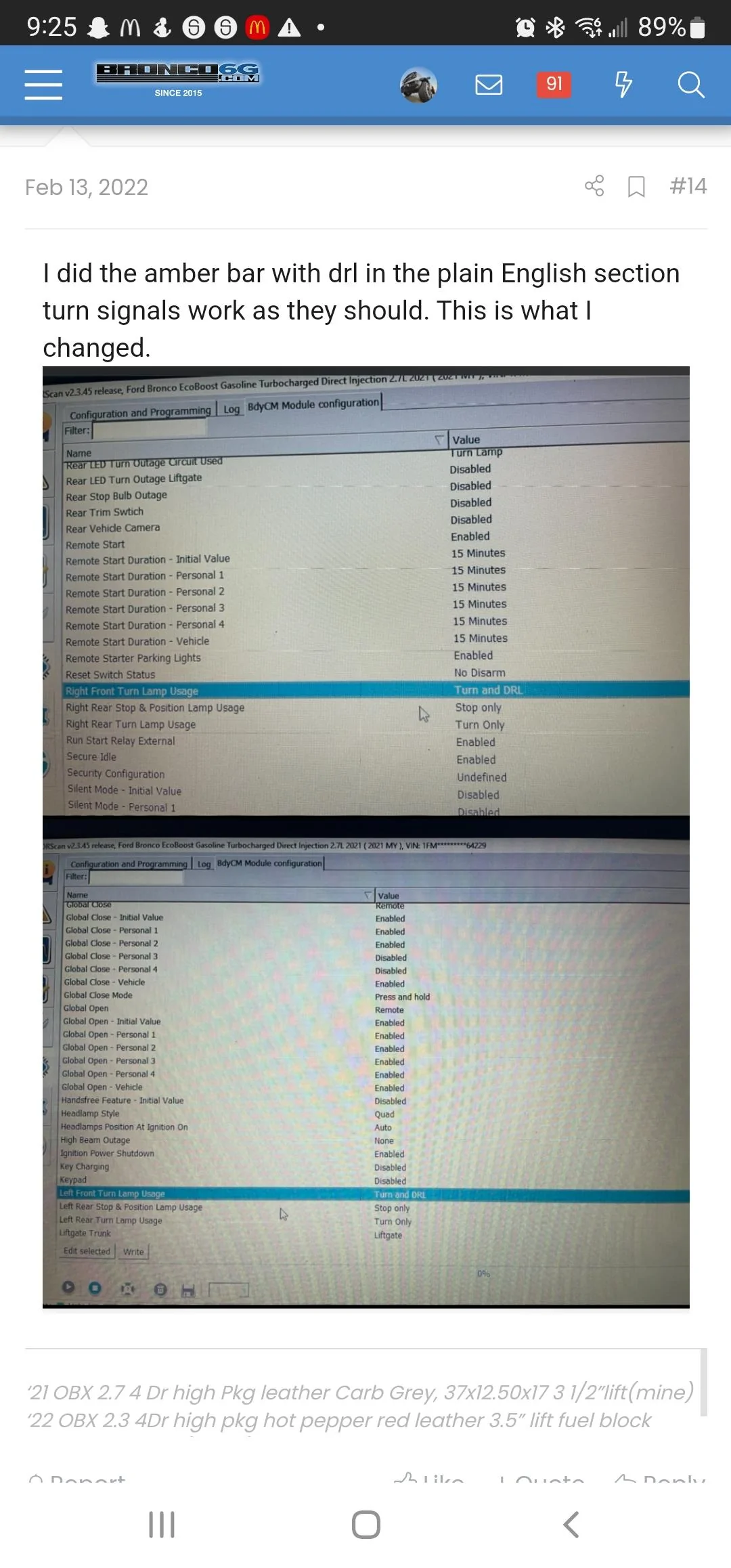

I also did the amber overlays from stickerfab.
Then in Forscan I changed the configuration in BdyCM Module config (AS BUILT format)
from this:
726-43-01 0202 0000 0176
to:
726-43-01 0101 0000 0176
0101 which is 'Turn and DRL'. Default was 0202 which was 'Turn Only'. 0303 and 0404 leave the position (marker lights) having priority. If there is a way to change Turn Signals to have top priority then 0404 would work.
If you go into the non (asbuilt) version, you can just search for "front" and change the front left and right turns to 'Turn and DRL'. It will change the as built to 0101 for you id that is easier for you.
This is as good as it gets so far. Remember for DRL to go full amber you need the transmission in D or R. Turn signals work in all headlight modes, but amber DRL goes back to white once headlights come on.
