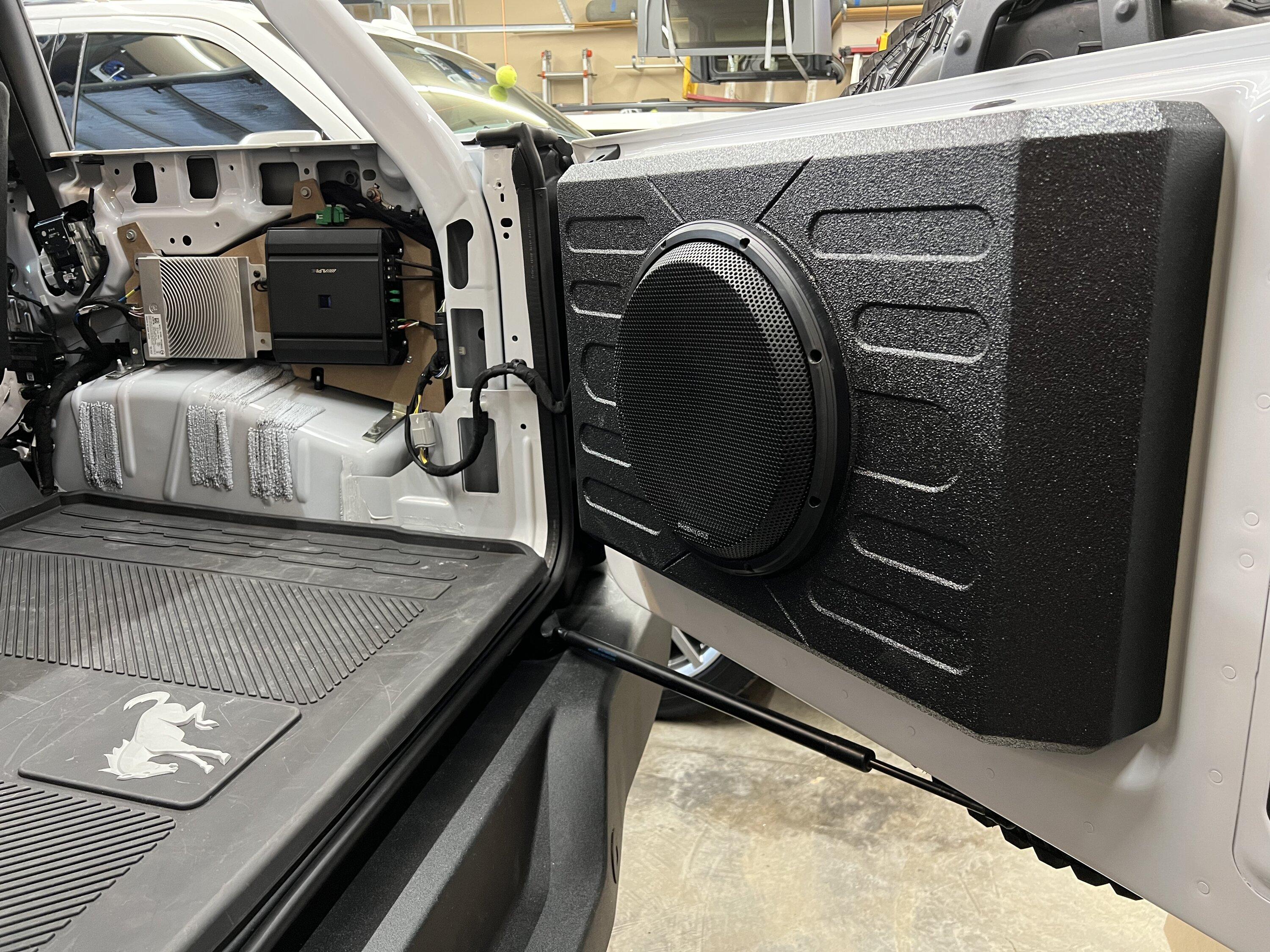

Finished up my B&O update!
Thankful for those before me who provided insight and instructions on how to do it.

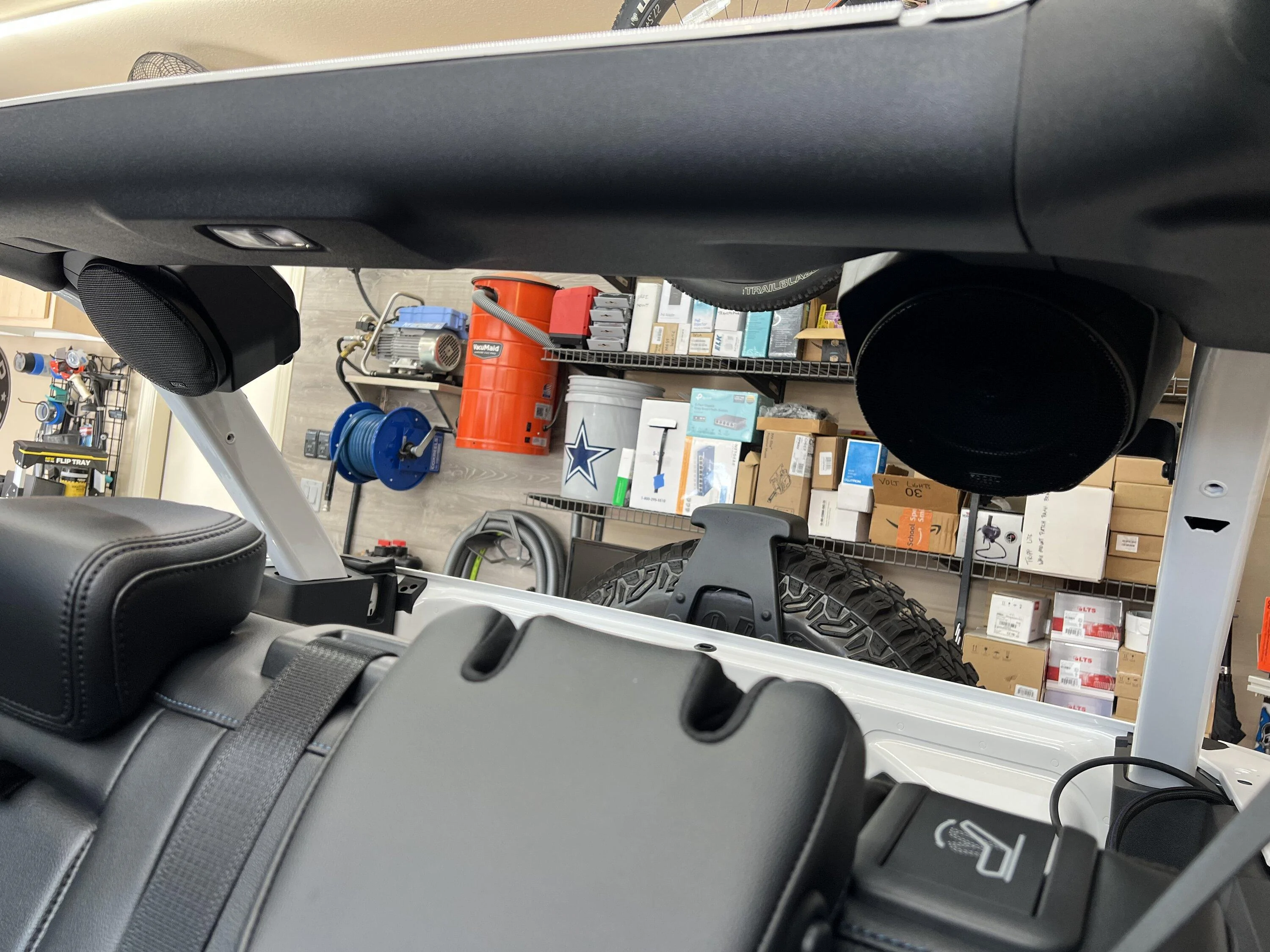

I did the Focal ACX 100’s for the 3 in the front dash.
I skipped the kickpanel speakers.
I then swapped out the rear pods for the SSV pods and used Focal ACX 165’s back there.
Then went with the Stinger tailgate sub and an alpine amp.

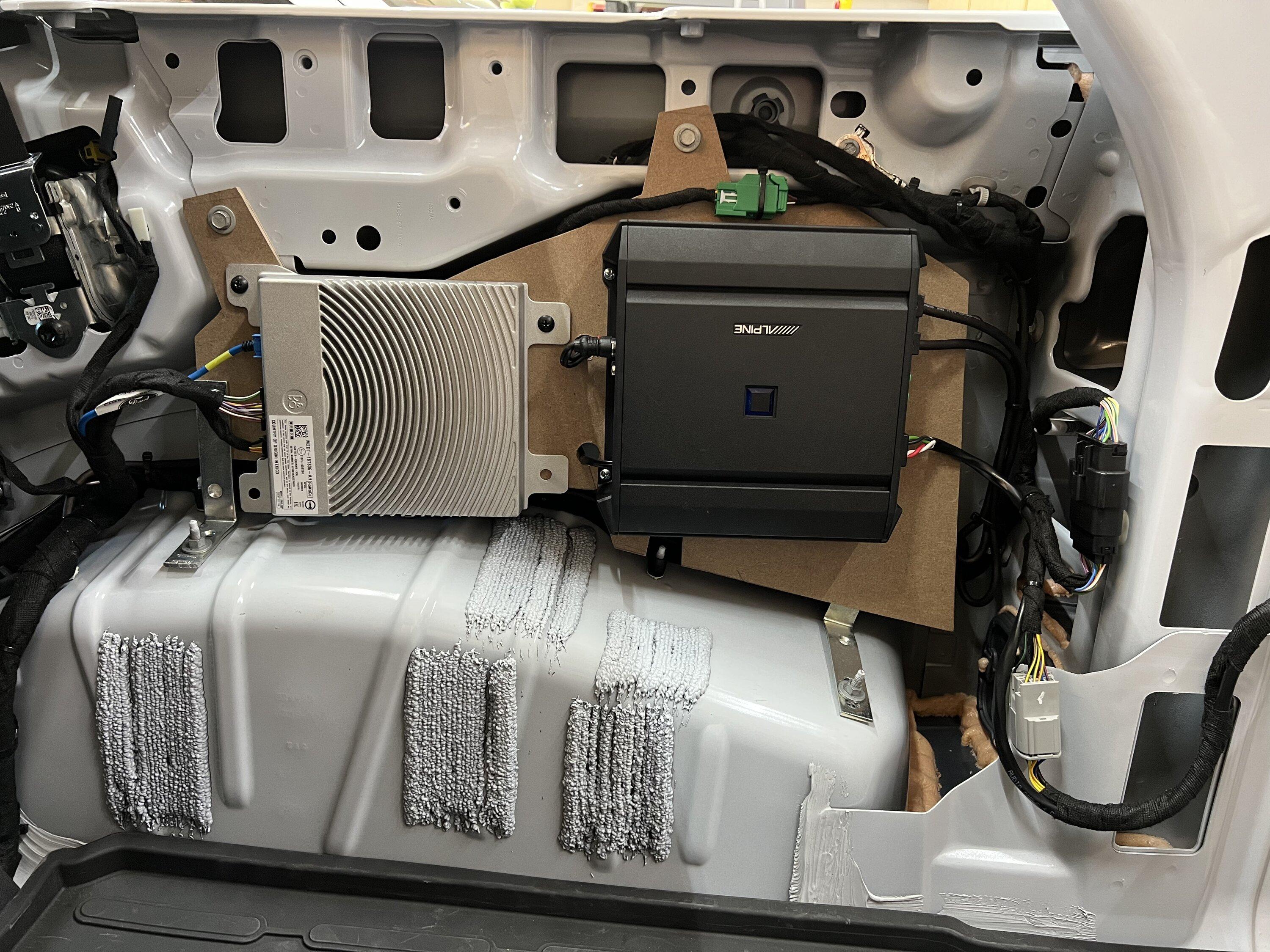

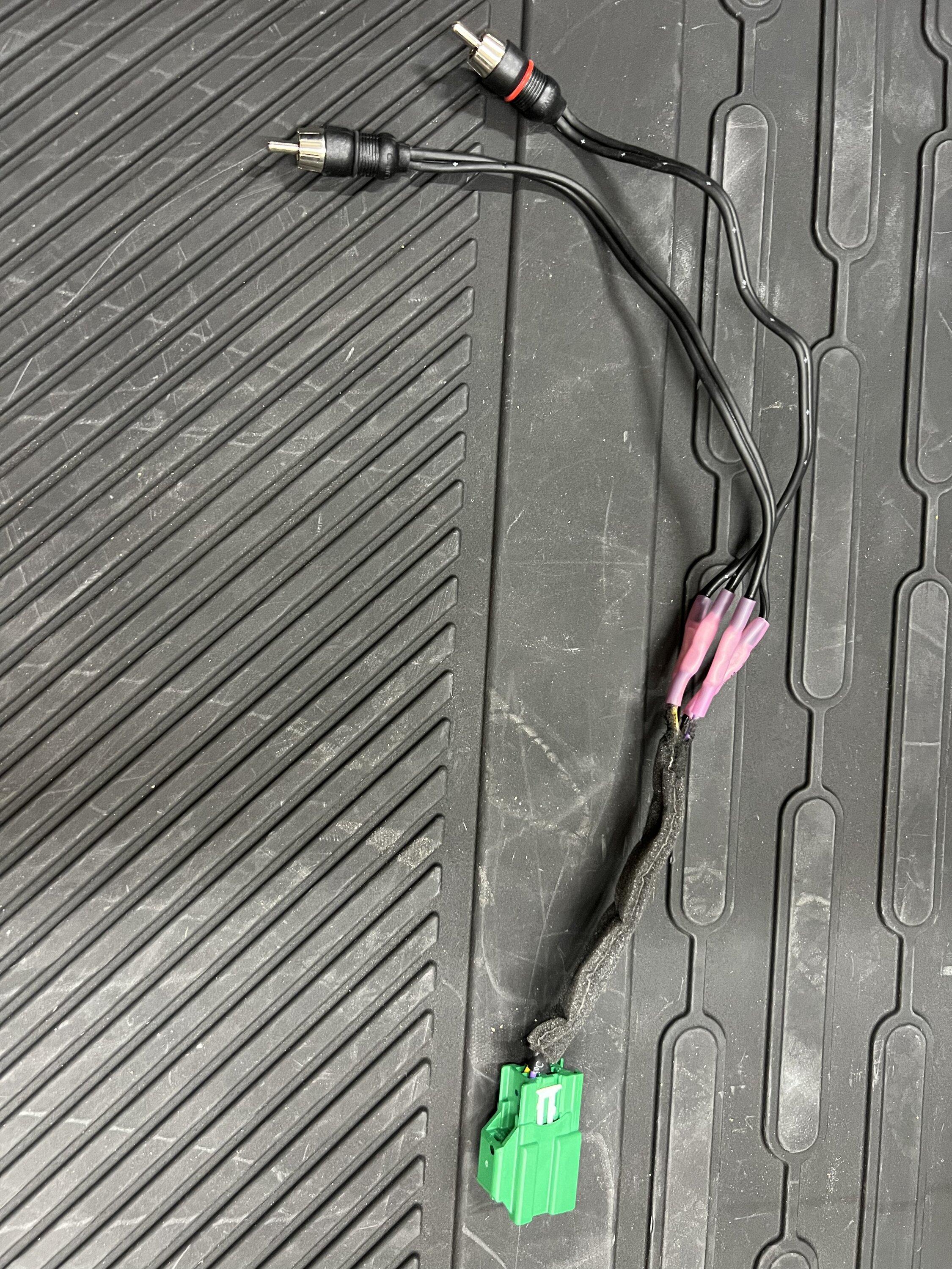

I made my own amp plate and made a harness for the sub and alpine amp using the connector off the factory B&O sub.
So far, very happy with how it has turned out.
All in was about $1350.

So is the sub the only thing left from the stock system?
No, I removed the factory B&O sub and put in the Stinger tailgate subwoofer.
The alpine amp is where the factory B&O sub was.

Do you have more sound coming from the back? those b&o pod speakers do nothing as far as I am aware. I’m not looking for blow me away sound, but I would like to *hear* the speakers behind me
That is the upgrade I’m looking for.
Yes, more range and more sound.

Do you have more details on your amp plate? What's it made out of, how many mounting locations does it have?
TXBrian
TXBrian
Nov 30, 2022
102
157
Dallas
2022 Bronco
So I ordered a HDPE plate but it was delayed shipping so I decided to just make one so I could get this project done.
It’s made from 1/4” mdf and is mounted at 4 points. The top 2 factory bolts and then using 2 L brackets on the bottom. I modified the bend on the L brackets to get the angle right and then drilled new holes in them to like up with the factory studs on the fender.
I removed the factory sub and laid it on the piece of mdf and traced it the best I could.
Cut the first piece out and then put it in the bronco and made some adjustments and cut another piece of mdf. That one worked perfect and is what I used . I may make another using Hdpe with the template I have now.
I upgraded my pods to the mabbet 6.5 ones and csc65 in there and I can tell the difference. I hear them much more than before with the stock B&O pods.

How much space did you lose with the tailgate sub installed?
TXBrian
TXBrian
Nov 30, 2022
102
157
Dallas
2022 Bronco
It’s 6.1” deep.
Sticks out about the same as the hump on the tailgate.
