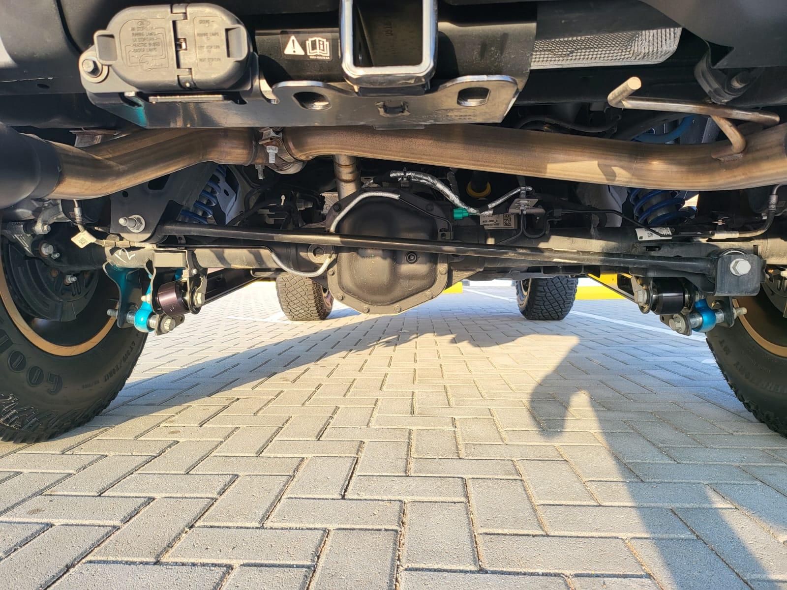

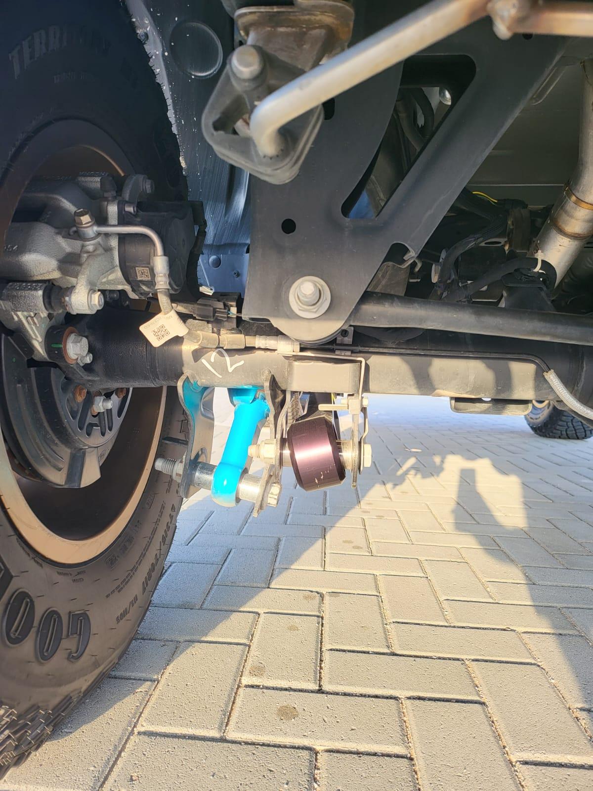

From my experience and others in our local bronco club, I can add a few points below that may help.
Firstly, you are not the only one who has experienced this. We have another member that got the prerunner kit and it was absolutely terrible on the whoops. That thing was kicking up the rear like a wild donkey.
I have the chase kit on mine with kings shocks.. and for me as well, it didn't feel great at first.
I managed to find a suspension tuner locally who does buggies for a living. He has loads of experience and a shock Dyno too..
Cutting it short, we took my car for a test run and even he said it was pretty terrible in terms of setup and just not done properly.
He ended up changing the ride height, fully rebuilt the shocks with different pistons and now it feels the way it should. I can't explain how different the car feels after the changes.
It seems that any mechanic can just bolt this all together, but it takes a professional to set it up properly with the correct ride height and other shock tuning adjustments.
I would recommend trying to find a local shock tuner to help you dial her in properly so you can enjoy it :) hope you get it sorted
