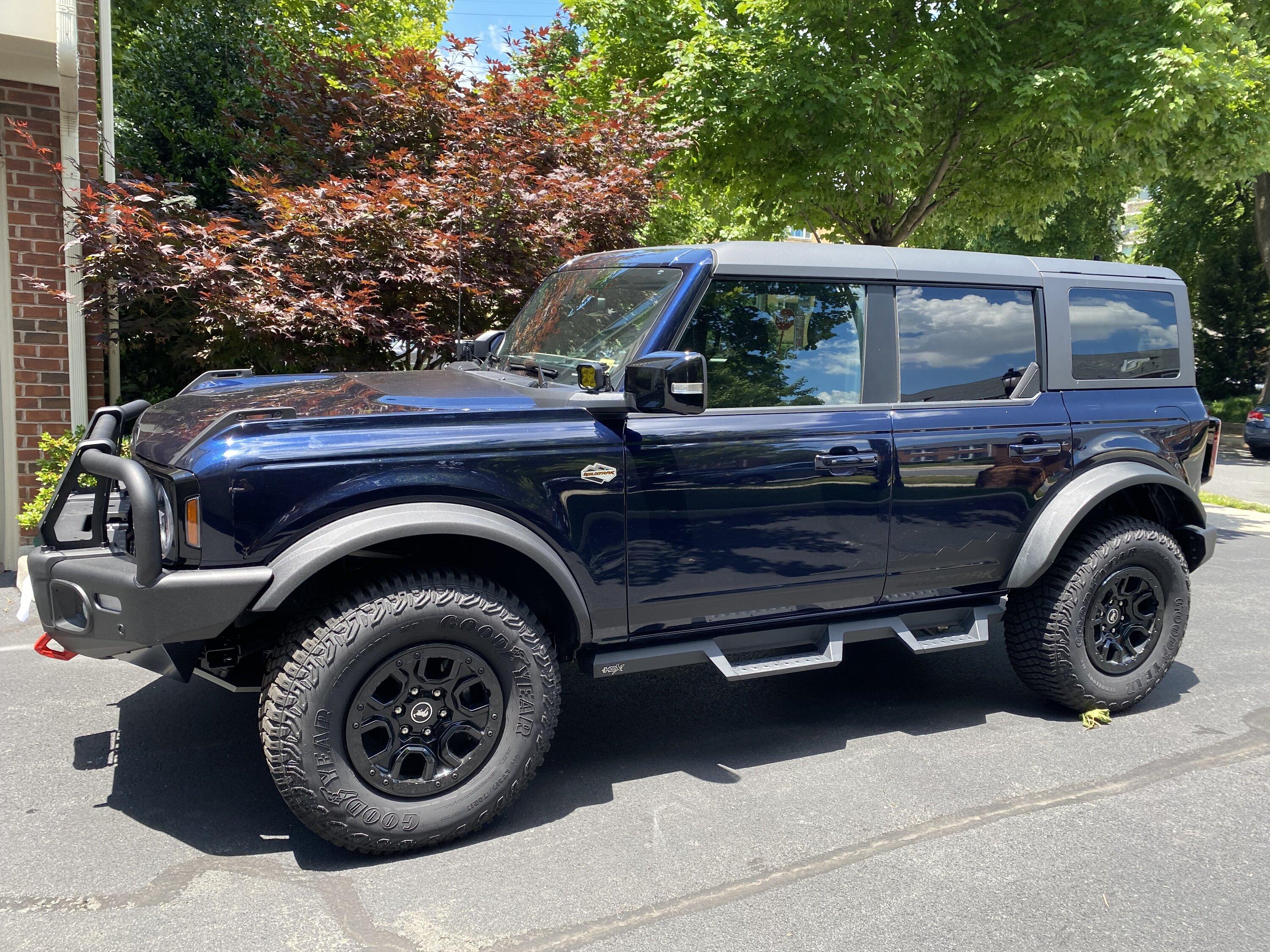

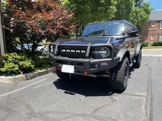

Here is mine installed. Waiting for the Diode Dynamics fog lights.
The bumper moves the camera, the radar and all parking sensors. The license plate mount came with it.
Only issue I've had is the camera relocation is for no front plate so you can see the top of the plate on the screen.
