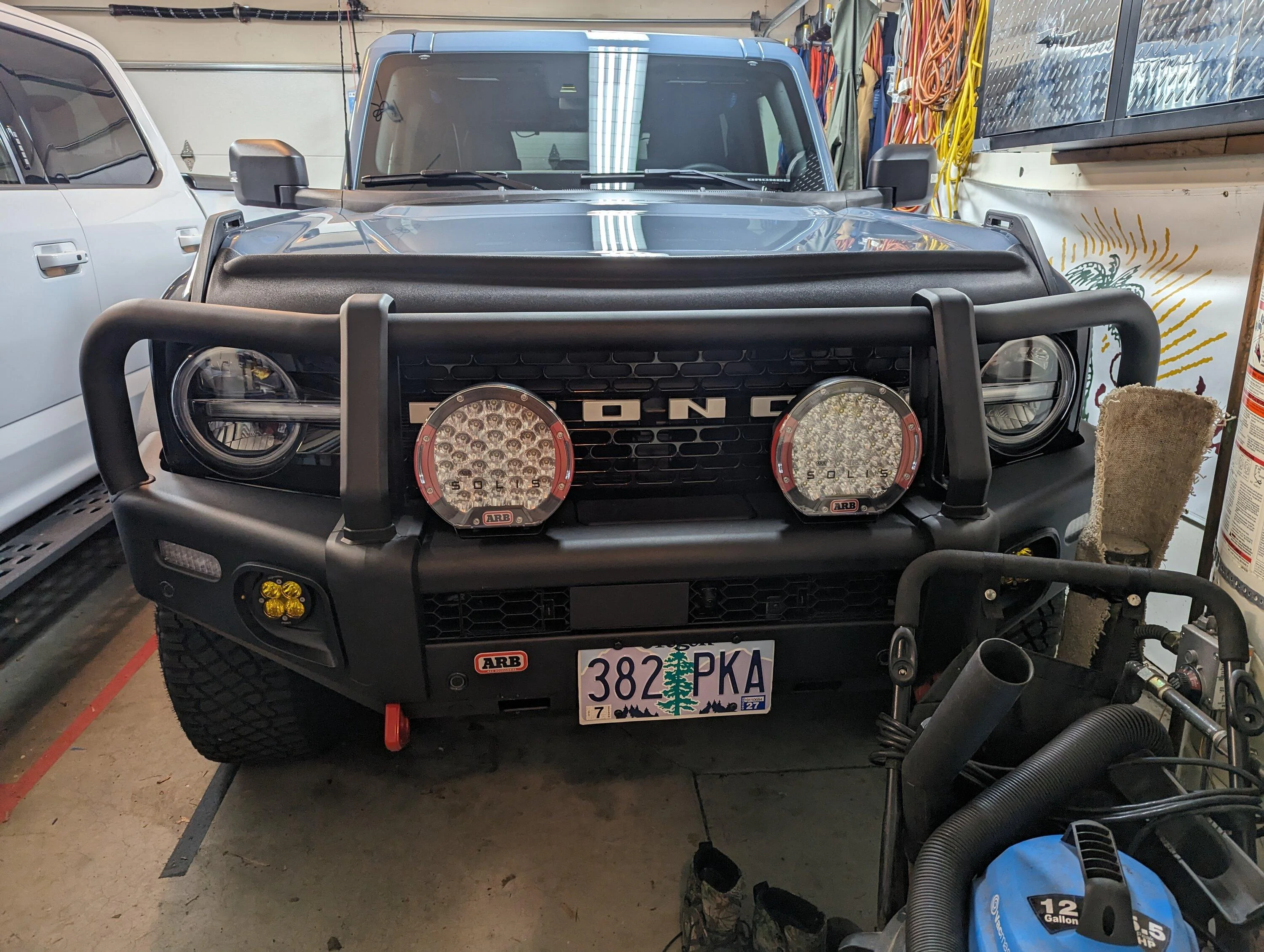

The intercooler is well below the mounting point for the winch. The grill in the bumper is unobstructed to the intercooler.
Sorry not trying to be a doubter. But checking this photo, it looks like the winch body is in front of the intercooler. No?
Yes, the intercooler is really buried behind the bumper in the stock location, especially with a winch installed..
