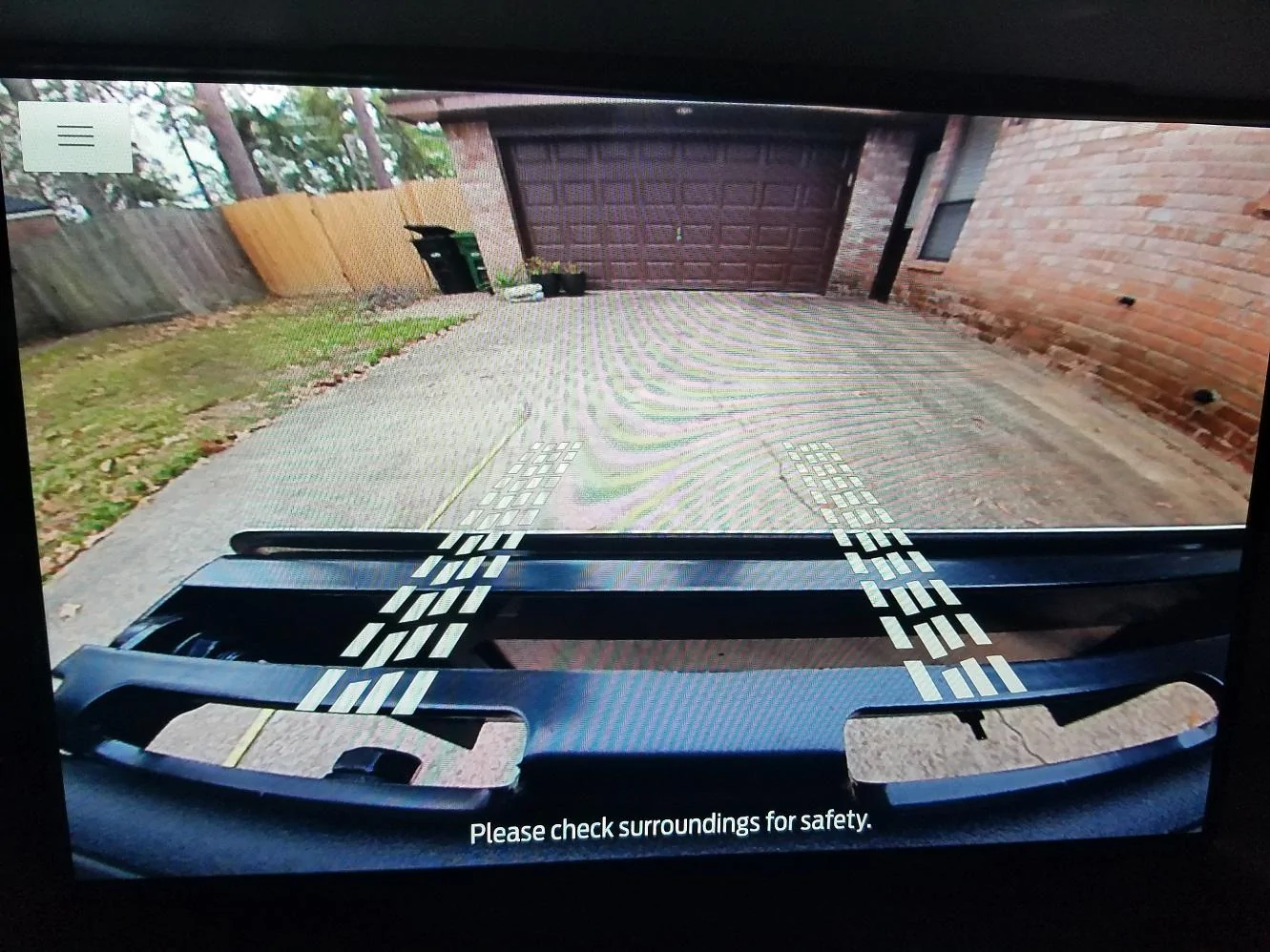

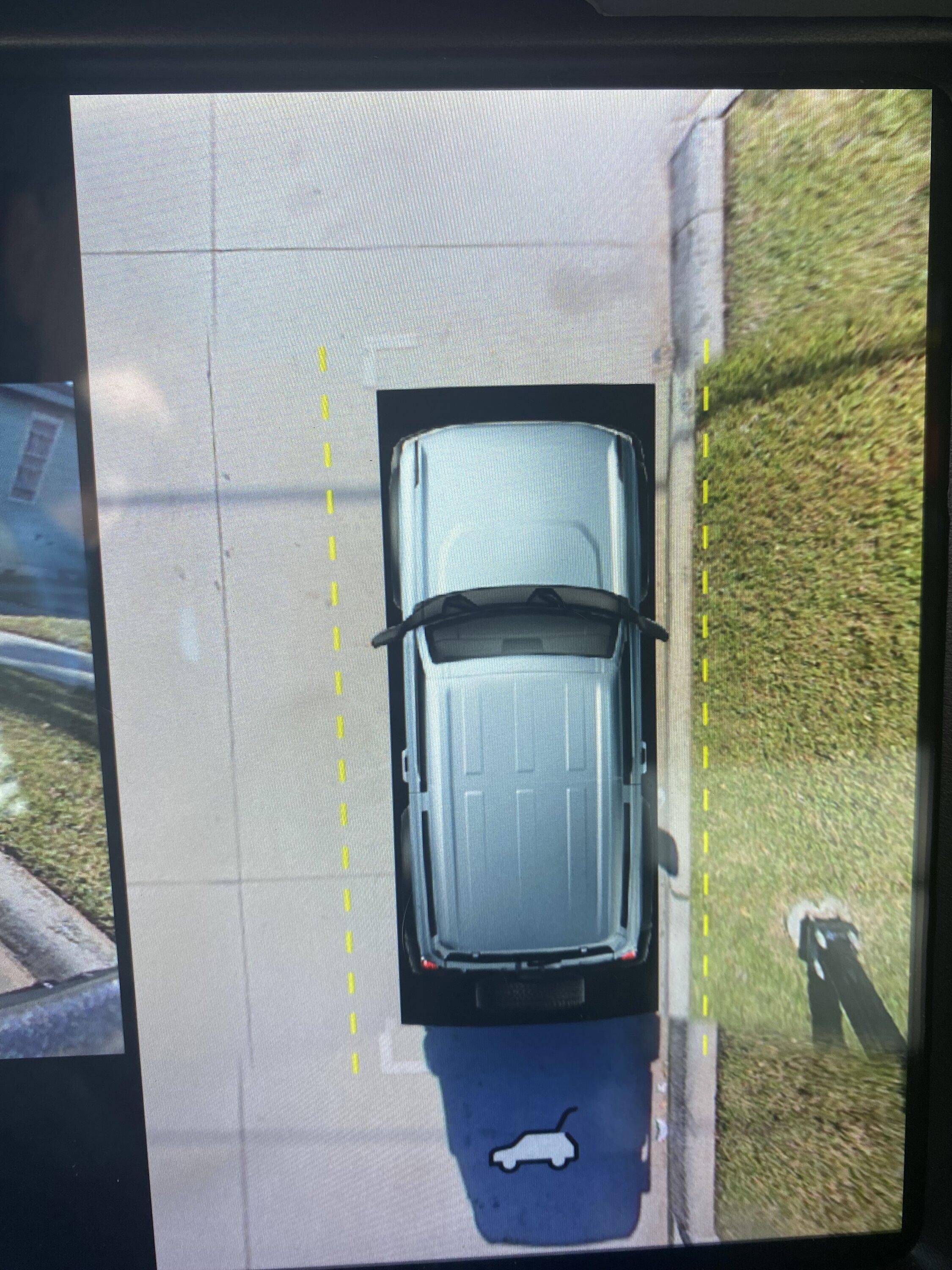

Deserves a new thread. with the camera relocation. What will the view look like. In particular the tire tracks in 4L ?

Tire tracks still show. But they are shifted by one tire-width, actual vs what it shows on screen. Due to the tracks being a fixed location and the image being shifted.

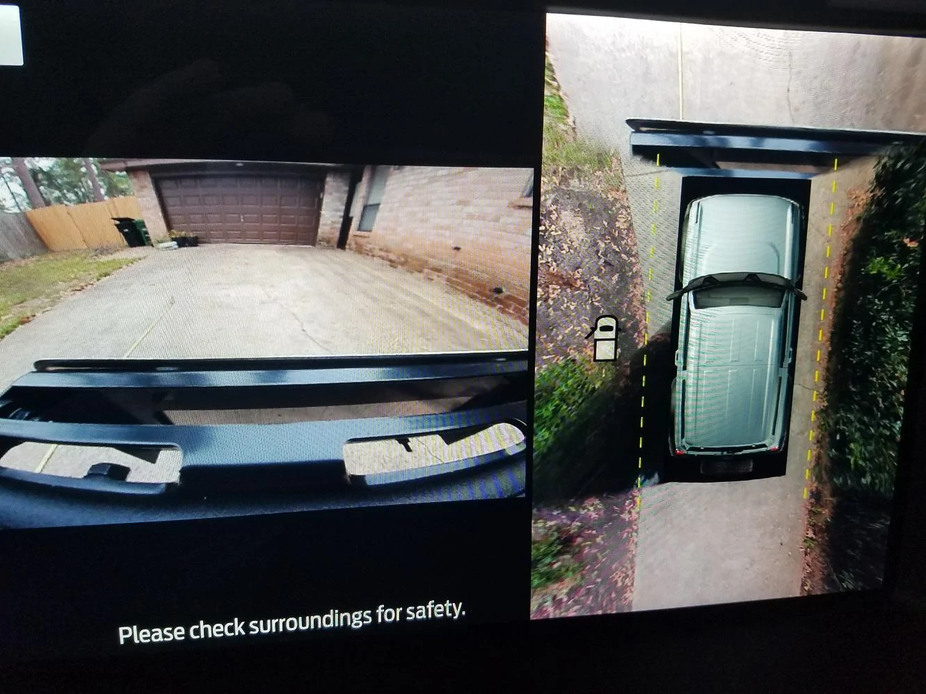

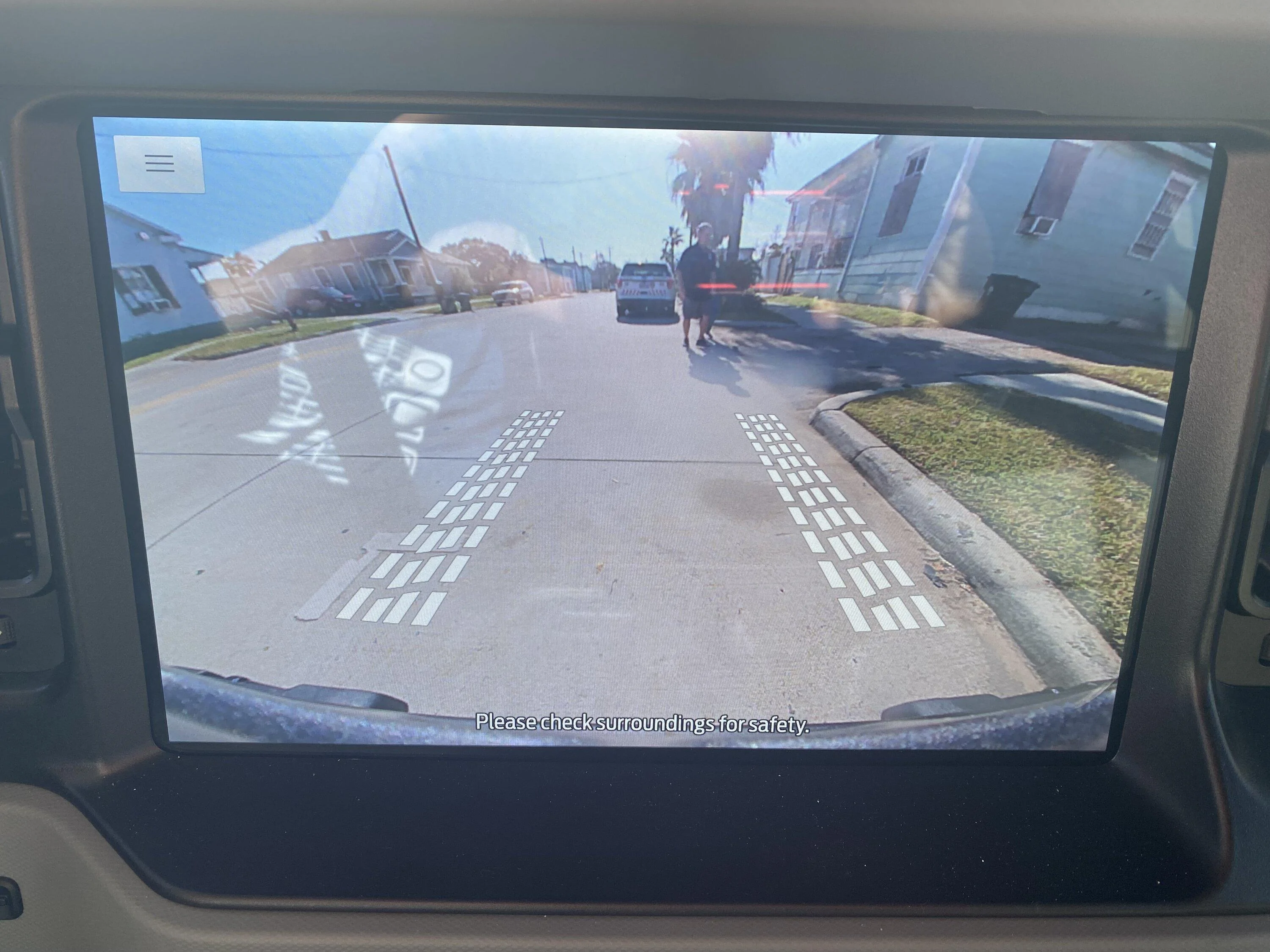

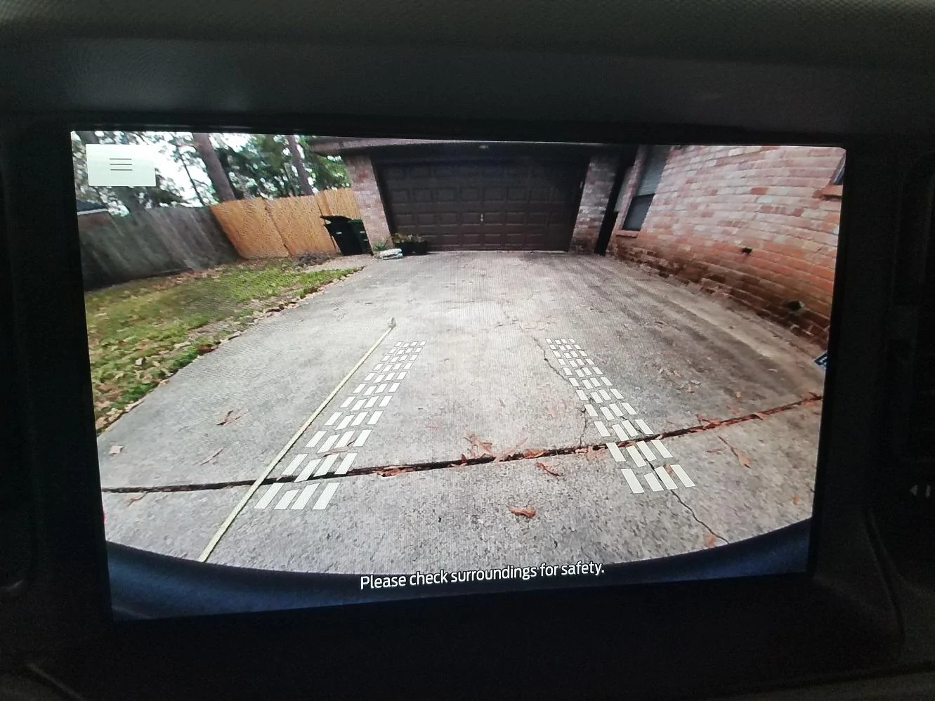

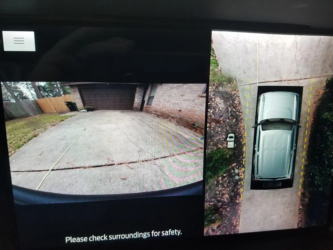

Here you go. As said above the tire track is shifted one tire width inwards. The tape measure on the ground is butted up against the center bottom of the driver tire and set to 8'
The 360 look down is not quite right as well, but mostly still works.
With the license plate bracket installed

Without the license plate bracket installed.

Thanks so much. I think I can live with that
