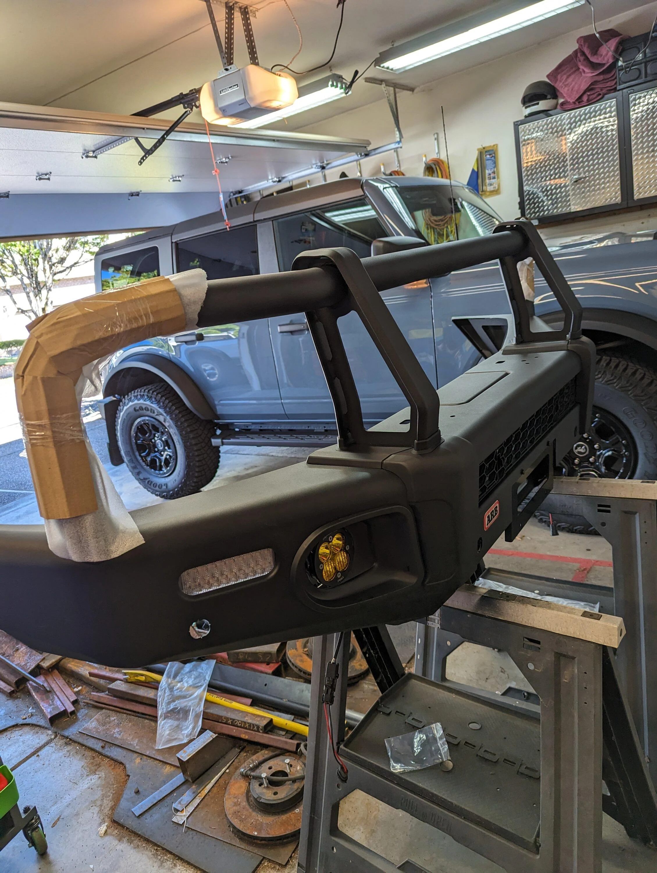

I have the Summit on my Wildtrak and it doesn't weigh 172lbe without the winch. It's heavy, but not that heavy. I was able to carry and mount it myself. My Wildtrak came with the capable bumper and it weighs approximately 50lbs +/-. The Summit without a winch is 150ish. Looking at a net difference of 100lbs. Can I feel the difference while driving? Yes. It's not bad and still drives great, but you doo feel the weight. Mine is a fairly heavy (weight) build. Summit, full skids, frame mounted rock rails, Tuffy cargo lock box, etc. I will be adding heavier duty springs.

I understand that. It might be the shipping weight with all of the packing material. After handling it solo, it's not 172lbs heavy. Here is a photo where I put it up on saw horses solo to assemble it.

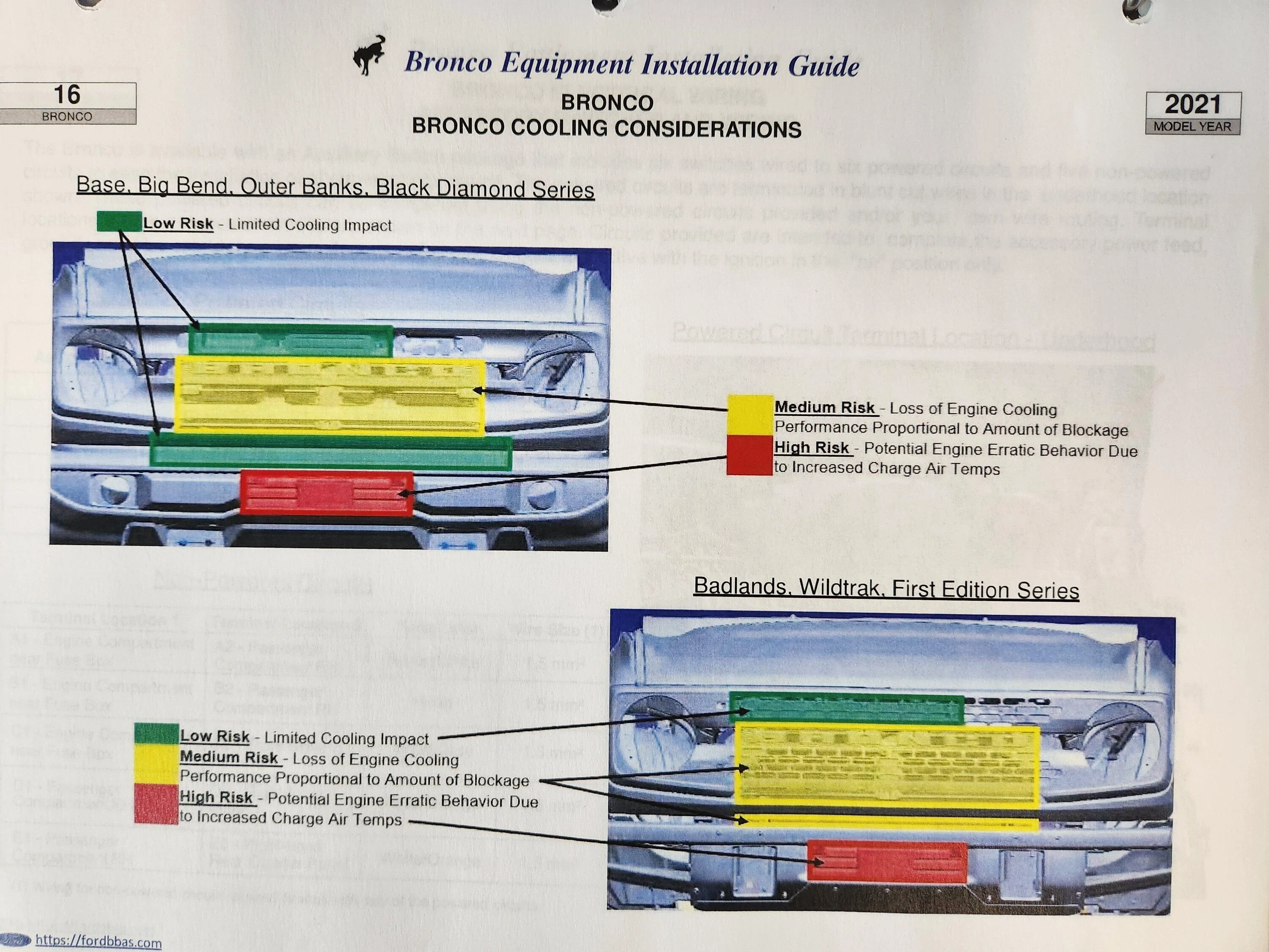

Ok. And one more.. without a winch I don't see a problem. With a winch I'm concerned about blocking the intercooler air flow. What are your thoughts?

Ford says you should be concerned.
The intercooler is well below the mounting point for the winch. The grill in the bumper is unobstructed to the intercooler.
