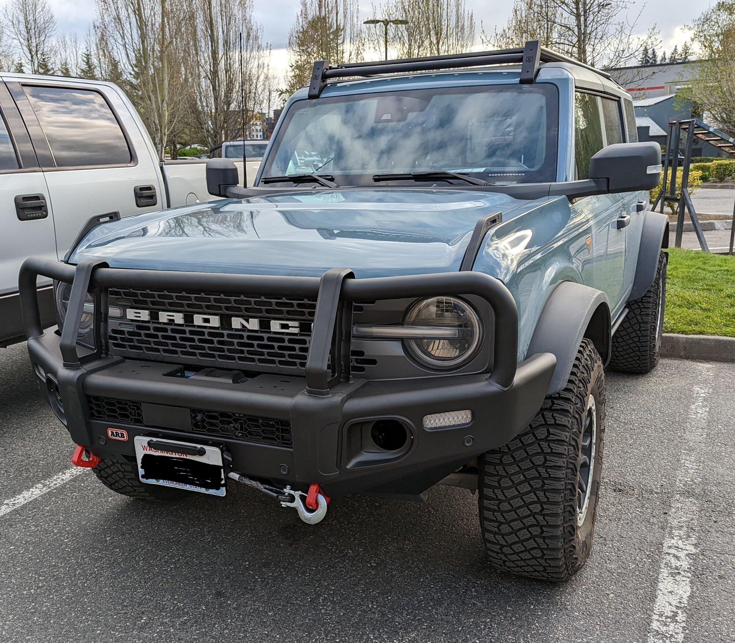

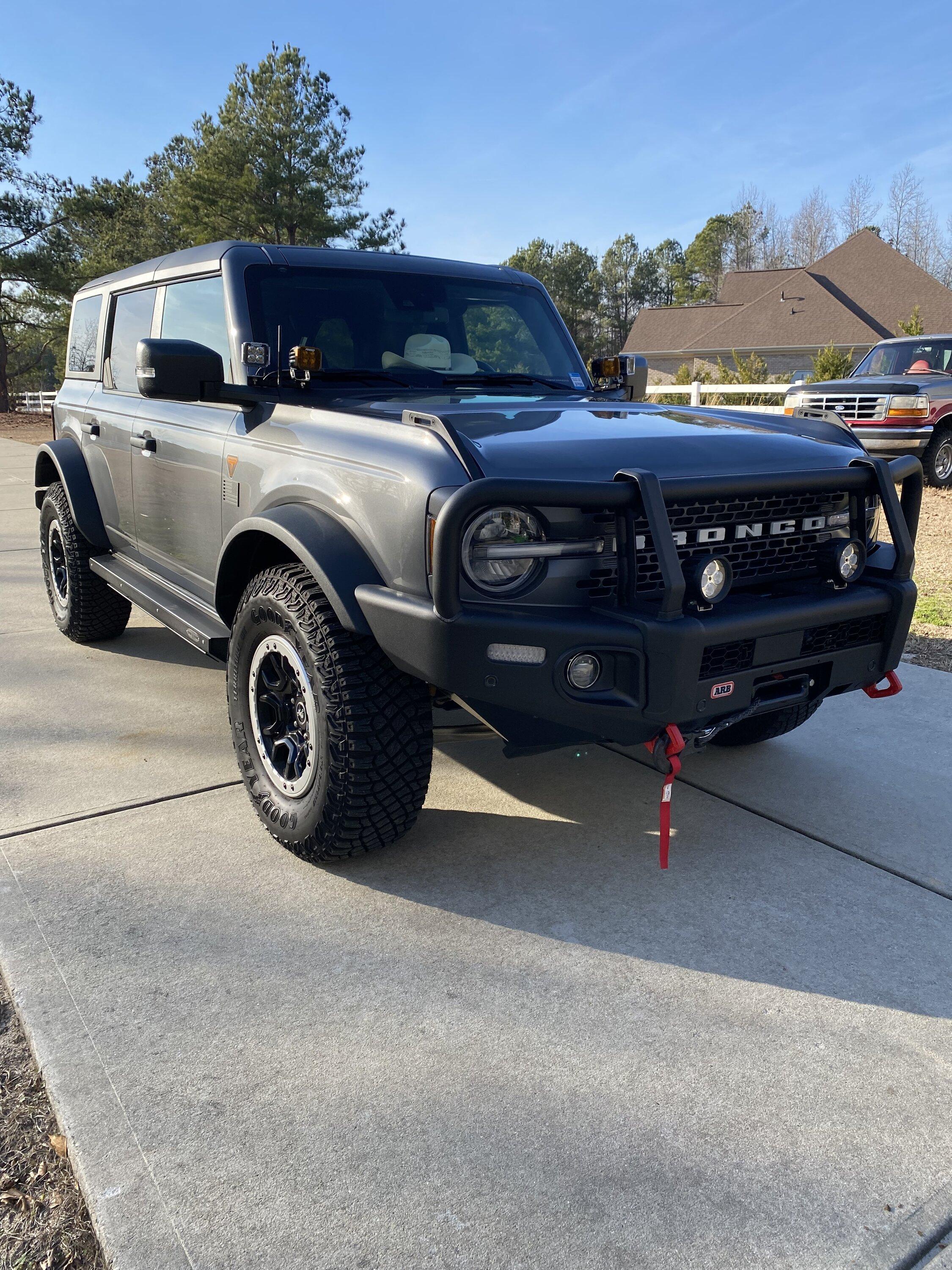

I have one on my Ranger and absolutely love it, considering this for the Bronco as well. How has it been to this point? Also, did you have to rotate the winch clutch? (I did for the Ranger).Here is mine installed. Waiting for the Diode Dynamics fog lights.

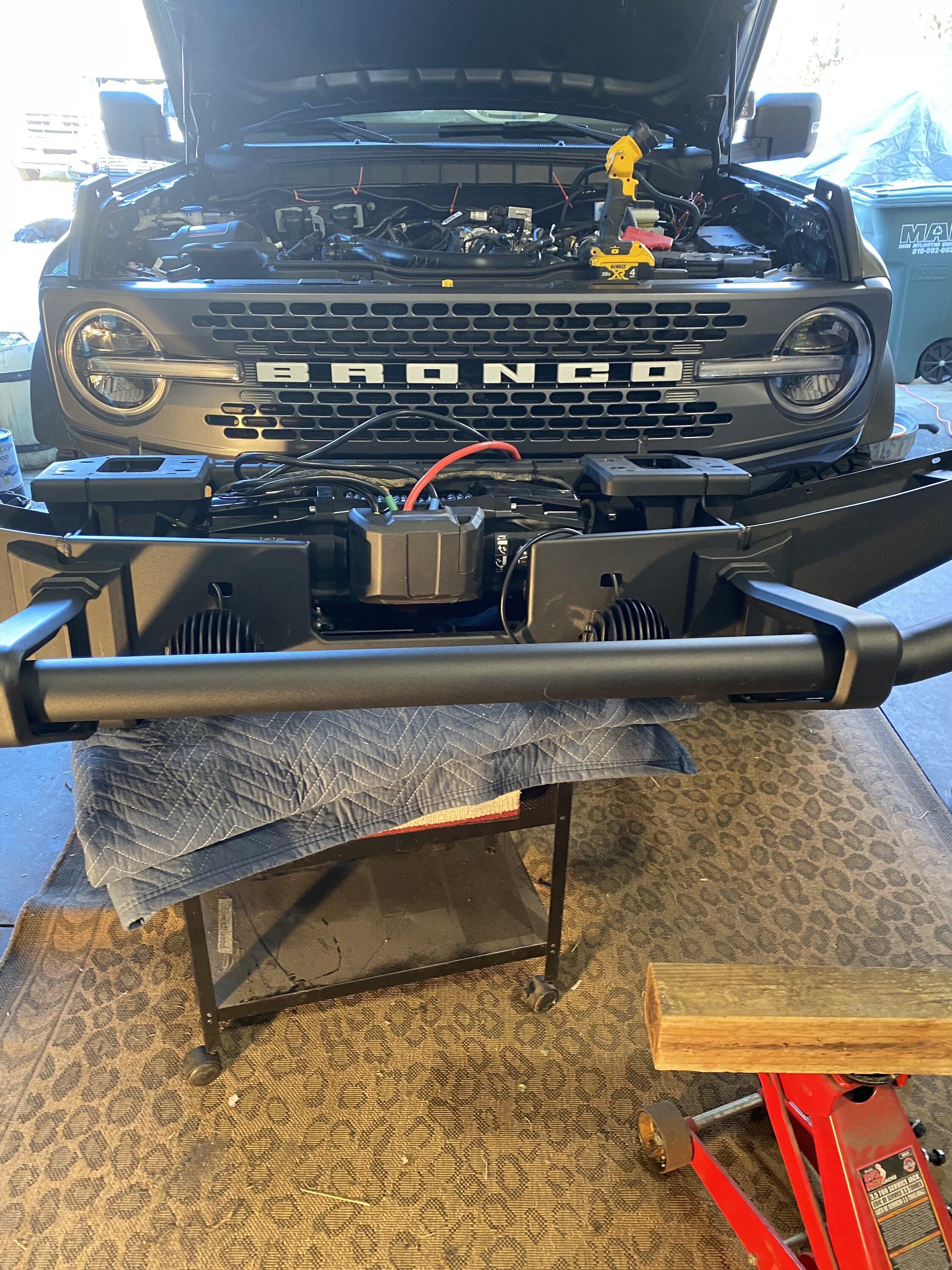

The bumper moves the camera, the radar and all parking sensors. The license plate mount came with it.
Only issue I've had is the camera relocation is for no front plate so you can see the top of the plate on the screen.

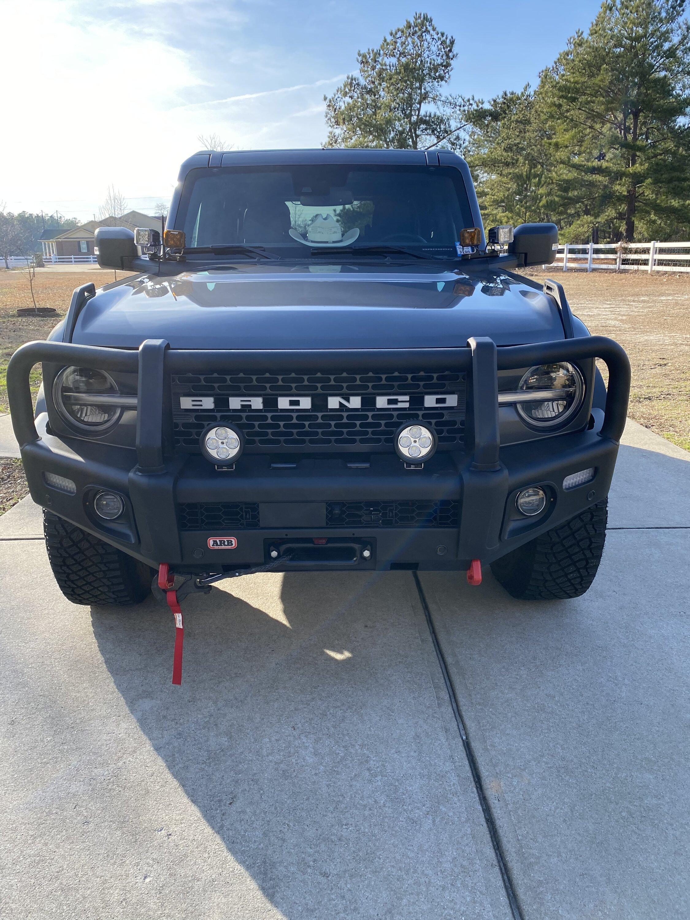

Just finished the install. All lights are operational with the exception of the turns. I did it want to do them. Also rerouted the ACC and added a spacer to the bumper. No crazy issues.

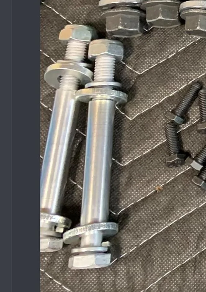

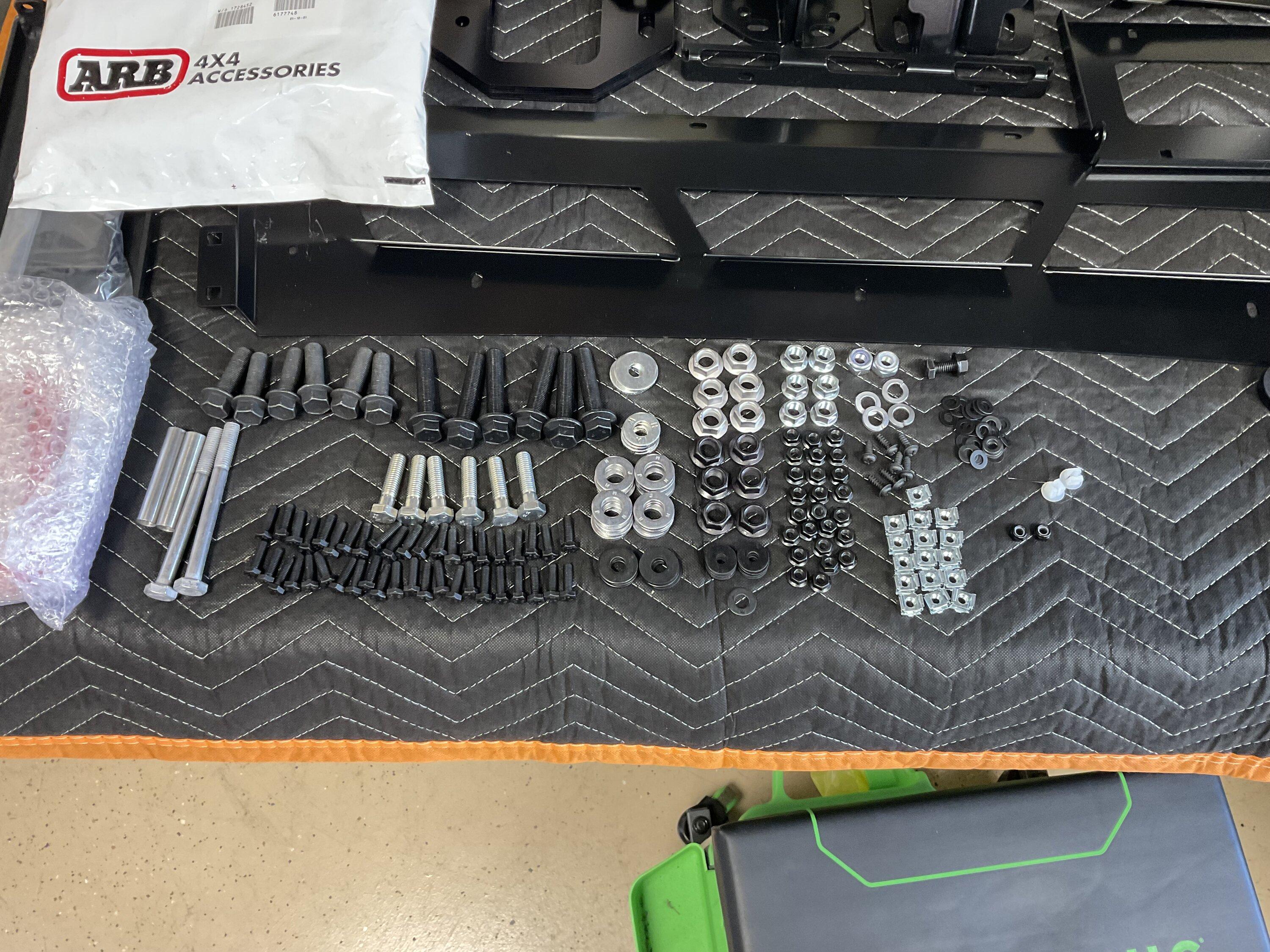

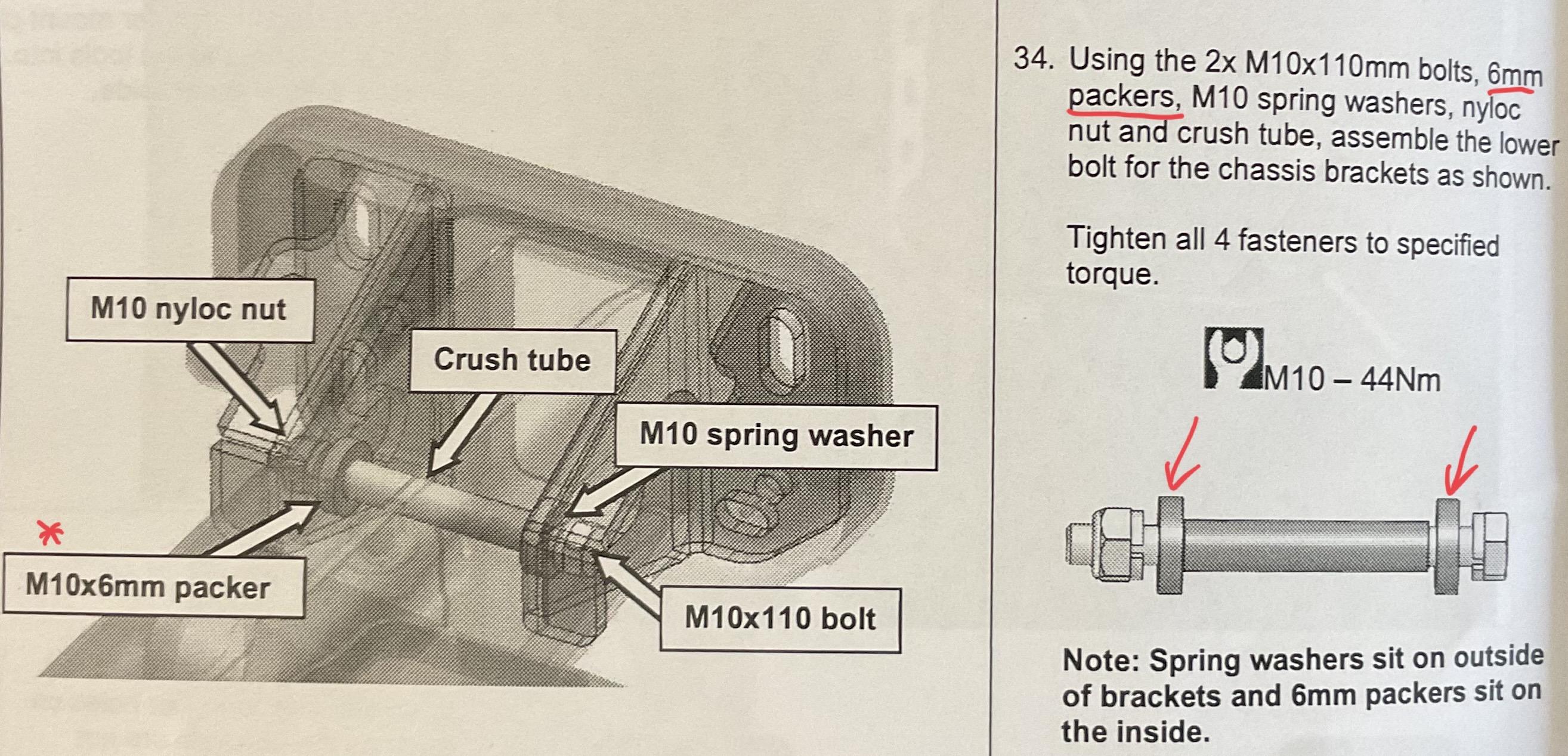

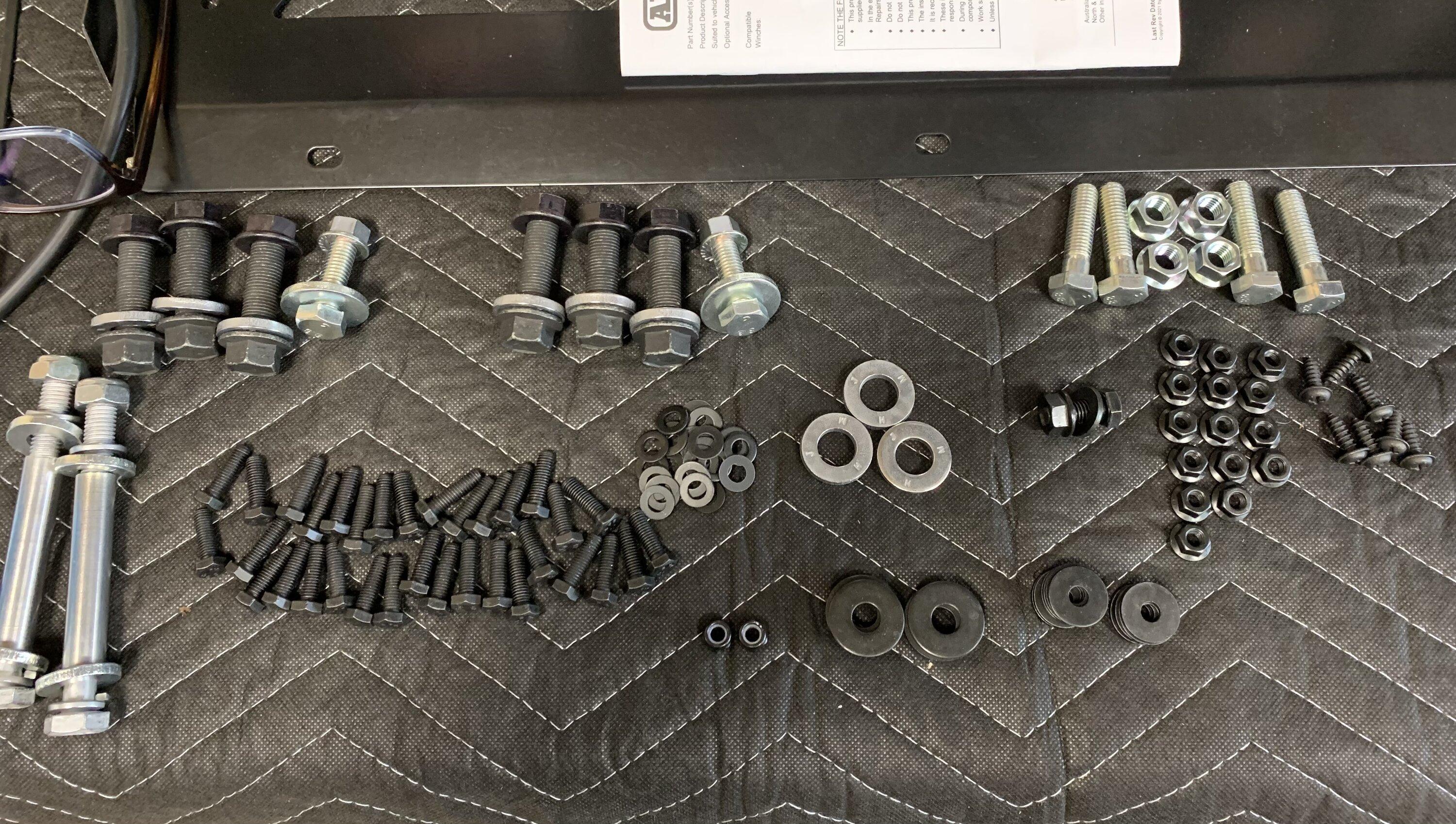

you have everything you need already assembled on the two long bolts. packers are washer like and are metal.Struggling with some hardware. This diagram calls for “packers” and I don’t see anything that would resemble a nylon packer. Any help/thoughts?
