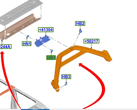

Front N2DZ-78502A74-A Available
Rear N2DZ-7850217-A Backordered
Rear bracket N2DZ-7841304-B Backordered
Front bolts W505496-S450B
Rear bolts/nuts W721872-S450B W721844-S450B W520823-S439
I was able to get the ford brace, any way you would be able to share the part number for the trim that below where the center bracket mounts. They are different on raptor and regular bronco. The raptor has a kick out for where the brackets bolts. Thanks.
N2DZ-7841304-B
W520823-S439 HN1
W710809-S450B HB1

N2DZ-7841304-B
W520823-S439 HN1
W710809-S450B HB1
Flip, thanks for response, I have those pieces, the one I am looking for goes below these, it’s a 3’ x 1’ piece of plastic trim that covers this bracket and the rear air bags. Any assistance would be appreciated, thanks.
I'm at a loss. Maybe get a pic and I'll try to find it in HVBOM from a different VIN. Microcat isn't doing me any good.

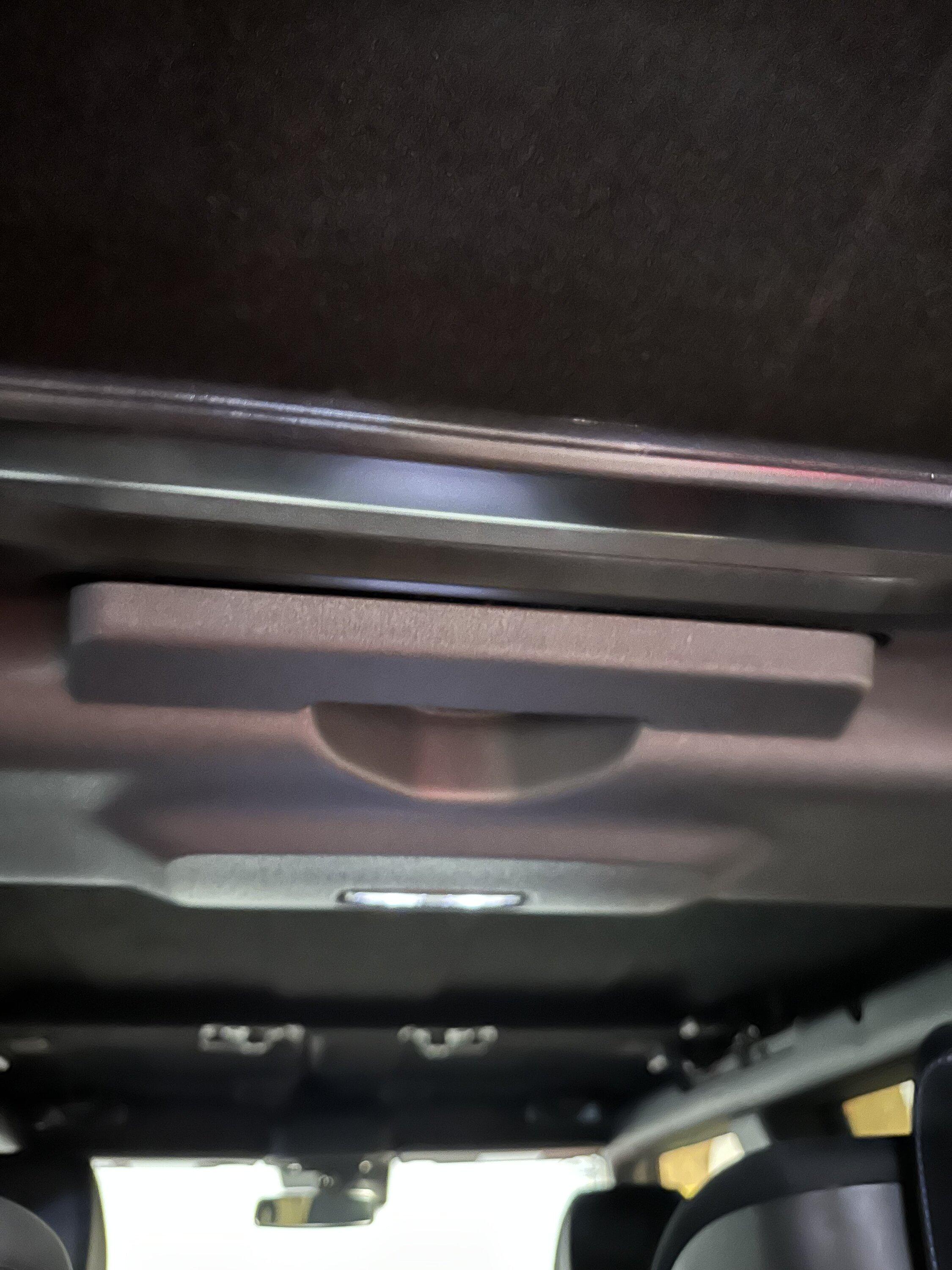

The plastic gray cover with the kickout for the bracket. Mine is not seating right because of bracket

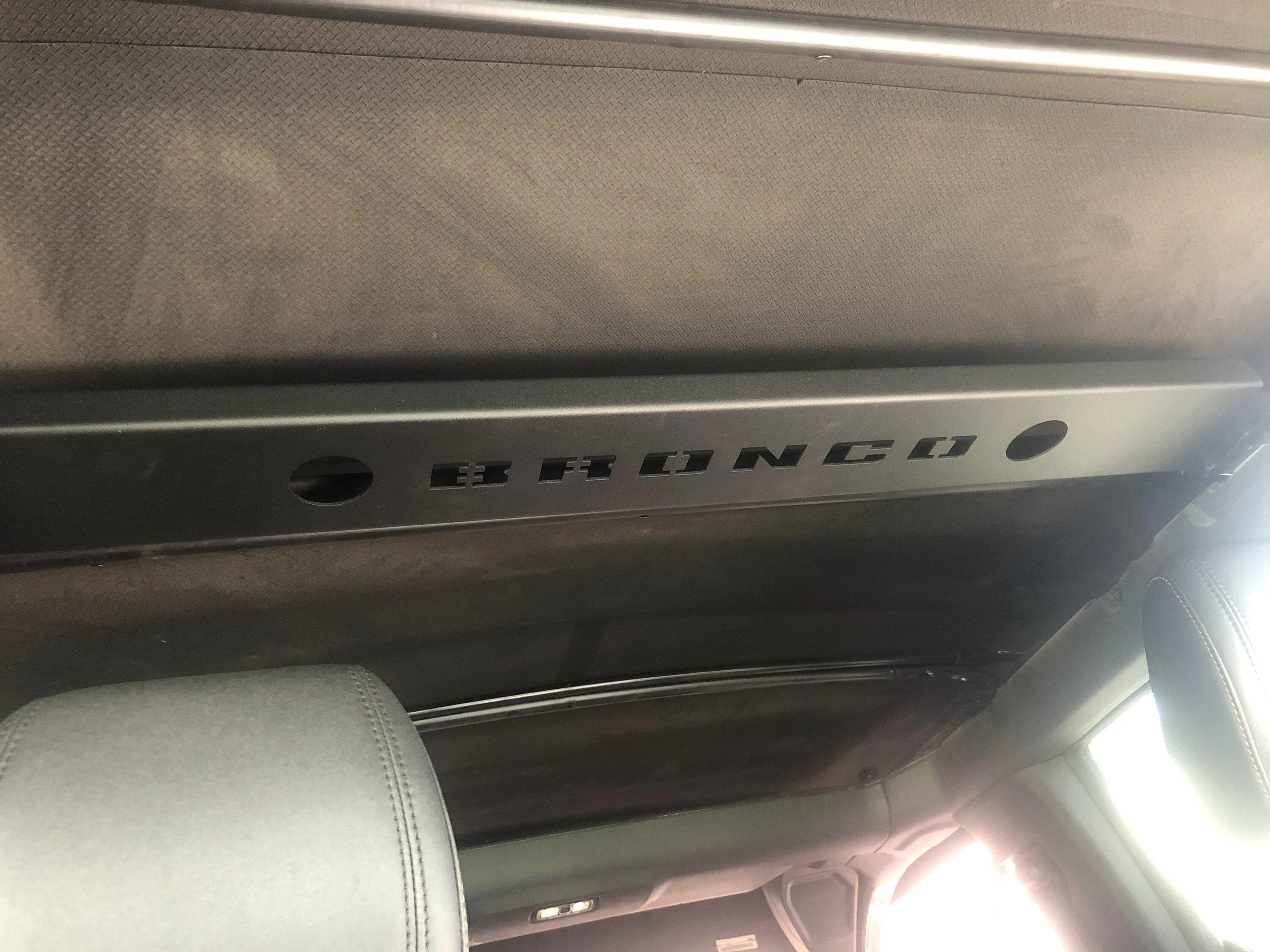

I just built one to fit the soft top, haven’t tried it on a hard top. Definitely tightens up the whole body. Going to put it to test next week in Baja. If I am happy with the improvements may start to sell them. Great place to install interior lights also. I think ford wants over $2k for factory.
Any updated feedback with the use of this? Any noticeable difference? Curious if it helps with the panels from squeaking.
