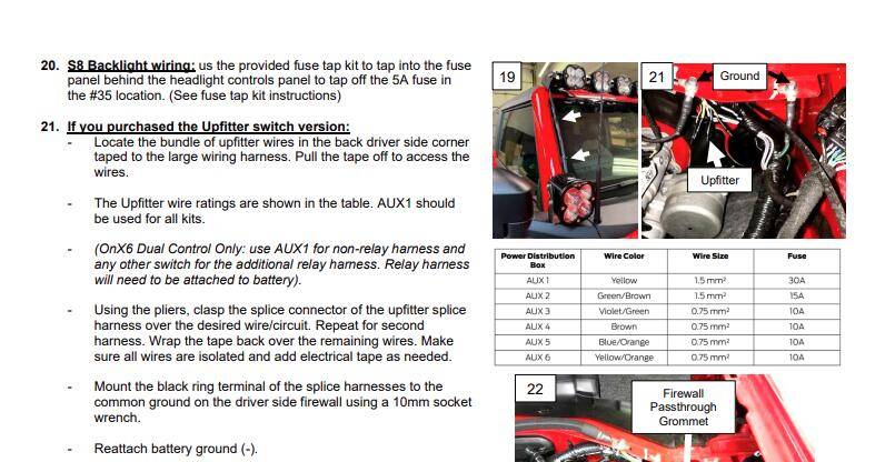

I’m assuming Ford did their litigation homework to determine they’re protected but running anywhere close to 30 amps on any more than a couple feet of 16awg wire (~1.5mm) seems sketchy.
Even though all of the stuff I’m running via the switches are within the stated amperage I still have a few of the switches run to an additional relay and heavy duty wiring

This has bothered me for quite some time. I have a Baja Designs XL Roof Light Kit that draws 16 amps. I used the AUX 1 switch to power the right-hand visor non-powered circuit and used that to connect the roof light kit. The wiring on behind each BD light gets VERY warm. I ran it for 10+ mins to see if I could get the fuse to blow or wiring to get excessively warm/ hot. It hasn't failed yet but it definitely raised a concern.
Anyone else have experience with the BD XL Roof Light Kit or the non-powered circuit at the right visor mirror?
It will be recommended to power it directly to the Aux switch wires and not the roof circuit.
Ford Bronco AUX Switch Amperage - Increase? 1734478247843-y
