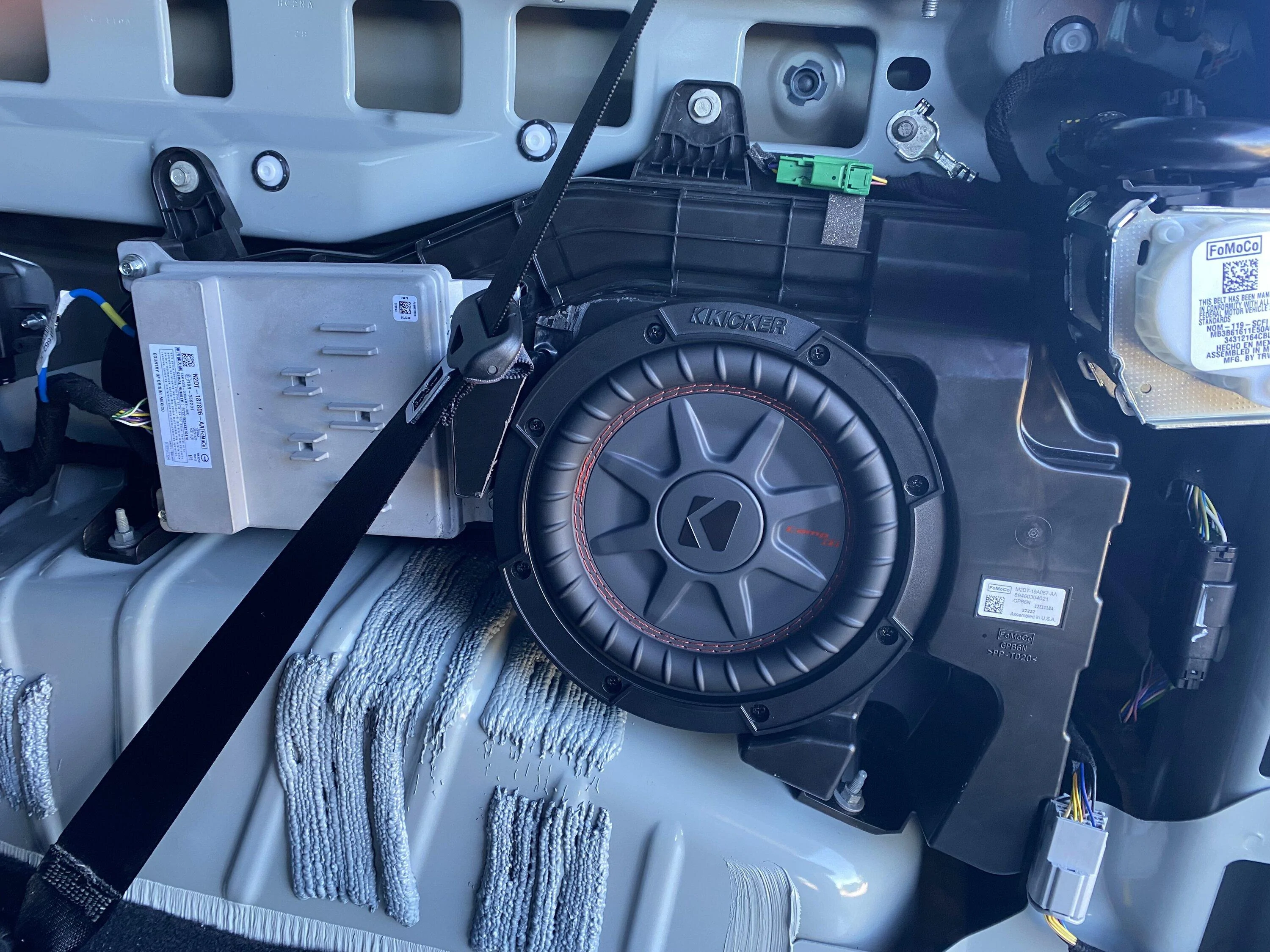

I have done similar as you so far.
I replaced the Factory B&O Speakers with the Kicker KSC series speakers front and rear in my 2-door. I have also installed the Kicker 48CWRT82 8" Subwoofer in the factory Sub Box. I am getting additional Bass response compared to stock, but I will add an AudioControl ACM-1.300 Amp to drive it.
I ordered the Kicker KSC speakers from Crutchfield and went with the recommended speakers for the Bronco. They included wire adaptors and Kick panel speaker adaptors as well. Complete drop in, easy replacement.
The B&O system is about 20-25 per watts per channel depending on who you talk to.
I will add the AudioControl ACM-4.300 for the other speakers at some point and an Axxess Matrix with DSP for a Plug-n-play system. (removing the Factory Amp Pictured)
