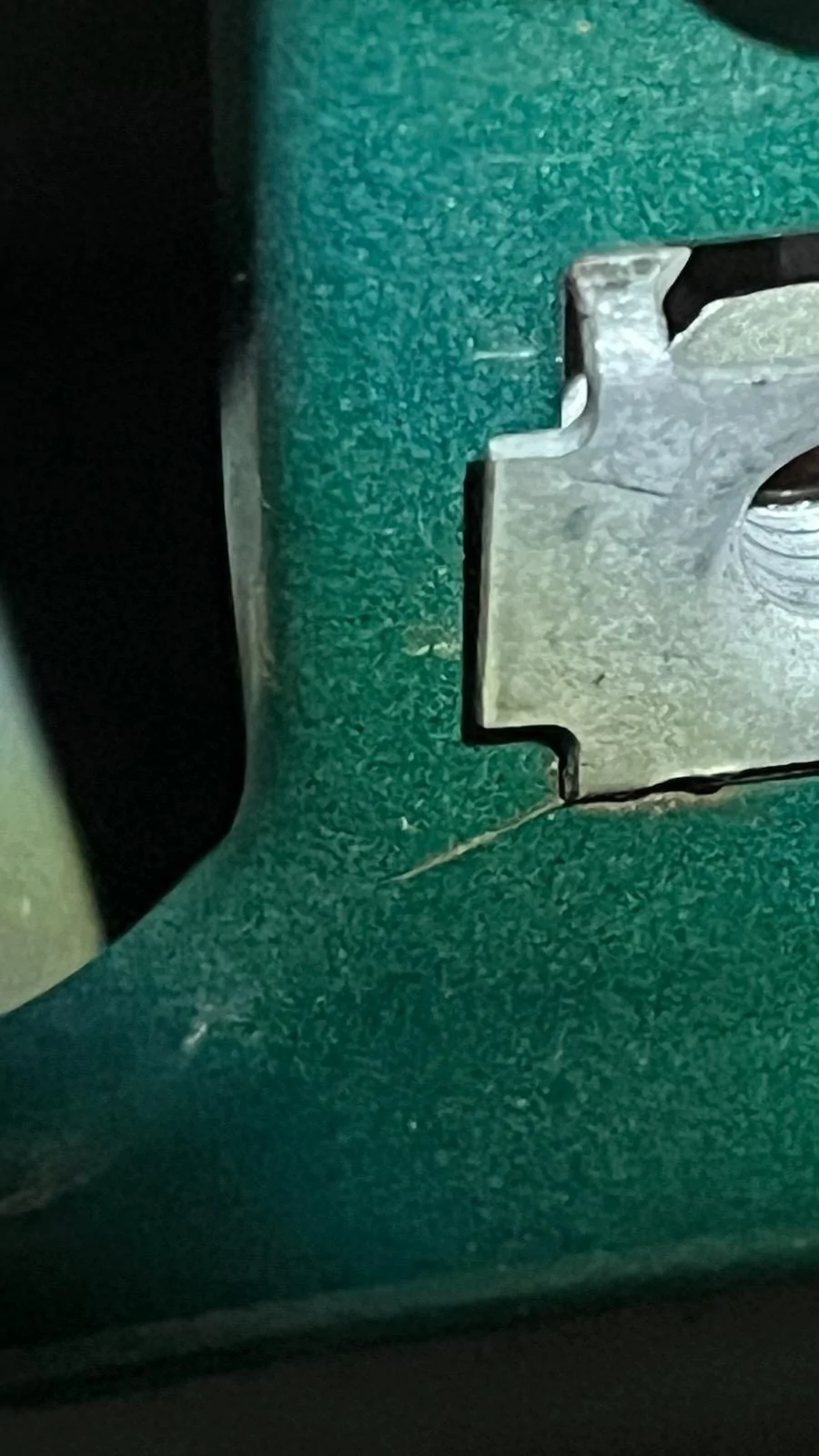

Been in the shop for tech/software/stereo issues 4 times now.
This latest one....I'm at a lose.
B&O subwoofer has been absolutely buzzing, rattling, popping crazy bad for the past month.
Tossed the keys to my service writer and said lets bring it in again.
There was somewhat of a fix. The bracket plugs for the sub are tiny and they snap. All of my plugs were completely split in half. My mechanic replaced them with...well bigger plugs from Ford.
Ok, cool.

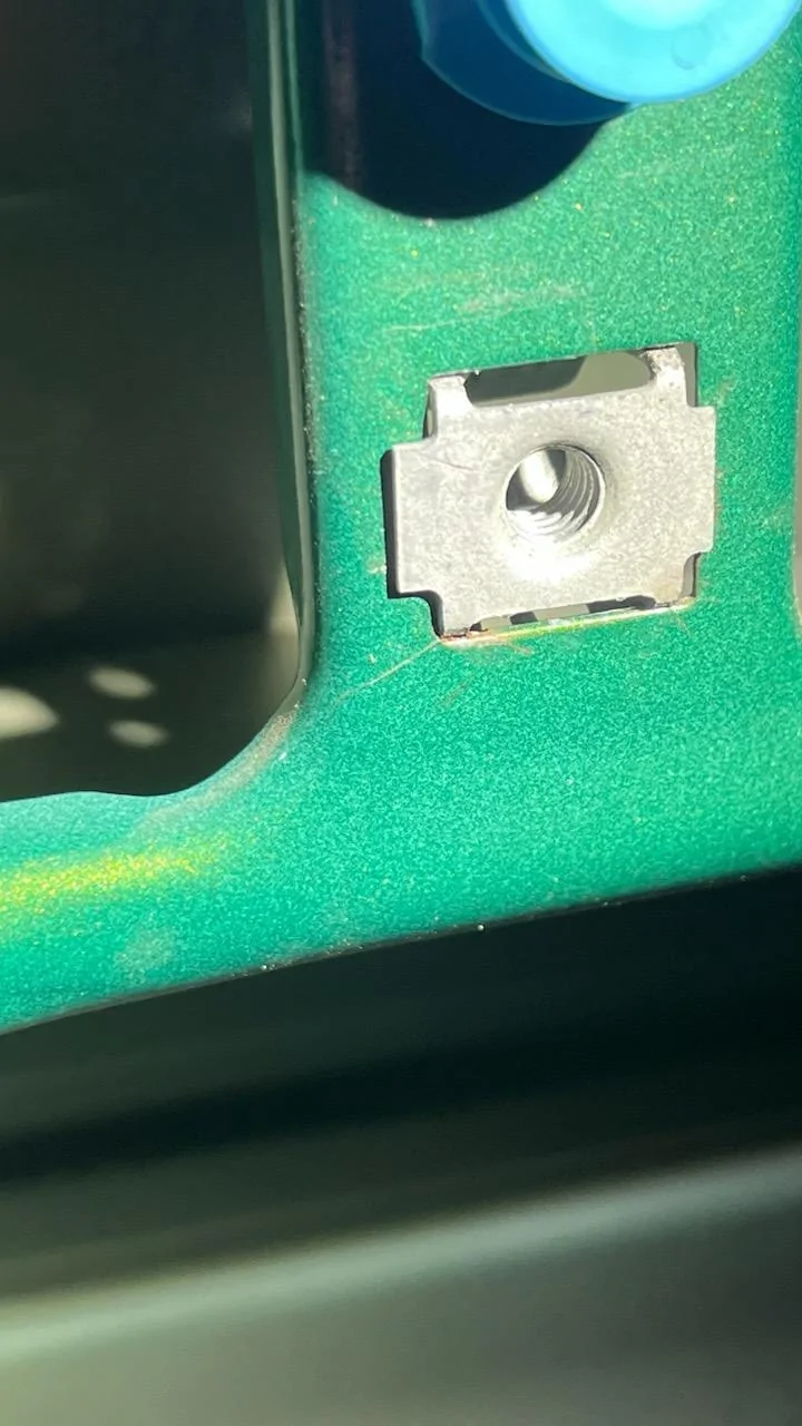

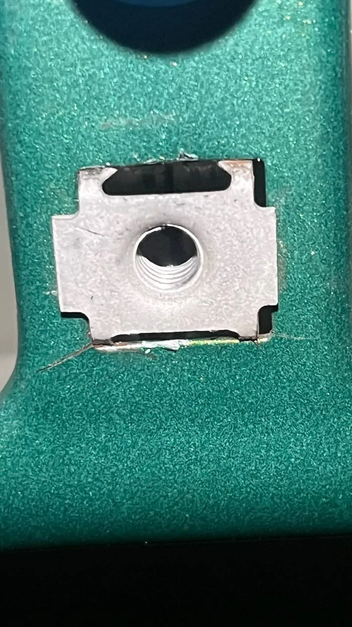

Now here is where it gets funky.....the interior "Painted" body behind the sub where main bolt mounts and has completely tore through the body. Metal body, paint and all. Both side of the hole(see picture).
He said this is the second one he's found. (He showed me pictures of that one as well)That he had actually just the prior week seen it happen on a customers Bronco.
The only fix.....felt tape.....felt tape.
Just to help the sub not rattle as much. Still rattles bad.
Mechanic contacted "Hotline" they finally got back saying that there is no fix. They don't know why, and that there is no way the subwoofer would have caused the body to split. Even though its where its mounted.:unsure:
Come on....all the plugs split, now all the weight of the sub is on one main top bolt in this floating bracket. The customer doesn't know and it tears through.
The actual fix....and only possible fix according to my mechanics is to actually reweld the body....ya

I wonder if they had some damaged tooling at the plant. The closeup image of the knockout appears as though it was munged in the same corner as the stress crack.
It's split through on both lower corners.
