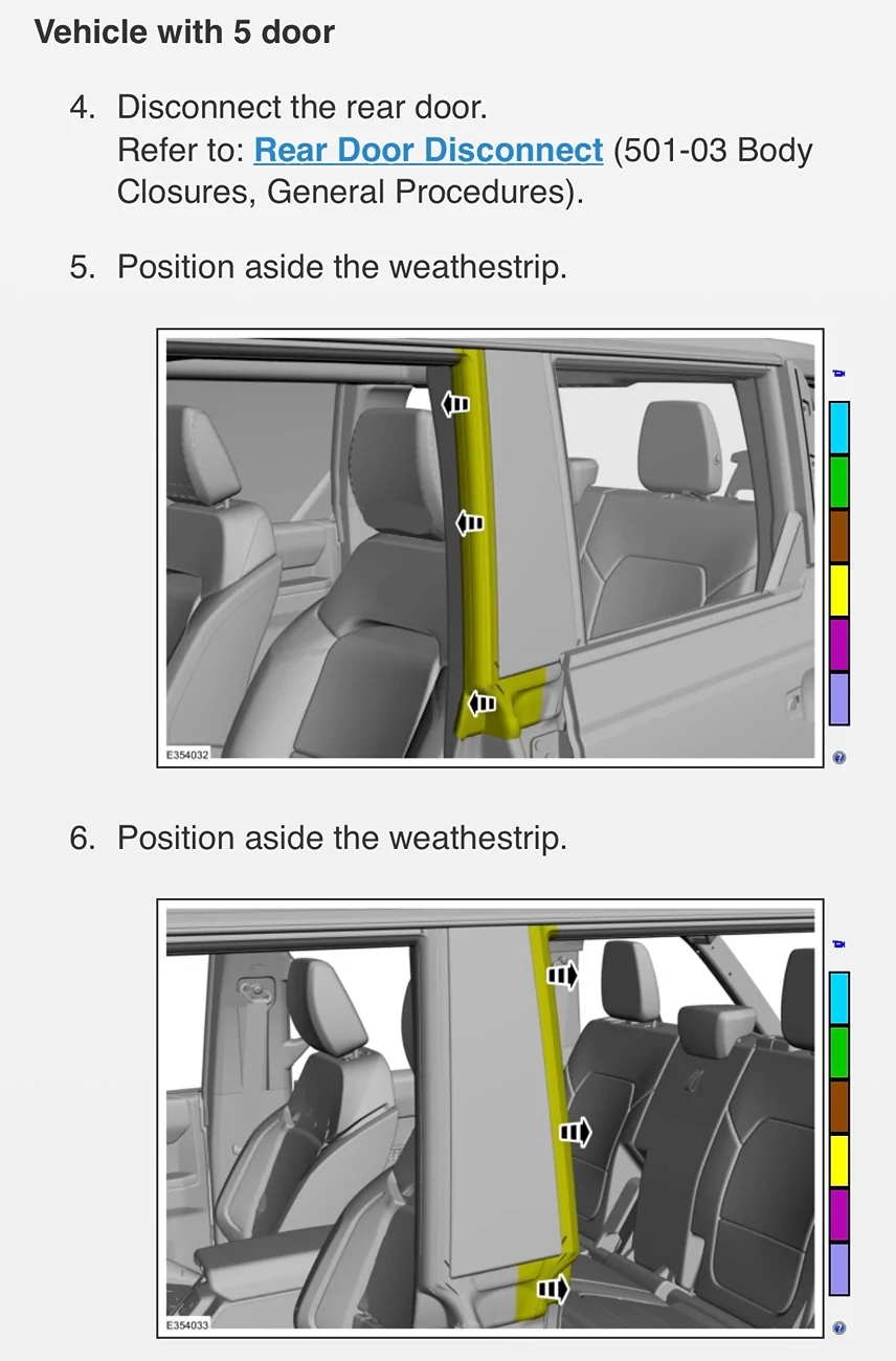

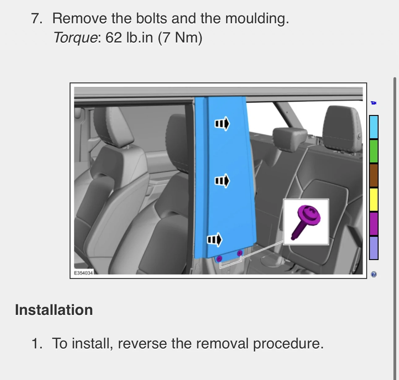

Anyone have part numbers for the B pillar plastic. Need to replace one of mine due to discoloration
