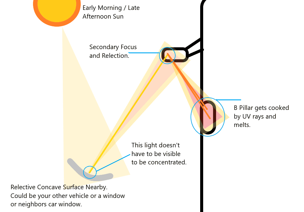

I suspect it's happening when sunlight is being concentrated into your mirror and then the mirror is compounding it back onto your B Pillar.
I suspect that a window from a neighbor or a neighbors mirror is channeling the light there. Early morning or late afternoon would be my guess.

Here, I made this illustration to explain my previous post. Enjoy!
Ford Bronco B Pillar plastic issue MeltyB
The curve in the reflected surface doesn't even have to be pronounced, just has to be the right distance from your mirror to make the mirror a focal point.

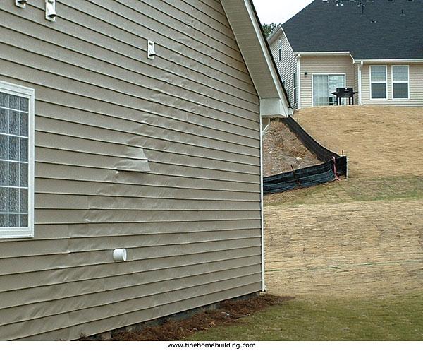

I bet it’s from solar reflection from low E glass windows. I had my composite fence replaced twice due to reflection of the sun off the windows.
(Here’s an example of what I can do in the photo)
Death ray its science 👍
