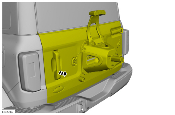

  1. Open the tailgate.

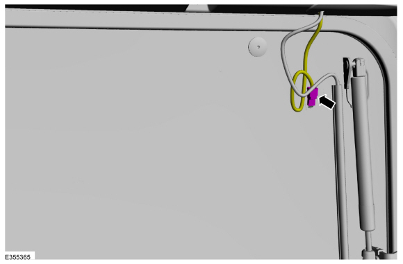

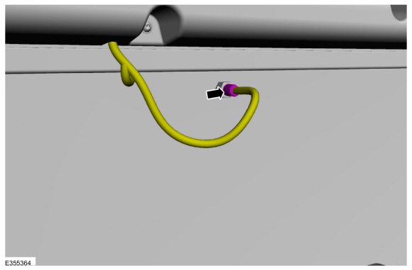

  1. NOTE: Liftgate shown closed for clarity.
    NOTE: Left hand (LH) shown, right hand (RH) similar.
    On both sides.
    Disconnect the heated rear window element electrical connectors.

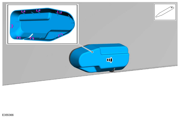

  1. Remove the rear window wiper motor cover.
    Use the General Equipment: Interior Trim Remover

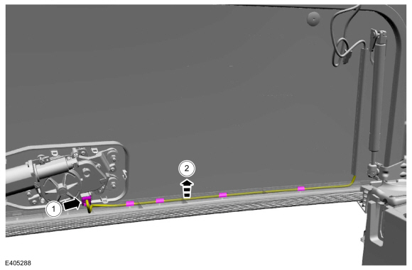

      Disconnect the rear window wiper motor electrical connector.
    1. Release the retainers and position the rear window wiper motor wiring harness aside.

Consider using a conductive epoxy for the repair. It's readily available from auto parts stores, often sold as a defroster repair adhesive.
BroncoAdventure
Mar 19, 2024
155
155
Alabama
'24 Bronco 4 Door
Thanks for that. Will look for some today.
