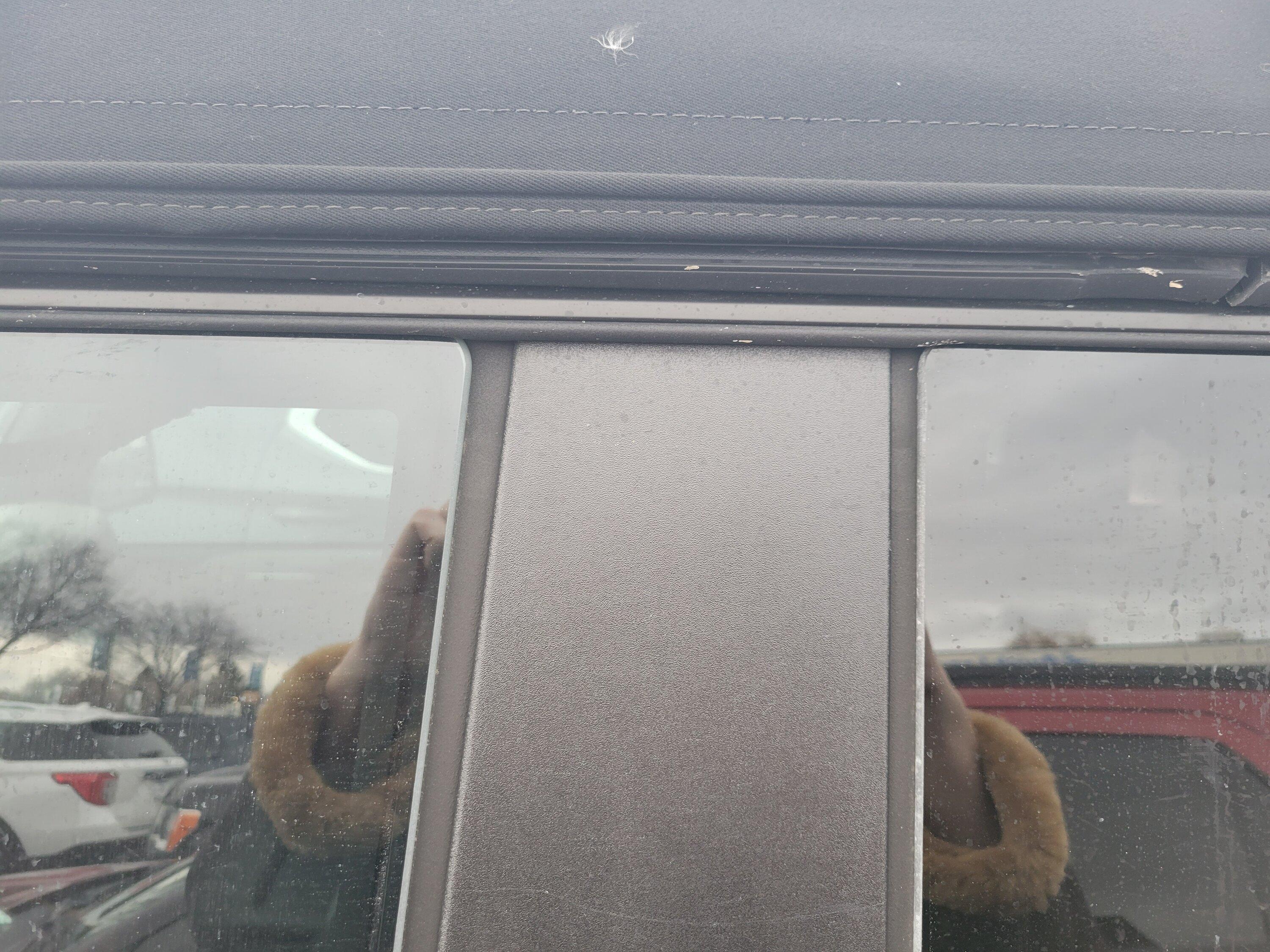

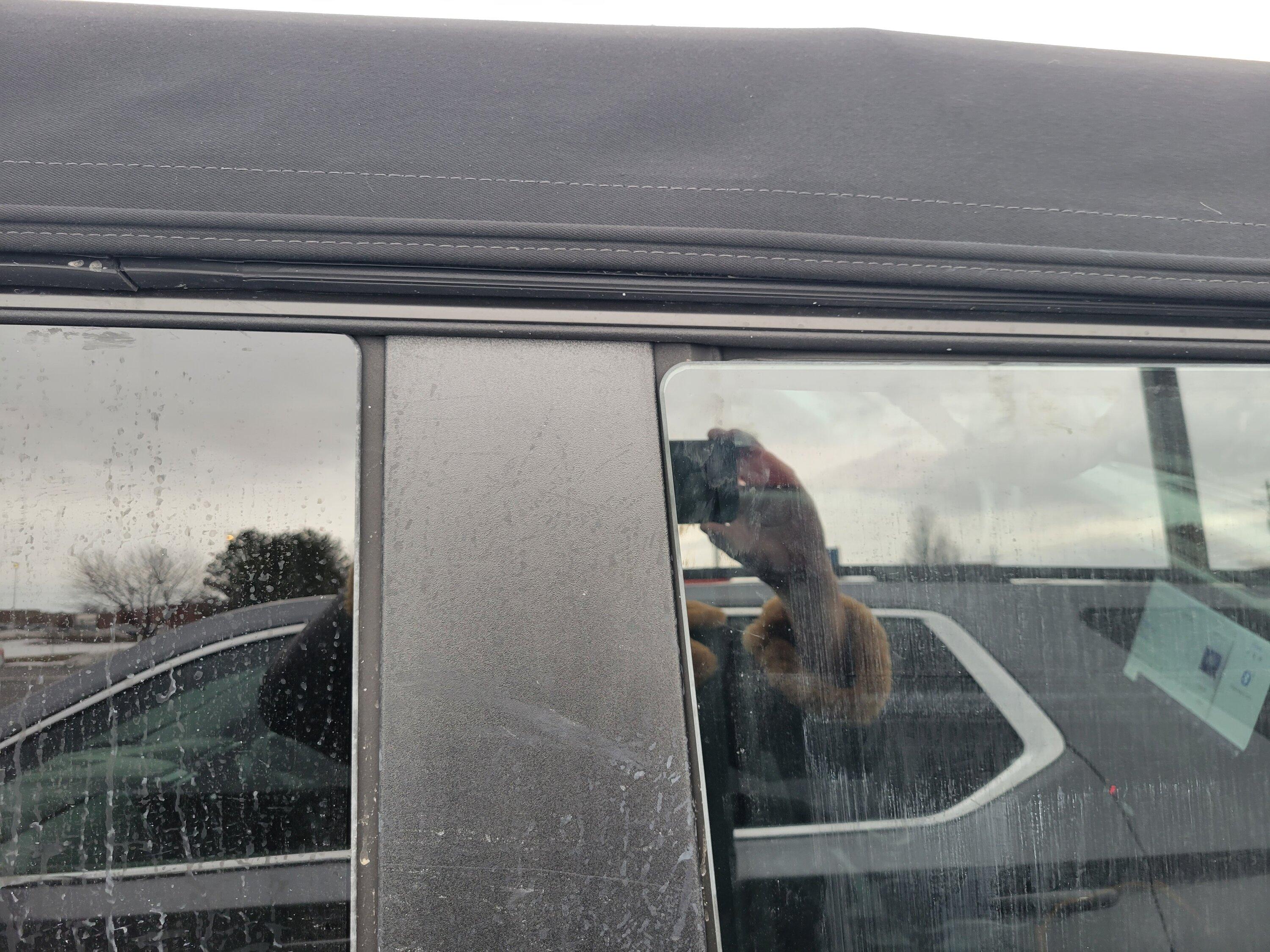

I have a 2023 badlands with 1500 miles. We were driving down the freeway and suddenly the cabin got substantially noisier ( I have a soft top). Turns out the passanger side front window collapsed slightly and wouldn't roll up any further. The dealer told me the window regulator failed. Now waiting on Detroit to send the parts. First picture shows the failed window. Second shows other side for comparison. You can see daylight between window and top from inside. ( good thing it's not the worst winter in 40 years here)

I did not. I don't know what the dealer tried. I know I can grab the widow and pull it up and then it just falls back down. I wouldn't know how to reset it
